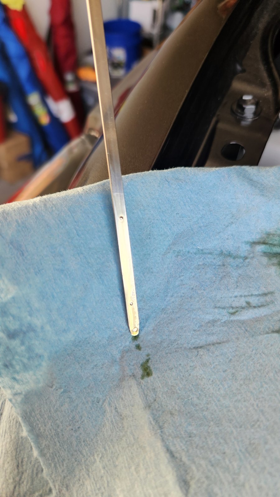

    So I checked my brand new Taco a few times, and the oil on the dip stick measures like 1/4 over the max line/dot.
    Is this deliberate ?

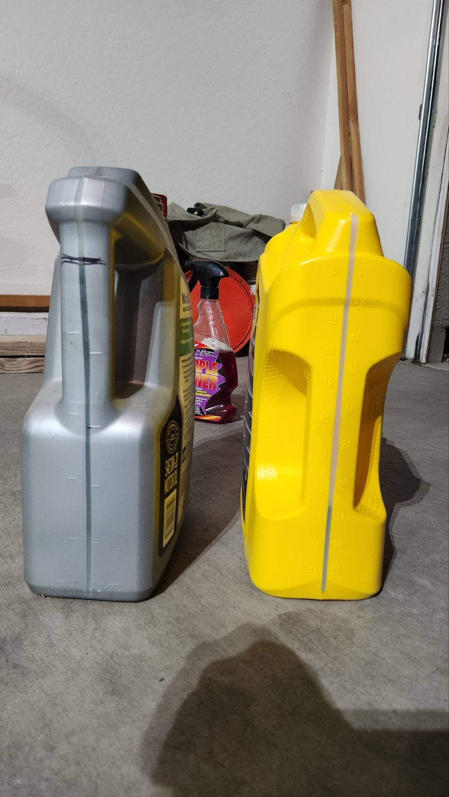

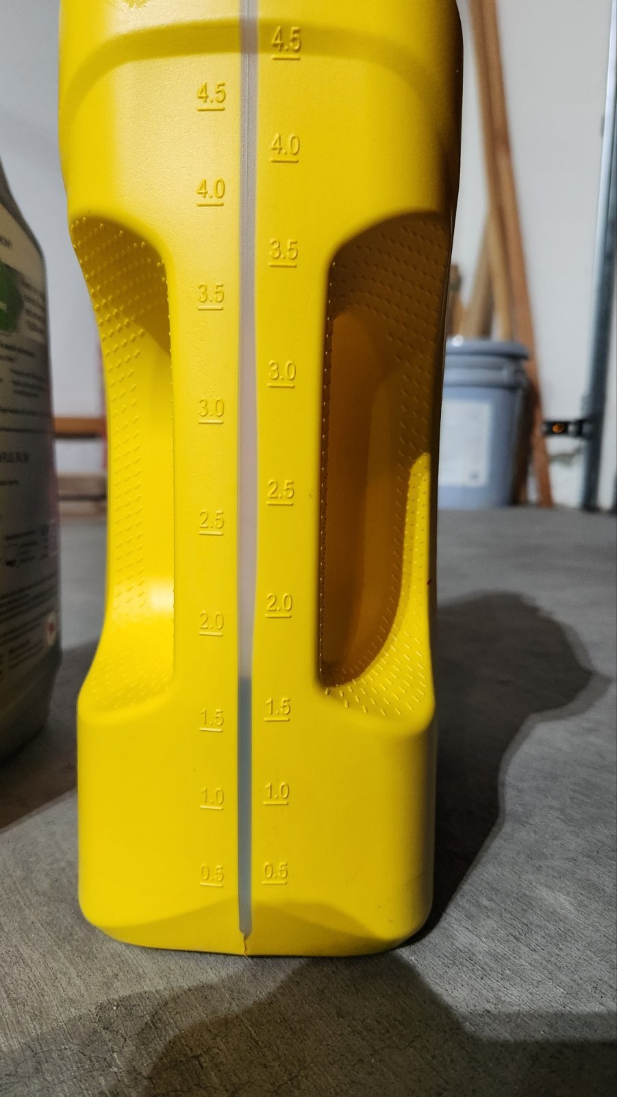

    Edit 10/10/2023
    I just drained and changed oil/oil filter on my Taco @500 miles (because of my OCD) !
    I was right, this thing was overfilled from factory!
    I measured 6.7 to 6.8 qts., excluding the oil that got spilled, and the remaining oil from the oil catch I used.
    Is this why the engine was vibrating so much before I drained it, now it's calm

  2. Sep 18, 2023 at 8:26 PM
    Bishop84
    Bishop84 Well-Known Member
    Dec 17, 2015
    #172494
    11,870
    Check after running and waiting 5 minutes. Any longer and the drain down will show over filled, especially overnight

    The truck sitting level? Not pitched towards the engine?

  5. Sep 19, 2023 at 4:11 PM
    joeyv141
    joeyv141 Well-Known Member
    Jan 31, 2016
    #176710
    1,905
    New Jersey
    08 DCLB 4x4 V6 TRD Sport
    1/4 means 1/4 inch right? Toyota dipsticks are horrid for measuring the oil level, I recommend scratching the correct area with a file or course sandpaper, heck I just did a camry oil change today and after putting the 5.2q in it looked like it had oil halfway up the dipstick.
  6. Sep 19, 2023 at 4:16 PM
    Superdave1.0
    Superdave1.0 Grandma Dave
    Dec 27, 2018
    #277158
    6,220
    SoCal
    LX470, 2025 Civic Si
    Flip the dipstick over. Sometimes one side will read higher than the other. The lower one is typically your actual reading.

  7. Sep 19, 2023 at 4:22 PM
    Junkhead
    Junkhead TRDude
    Feb 27, 2019
    #284671
    15,676
    Serge
    Prince George, BC
    Black 4x4 Sport MT 2018
    Some Serious Tires
    Interesting. From my experience, I get the clearest reading once it sits overnight. It’s a very distinctive line but usually only on one side of the dipstick.
