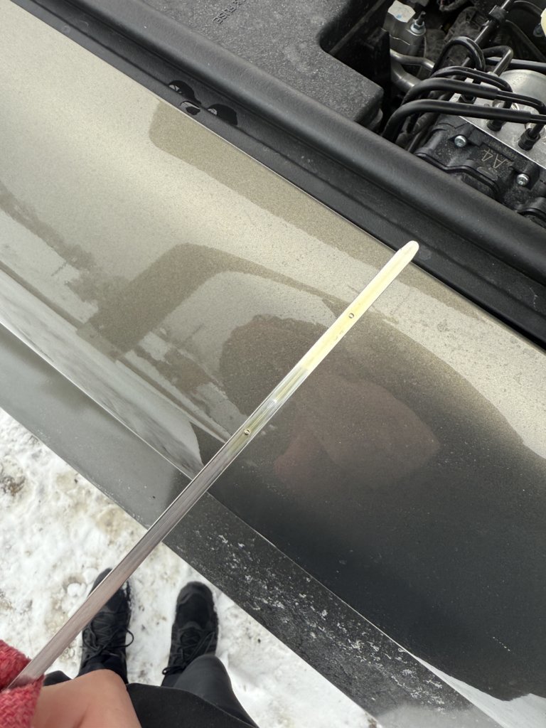

    So I went to a quick lube today (I know, probably my fault in the first place) because its super cold out and will continue to be for weeks, also my apartment complex doesn't allow oil changes on property. They put in 6.25 quarts of oil and when I got home I checked and verified the oil level on dipstick after the truck sat for about 10-15 minutes and its just above the full mark. Do I have something to be worried about or should this be fine? Also before anyone says anything, I am at 2,033 miles currently, around 1,200 miles I attempted to get my oil changed at my local Toyota dealer and they wouldn't do the oil change until 10,000 miles. I wanted an earlier oil change than that.

    Just above the full mark, while hot, is not a problem.

    Don't worry about it. If you really want you could drain a very small amount of oil so it would be in the middle of the dots but in reality anywhere between the two dots are good, very slightly above the high mark is also fine.
    Edit - Also tacoma dipsticks are usually rather rubbish at accurately showing the level.

    I’ve heard that with the research I’ve done before this post, lots of complaints about the dipsticks. So I’m sure the dipstick may make it look worse than it is. And I know that in reality I’m only over maybe .25-.35 of a quart but just wasn’t sure how big of a deal that was

    I do not know what the 4th gen dipstick end is like but on my 2nd gen I took a thin dremel disk and cut very slight notches on one side between the high and low points, its a lot easier to correctly read the oil level.

    I've heard about using some sandpaper to get rid of the smooth finish and just clean it really well afterwards.

    I tried that, it make it better but not great on my previouse tacoma so I went the more extreme route with my current one
