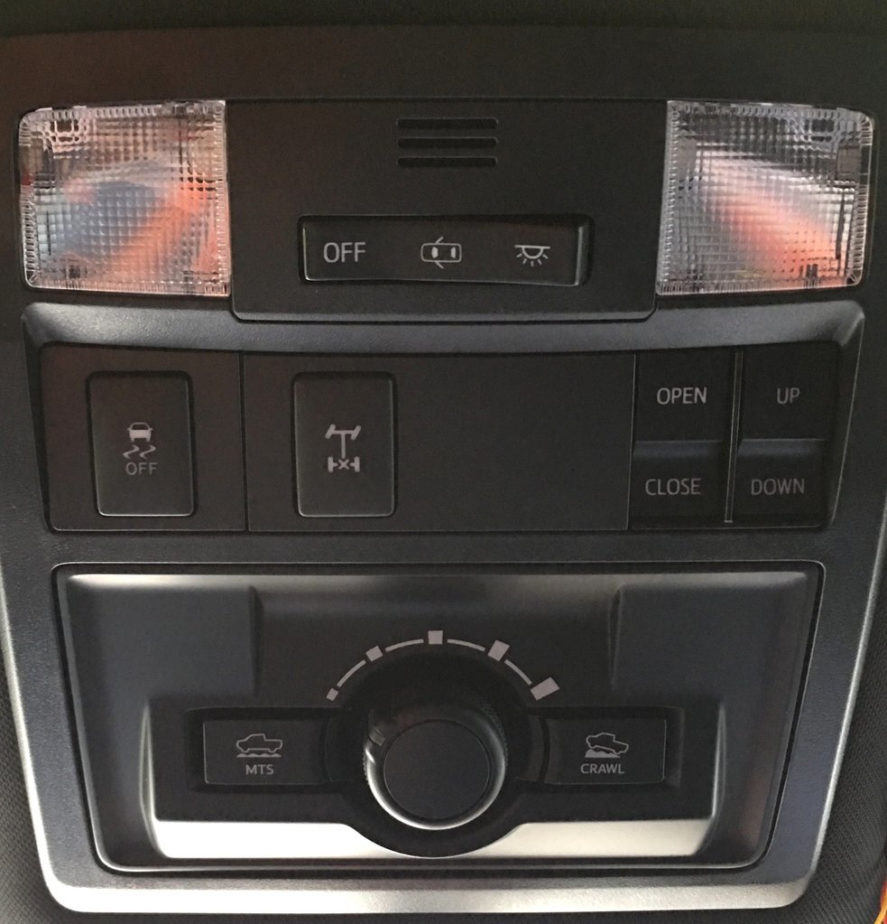

    I have searched the gen-3 forums but have not found the answer to my question yet:
    Has anyone whom owns a gen-3 Off-Road removed & re-installed the cabin headliner console with all the controls. I included a picture below for reference. Any assistance would be greatly appreciated

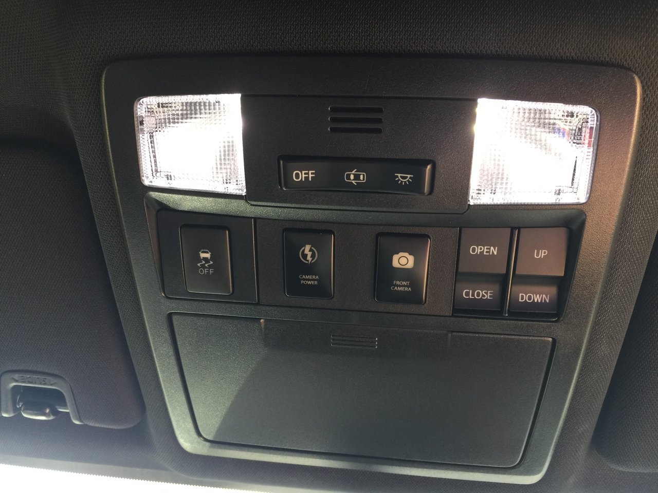

    it should be the same as the other models not only the OR. there are no screws holding it in, you just need to stick your fingers between the console and roof liner and pull it down with some force, but it will come free. I have removed and installed mine on my Sport many a times. there are 4 red clips in the middle and the edges has smaller tabs to keep it snug to the headliner.
    Some pics to help:

    Installing my dash cam and tapping mirror power, installing switches for my front camera and any time on rear cam to name a few.

    Cool! I just got my custom switches in and the center mounting bracket i got from a seller here on TW. Nothing is wired yet since its an ongoing project and i am waiting to buy another harness to complete this build but I wanted to see how everything would look all together.
