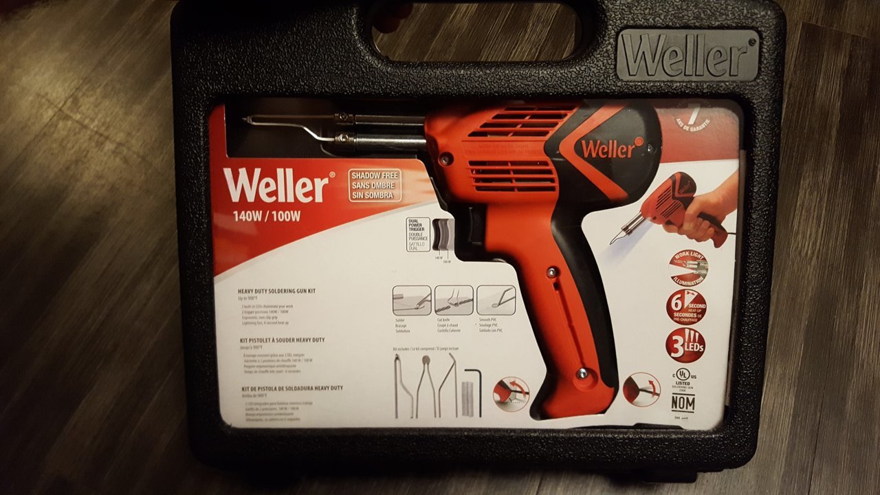

  11. Feb 4, 2019 at 2:19 PM
    #2111
    ChadsPride
    Nov 26, 2014
    #143119
    127,312
    Sponsored by TacomaWorld.com
    Ordering these tonight :)
    Unless you have a spare one you could envelope to me :oops:
    This is what I ended up with.

  13. Feb 4, 2019 at 2:40 PM
    #2113
    Muddinfun
    Muddinfun Well-Known Member
    Apr 17, 2017
    #216500
    7,489
    Uh, no. However, that is the soldering gun type that you use for soldering wires together on your truck.

  14. Feb 4, 2019 at 3:00 PM
    #2114
    ChadsPride
    Nov 26, 2014
    #143119
    127,312
    Going to return it and get that kit he suggests. I should really read sometimes
    Siliconmethod likes this.
  15. Feb 4, 2019 at 4:29 PM
    #2115
    Siliconmethod
    Siliconmethod Well-Known Member
    Jan 11, 2011
    #49112
    78
    Greg
    MO
    Ha, yep....I highly recommend getting a pencil style iron, you will have a very difficult time with the pistol grip. As Muddinfun said above, that type of iron is for non-electronic type of work...connecting wires, craft soldering, etc. The tips are usually too large for fine work, and you don't have as much control.
