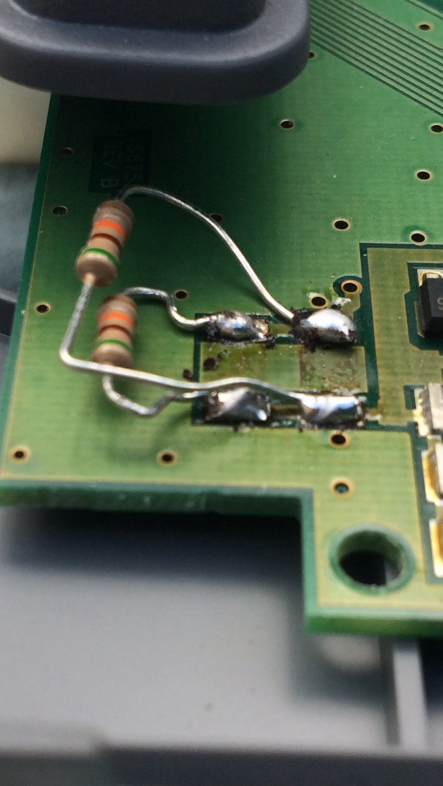

    This picture will prove that even bad soldering and bad trimming, this will still Work!!!
    And i'll add that this may have been try #2. It took #3 to get the correct resistors... 51 Ohm, 510 Ohm, 5 Ohm.... it does make a difference! Oi!!!!

    Ok thank you for the pic! I see why it's like that now. Because the width of the resistor I believe.
    Looks like I'm in for a good time!
