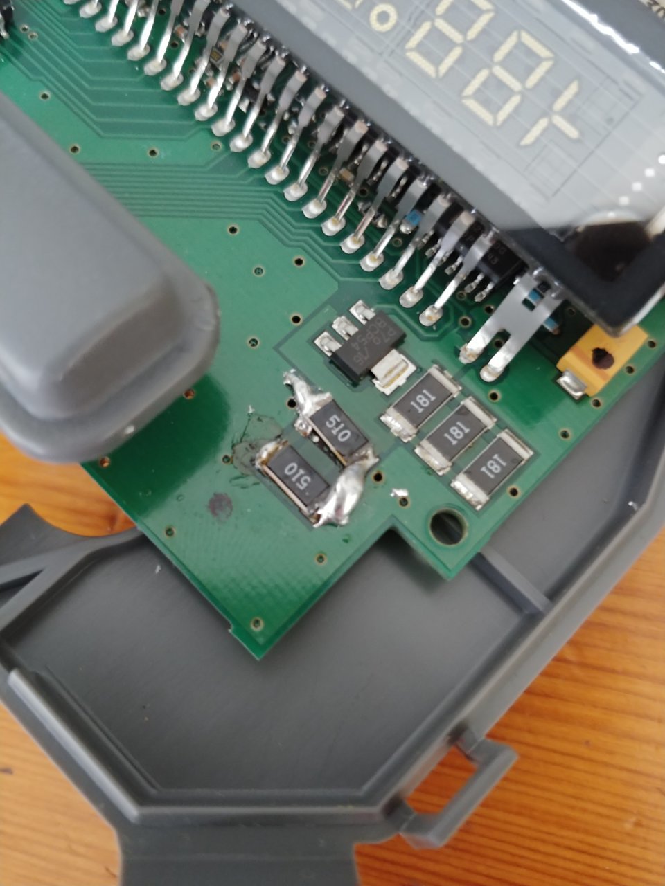

    Just did this a couple weekends ago after purchasing a truck without a working compass/temp. Fixed it up like new despite my lack of solder skills.

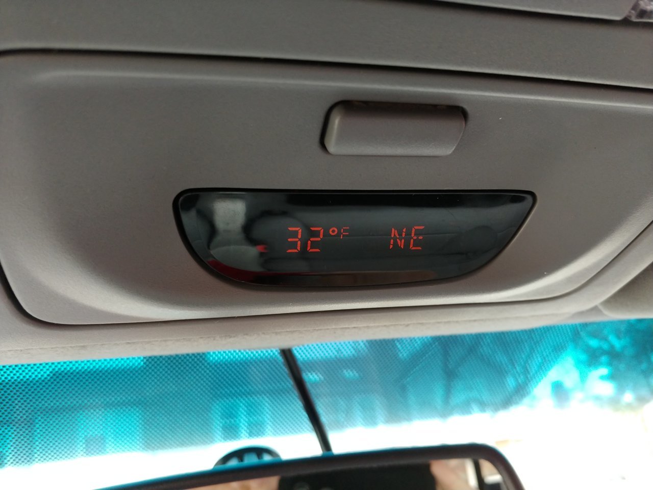

    Yeah, I honestly didn't think the solution would be this easy. Solder. Mine didn't even look busted, but that's all it took.

    This worked wonders! I've had my truck for 2 years and didn't know it was this easy of a fix. Soldering came out fine with no prior experience using it. Thanks OP!

    This fixed mine. Thanks!! :thumbsup::yes:

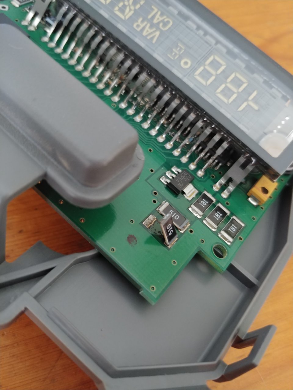

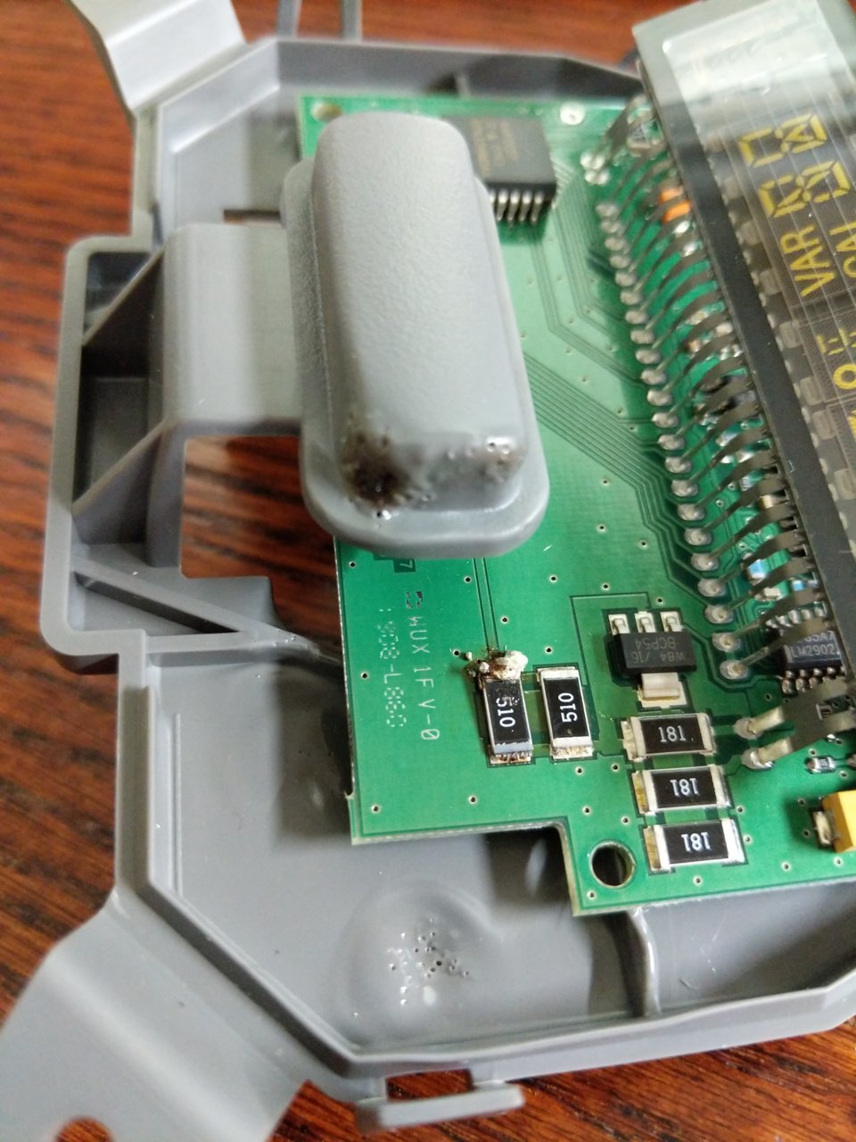

    Ok, so, it looks like a PO may have fixed this previously.....but also, look at that melted plastic! Looks like the screen also has some heat damage. I did this fix on one of my older tacoma's, and I don't recall it being this bad.

    Looks like they used a propane torch to solder it. Jeez!

    i have fixed two different ones and seen a scorch mark on the screen of both, a friend did this recently and reported to me about a scorch mark and sent me a pic.... dont sweat it, keep driving
    shit, I just scrolled up a little and look......scorch mark in the corner of screen

    @MyToyTaco ....good grief, I think @Muddinfun is correct about the torch. It appears they used a microtorch to melt the solder and let it dribble onto the board. I guess it could have been worse...
