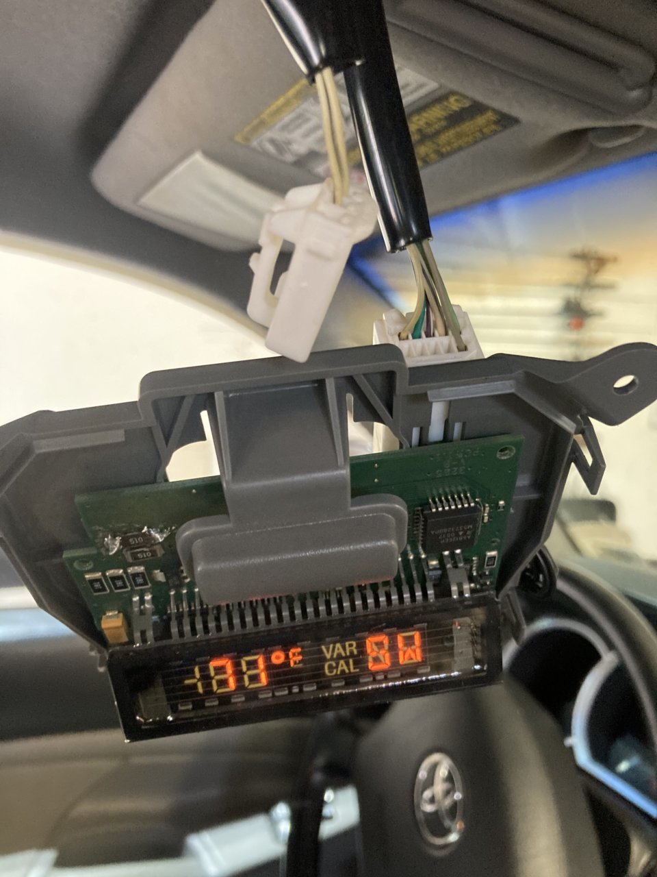

    C07CB117-E35A-4B9D-A436-E80D3D9F8411.jpg Awesome description! Working perfectly!!!
