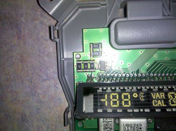

    Indeed they do. I just broke one of mine. Oh well. Mine just has a VERY slight crack in it. Is that enough to make it stop workin? I don't know anything about this sort of thing. I've also got what looks to be a burnt spot on the screen...
    Any ideas what would cause that? Any of you have a spot like that?
  8. Mar 14, 2010 at 2:10 PM
    #408
    coppert
    coppert Mall Krawler
    Apr 12, 2007
    #1300
    922
    Travis
    916
    My glass had that same "burnt" spot in it when I took mine apart. It did not cause any issues, once I repaired the solder joints as documented it has worked perfectly ever since. IIRC when I originally posted pics of my gauge someone made a comment that those burnt looking marks happen when they are sealing the glass?

    Mine when out about 6 mo. ago I just now got around to researching the issue. Sure enough, I pressed on one of the 510 resisters and the display lit up....to cool. Now I just need to go get a fine tipped soldering iron so I can fix it. I just love being able to fix stuff like this instead of buying way over priced replacement parts. BTW, removing the overhead console is a PITA. I feels like it going to break before it flys out and hits you in the face. Now, I just need to figure out how to get at the map light bulbs.....I like to know in case one goes out. The way the clear covers or attached can be seen from the back side and look very fragile.

    The "burnt spot" is normal. The display is a vacuum tube. Vacuum tubes use "getters" to absorb residual gasses in the display.
    There is nothing wrong. It is a normal part of the display.
