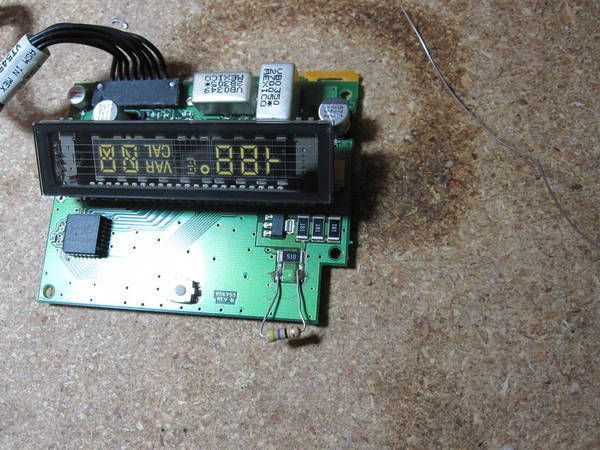

    Mine just went out again...this is like the 5th time since i've owned the truck...god damn its getting annoying...I don't know why the solder won't hold...oh well, at least its a easy fix :cool:

    I noticed when I pluged it in before reinstalling the cover that this resistor gets very hot...I almost wonder if it is the right value? I put a very healthy "glob" of soilder on mine without spilling out on the rest of the board and haven't had to dig back into it yet...

    Good point about the resistor being the right value.
    As I posted earlier in this thread,
    It's possible that the heat from the resistor melts the solder.
    Something that should be brought to Toyota's attention,
    Being the large amout of owners reporting this problem.
    They will not issue a recall, because they do not consider it a 'Safety Issue',
    Just another one of their Electronic Mistakes.
    I wonder if this problem is in any of their other models...???

    mark me up as another victim of the bad solder job.
    Fixing it right now. Hopefully I dont screw it up.
    *edit*
    Just finished up. On mine, visually the solder joints looked fine on both the 510 resistors. But I still solder them up and the compass works now!

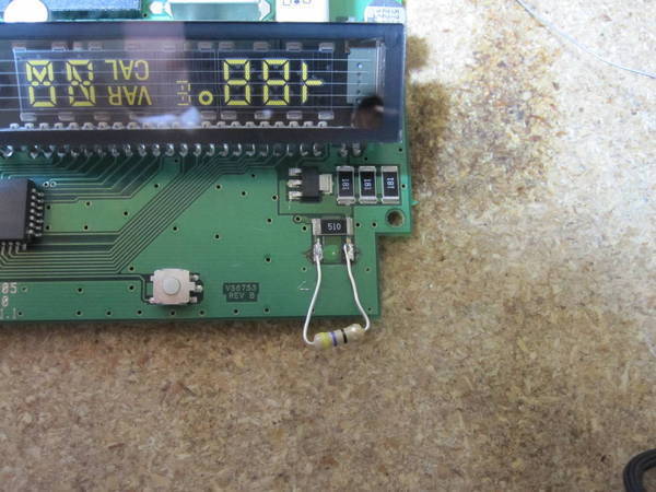

    For those of you who have had to re-solder the resistor several times, and for those of you who have damaged that resistor, you can replace it!
    I had to re-solder mine a few times and the last time it no longer worked. The resistor had no resistance when testing it with a multi meter. So, I went to radio shack and purchased a pack of 5 (47 ohm) resistors for $2. I used 47 ohm because thats the closest that radio shack sells to 51 ohm. They are not surface mount, but it worked none the less. And I am sure they can handle more heat because they are not the surface mount type.
    Its worked fine for several months now.
