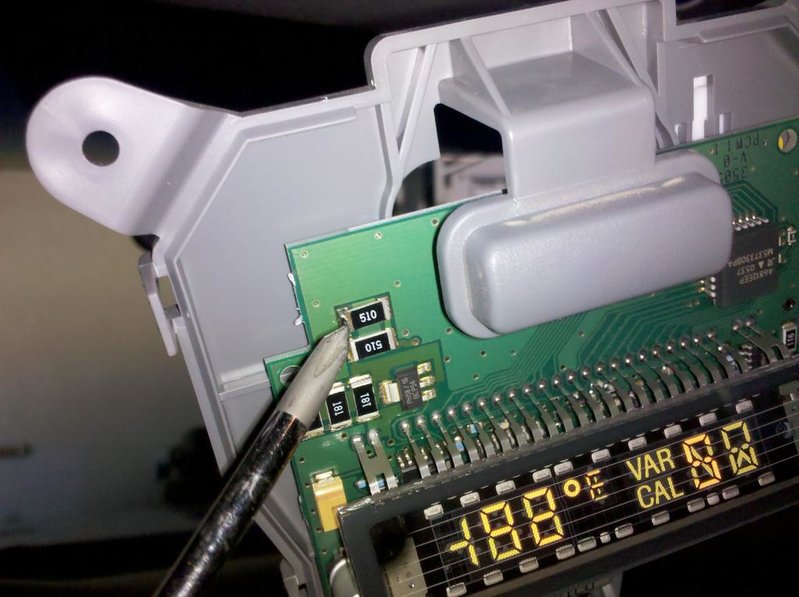

  9. Oct 13, 2010 at 11:48 AM
    #649
    bigwavehunter
    bigwavehunter Member
    Oct 9, 2010
    #44423
    14
    Dan
    Phoenix AZ
    TACOLESS
    On my 2006 I had TB Spacer, Air Raid Intake, True Dual Exhaust, 2.5 inch lift, Weather Techs, Tonneau cover, nerf bars, Wet Okole seat covers
    I would suggest first melting the solder on to the end of the soldering iron first. Then I simply pushed the 510 resistor ( or what ever the hell it is) down with a pencil (the eraser end). I simply had to touch the soldering iron to the busted end of the 510 resistor and that was it. Let it cool for a couple of seconds before releasing the pressure you are applying with the pencil. Good luck!!!

    ^^This! I used a pocket screwdriver.

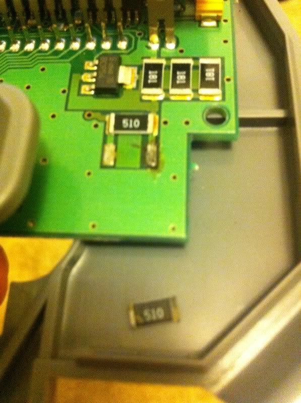

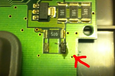

    rmahoneybiz
    rmahoneybiz New Member
    Aug 23, 2009
    #21619
    3
    Incline Village, NV
    11 Offroad Crewcab
    Offroad Package, TRD Exhaust, LED BrightWhite Interior Dome & Map Lights, Ceramic Tinted Front Windows, Pace Edwards Full Metal Jacket
    After a year of having this fixed, I just had this blowout the other day. Not sure if the board is shorted or what. Same soldering techniques as everyone else, but I'm back here again.510chip2_07917bf994b3a0028100c209788f2dcd3213fa2d.jpg510chip1_e9dfff1d8db8e7cc94d682d7a8bcadcdb07066d3.jpg

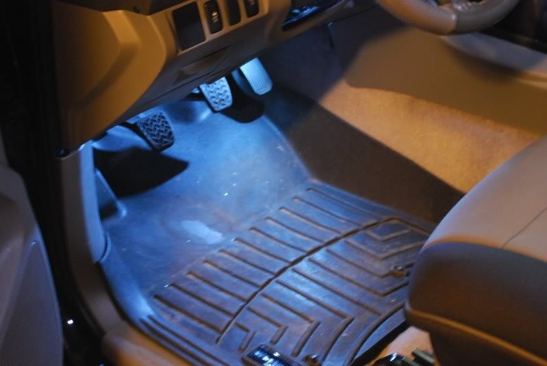

  19. Oct 30, 2010 at 10:00 AM
    #659
    95SLE
    95SLE Starting to get cold outside
    Aug 5, 2009
    #20718
    12,213
    Tom
    Maryland
    09 RWD Access Cab
    Custom XM Install, Window Tint, Intermittant Wiper Install, AVS Bug Deflector, Bed Mat, TRS FX-R retrofits, CIBIE fog and spot lamps, PIAA 510 lamps, Acess LE cover, Weathertech Digital floorr mats, LED interior lighting, Pioneer AVH-2300BT HU, Boston Acoustics speakers, JL Audio Amp, shorty antenna, leather wrap steering wheel cover, Viper security system.
    I really like this site!!! :D
    Got the info I needed to remove the overhead console so I could hook up some foot well lights this morning.
