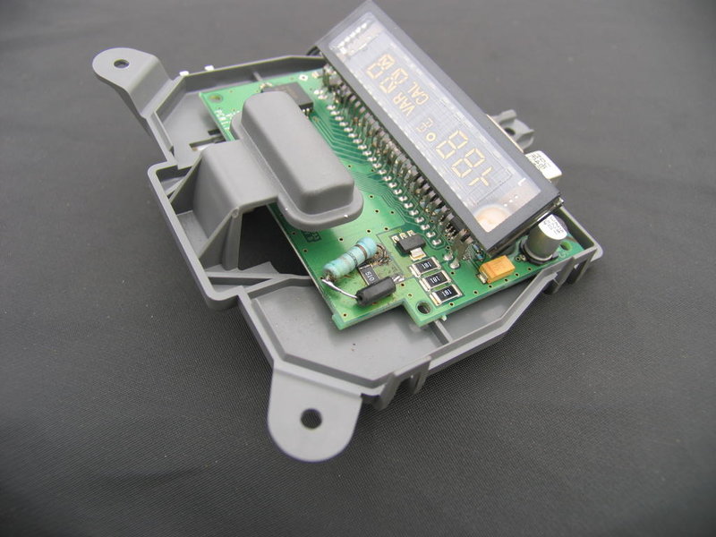

    I just performed this repair on my truck. The top 510 resistor had completely fallen off. Fortunately the risistor was hiding in the plastic housing. I used a small clamp to secure it to the circut board and soldered both sides.
    The display works like a charm!!
    Thanks so much for this fix!!

    I followed these directions after mine went out today and noticed my 510 resistor sitting at a 90 degree angle!! THANK YOU FOR POSTING THIS ONE!!!

    It looks like I'll be doing this next weekend when I get home. My display quit working a couple weeks ago and I'm grateful that I found this thread instead of letting the dealership rob me blind!

    One of the resistors was completely missing so I just used a Carbon Composition one.

    I opened up the panel and gained access to the circuit board and to my amazement I saw exactly the same seperated resistor. $15.00 dollars later for a soldering kit and it works. The soldering job looks like hell but it works fine so far.

    I've fixed those 510's so many times. Finally thought I would replace them all together this time so I installed the 47k Ohm one's as detailed and it didn't freaking work. Decent solder job too! Put the original 510's back on and now it's working (for now!). Go figure;)

    I re-soldered mine today and it works just fine. Mine was just barely cracked and not discolored. Added solder to all the 510 joints.
    Isn't the ohms suppose to be (51) ohms or at least (47) ohms? Not 47K. If so installing the 47K would cut the power too much and no display would show. :)

    My compass/temp gauge went out last week. I finally got around to fixing it today. It took longer for the soldering iron to heat up then to remove, repair, and replace the unit.

    First of all, Big Thanks for the how to fix. All is good again. Second mine had a large burn mark on the corner of the LCD and it did not effect opperation. Hardest part to fix was a steady hand to re-solder.:D

    Opened mine up and 510 fell out lol scraped other one off and re-soldered mine....works! U never realize how often u check temp/direction till it's gone :)
