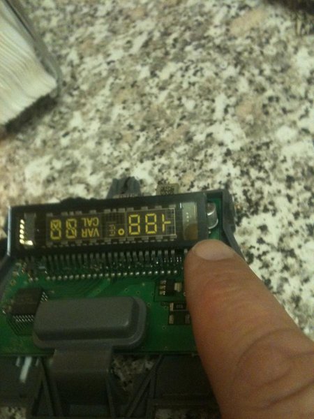

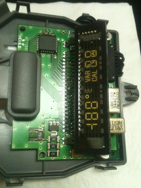

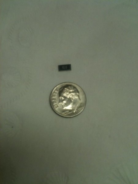

    Mine went out yesterday just finished the fix. I read about the first 5 pages of this thread. My little 510 resistor was off, I could not beleve I found it on my floor. I pulled the unit in the garage walked to the house and took apart in the kitchen.
    This thread is a big money saver. The only thing I will add is the resistor might be laying in the plastic and don't worry about soldering. I was worred about soldering that small resistor forgot to take a picture after. I had two very small dots 1 each side. So I have a few pictures, one is of the read out it looked bad but it was fine.
