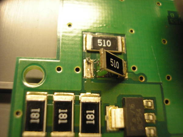

    I got so far as to have the circuit board in my hand. The 510 resistors were HOT..
    I pushed in on the 510s and the display came on, for a few minutes. Then went off....

    Took about five minutes to remove the thing (again).
    Pop off 'd the circuir board completely. Theres no way to do anything to the rear side of the board.
    I looked at the resistors on the face of the board by using a magnifying glass. I could not see anything wrong.
    I said to myself, "Self, if you solder and it doesnt work, soooo?."
    I took my old pencil soldering iron and dropped a very small amount of lead to each side of the two 510 resistors.
    Reinstalled and IT WORKS !
    For now anyway......
    If it dies again I ll be back on this post.
    Again THANKS for helping.

    2007 with 70K miles and the temp/compass quit. Took it off and it was identical to all the pics and descriptions above. The outboard edge of one 510 resister was loose and the other resister looked to be not far behind. I am not good at soldering but this was easy to re-connect the edges.

    When I took the whole thing apart, there was no visible damage to the resistor. So I plugged it back in and pushed on the resistor and voila, it worked (be warned, the resistor gets very hot!). So I just soldered both sides anyway and it worked great. About a 15 minute fix...awesome.

    Here's what mine looked like before I soldered it . . . and thanks OP for posting this fix.
