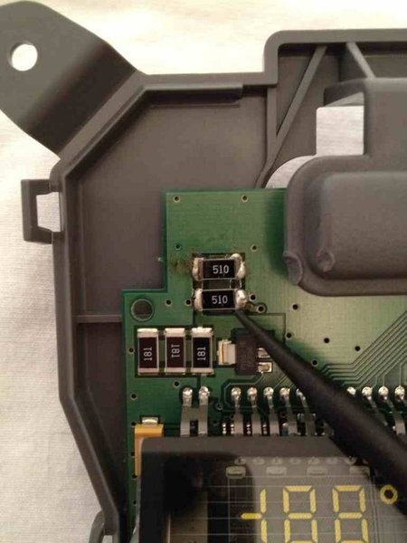

    @ ph16drive: nice effort, but the insulation isn't going to help with thermal effects. (it might help with any rattles though). The circuit board failure is caused by three problems: RoHS solder, heat/cooling cycles, and poor engineering. Ambient temp doesn't seem to have a ton of influence, as I have plenty of repairs come in from Canada, Alaska, etc.
    The only way to permanently repair and bypass the issues is to remove all the RoHS solder and old components and start fresh. See my DIY guide here.
    -greg

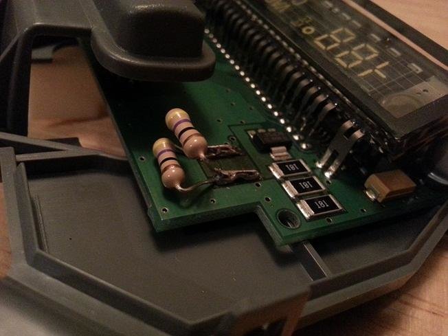

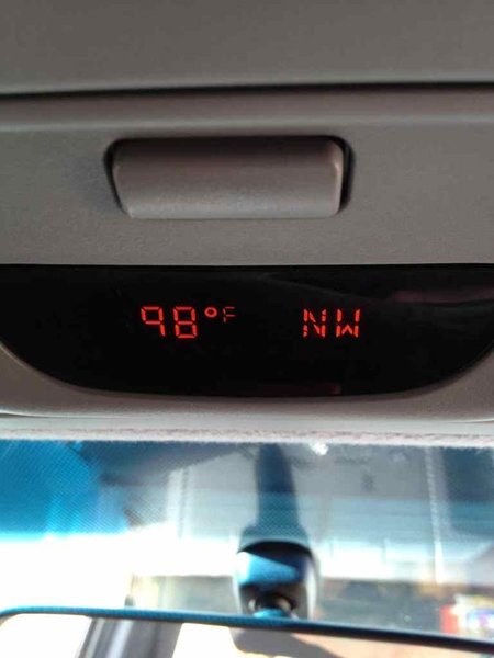

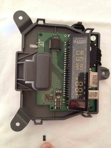

    Just got a Tacoma a couple weeks ago and the compass didn't work (mentioned it during negotiating the price and the cost of repair through the dealer) ;) and finally fixed it today.
    When I first took everything apart, one of the clips holding it up was missing and the other one was stuck up in the roof (got some new clips from the dealer).
    Anyway, after inspecting the board, I was bummed cuz it looked like everything was fine. Then I picked at both of them with my fingernail and one of them popped up!
    Bought a nice pen style solderer, some 60/40 solder and some 1/4 watt 47 ohm resistors for $16.
    Took about 10 minutes to solder and installed it back in the truck... BAM!
    Calibrated it, verified the location and everything is accurate and working great.
    Thanks to all for the detailed info!

    A reminder to the folks about to resolder their boards:
    1.) make sure the solder doesn't bridge, especially to the through-hole next to one of the resistors. (the small, round copper areas). This is a board-destroying short.
    2.) I strongly recommend you follow the DIY guide here. If you don't, your repair is going to fail again at some point in the not-so-distant future.
    3.) solder quickly! Heat from your gun / iron may be destroying components nearby. Press the clean, tinned iron to the junction of the board and resistor and immediately feed solder. You should get a nice shiny fill.
