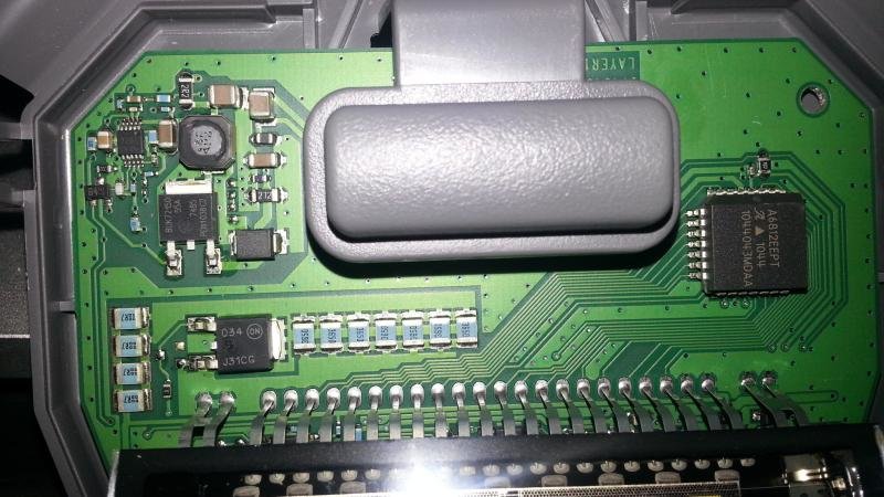

    My Compass/Temp does not look like any of the posted circuit boards. No resistors are labeled with mentioned numbers

    pic?

  15. Nov 10, 2014 at 9:27 PM

    ^hmmm maybe they changed it because it was breaking too frequently?
    Is yours broken?

    yep display went dead

    I can't tell from your pic, but all of the parts look to be in place. When ours die out, the 510 resistor is obviously disconnected from the board

    nothing in same size or value in all the SMT resitors

    Lay a layer of solder along the edges of those SMD resistors that are there. Also look at the regulator close to the SMD resistors. It almost appears to have a hole in the top where the smoke got let out.
