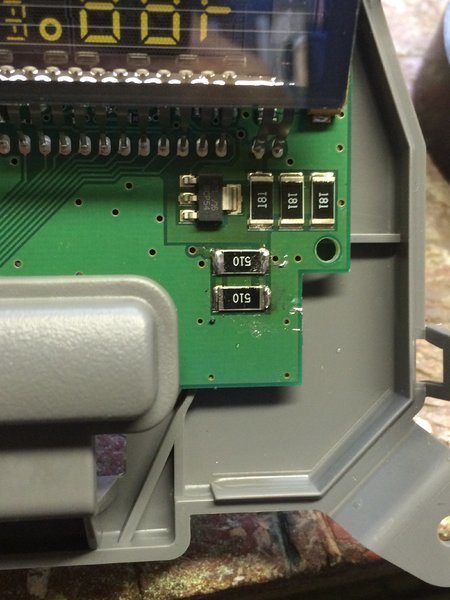

    My 510 had completely fallen off and was rattling around in there. Did my best to do a neat job. Dabbed a little extra on the other 510 as well. Plugged it back in to test it and sure enough, Worked like a charm! Thanks again TW!
    Here's my after pic :)

    I just fixed mine after 2 years of it not working. Only one 510 resistor was lose on one end. The copper pad on the PCB was curled up and it fell off when I touched it. I scraped the PCB to remove some of coating to expose the trace and bridged some solder to it. It works now but I don't think it will last for long since he SMD resistors get extremely hot when the compass was powered on.
