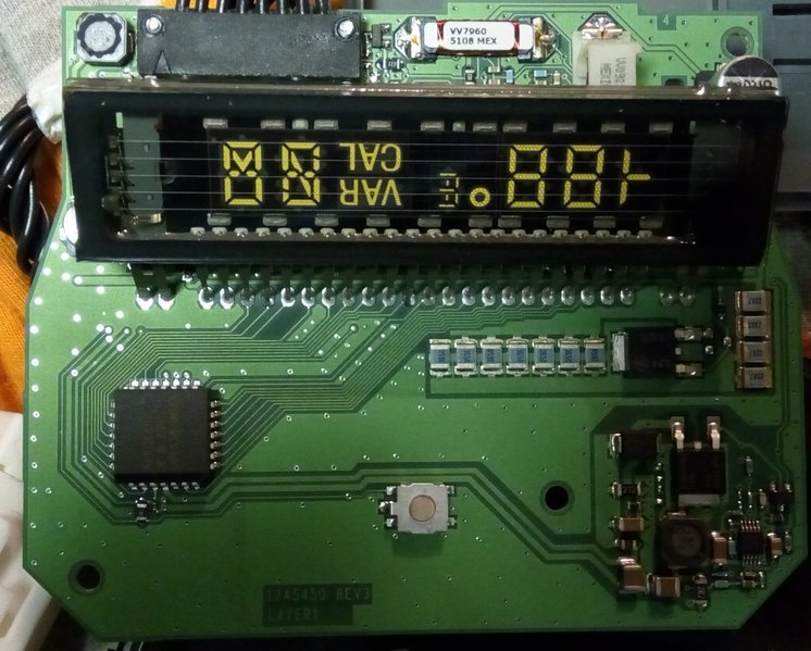

    Hello guys,
    Since I bought truck overhead temp display shows only three dashes.
    Today I take off and opened compass/temperature box and found that my board very different.
    There are no 510 resistors. It has a little different shape.
    All elements look good and all solder is good.
    What should I check next to find out why temp doesn't work?

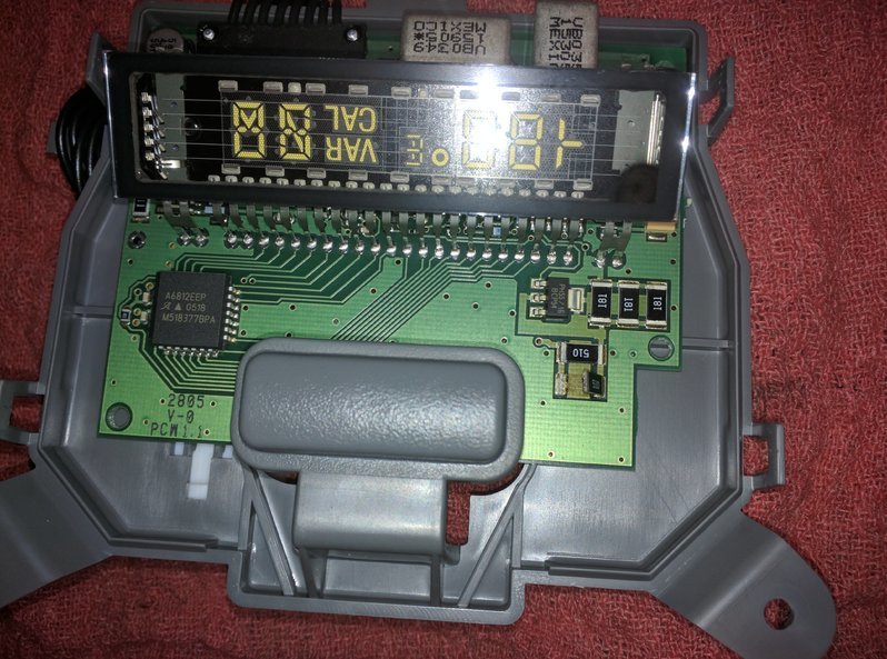

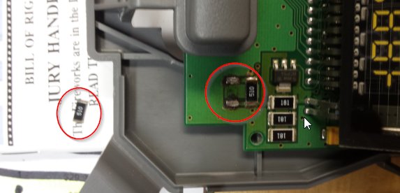

    My 2008 OEM one lasted 4 years, then the PO fixed it by soldering on the surface mount resistors back on. (It wasn't pretty but it worked) It died again the other day and it appeared that one of the resistors had popped off. I put in two of the 51ohm round resisters instead. Total time spent on repair was under an hour.
    This is what I found on opening it up, plus solder BB rolling around. A little heat on only one side and they fell off.
    After soldering in two 51 ohm resistors. Works great again!

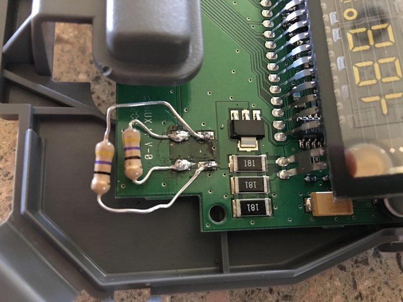

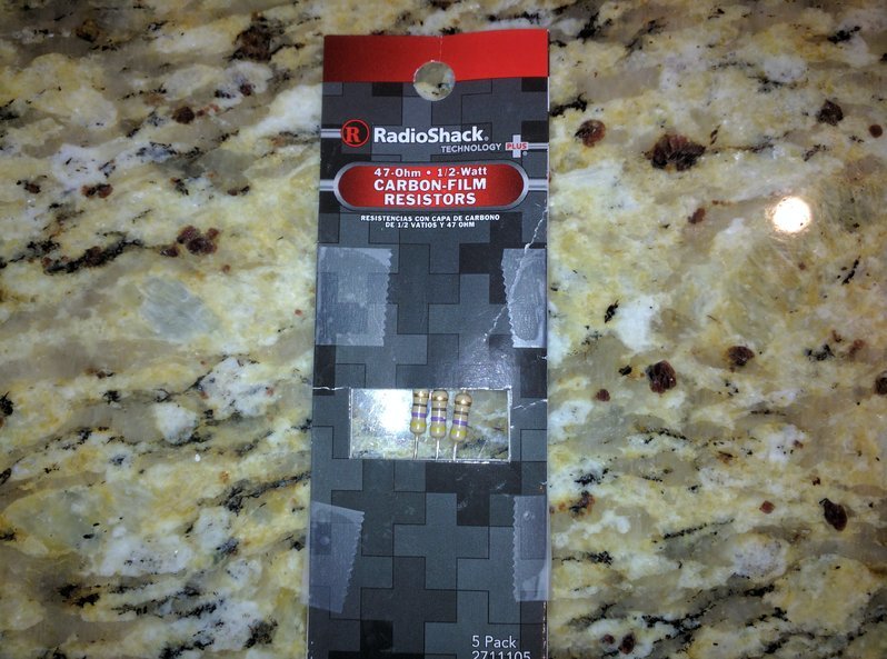

    Since everyone seems to be having such great luck with this, I thought I would share my story..... I did mine this weekend - no go. The resistors are good, the soldering is (now) good. No readout. :-( The overhead lights work fine so the fuse is fine (same circuit) I am so disappointed.
    I don't feel like going deeper into trouble shooting than the resistors - The good news (I suppose) is you can buy the module for $112 on Amazon right now (from Daytona Toyota). Or you can buy it at your local Toyota for ~$150. Just don't ask Toyota to fix it! They apparently just replace the whole overhead console (I assume, because they are charging 4-6x the cost of that module (and it takes 5 minutes of labor to replace the module!)). Here's crossing my fingers the board is the issue....
    The new boards do have the issue fixed so at least I won't be having to do repeat repairs! (I am a die hard glass is half full.)
    2007 Tacoma.
    UPDATE!!
    I am a stubborn engineer.... I cancelled my order for the replacement and went to Radioshack. Bought a 5 pack of 47 ohm, 1/2 W resistors. $1.49(+ tax). Took the thing apart, again. Heated up the soldering iron, again. As I am struggling to get the two soldered in that small space I am thinking "this isn't going to work. The thing is hosed. My pads are getting compromised... its over! Just go buy the dang thing!" I finished up, took the board out to the garage, plugged it in, turned the key and nothing. "Now are you hap.... " the lights came on!! I have direction and temperature. Never give up. :) The ends of the SMD's get oxidized... its why I tried axials. I found direct replacements but then I would be dealing with the same issue as before... axials hopefully will never need replaced or re-soldered. They certainly will cool better. I am one happy camper!!!!

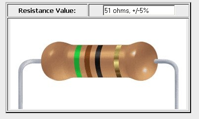

    oh... and for those of you reading the thread through.... the resistors are 51 OHMs. The naming convention for chips is as follows
    The 3-digit code
    Standard-tolerance SMD resistors are marked with a simple 3-digit code. The first two numbers will indicate the significant digits, and the third will be the multiplier, telling you the power of ten to which the two significant digits must be multiplied (or how many zeros to add). Resistances of less than 10 ohms do not have a multiplier, the letter 'R' is used instead to indicate the position of the decimal point.
    (I worked in the industry early in my career).
    I actually checked the values of the resistors with the multimeter to see if they were good or not ... 51 ohms, smack on.

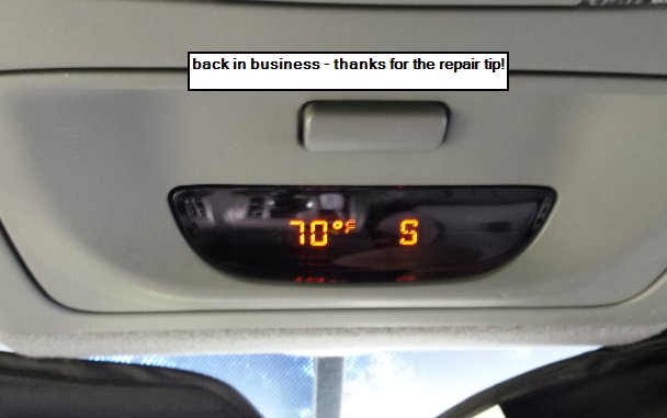

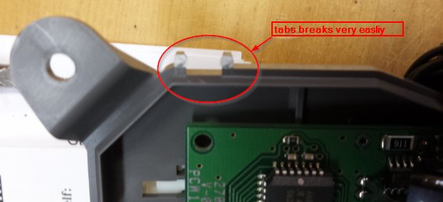

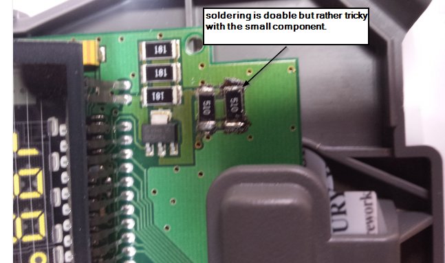

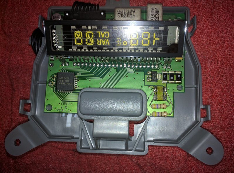

    Thanks for posting this repair tip, took almost an hour for me to do. Removing the display was easy just the soldering part was a little tricky with such small device, (surface mount chips not really made for hand soldering). Be careful when removing the display, my resistor broke off and was loose in the assembly, could have lost it very easily.
    compass_temp display repair(1).jpg compass_temp display repair(2).jpg compass_temp display repair(3).jpg compass_temp display repair.jpg
