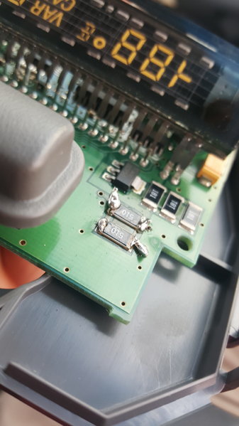

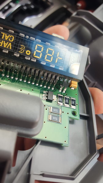

    Have you been trying to just redo the solder joints? Best results come from replacing the resistors altogether and using a good solder.

    What resistors? got pics? I am a visual type. Thanks bro!

    Brother, do yourself a favor and get the 51 ohm resistors shown on post #1900. I did what you did 3x and I was as happy as to when I lost my virginity. Go to fleabay and you can get them there. One 10 pc pack for 2 dollah. Will last you a long time.
