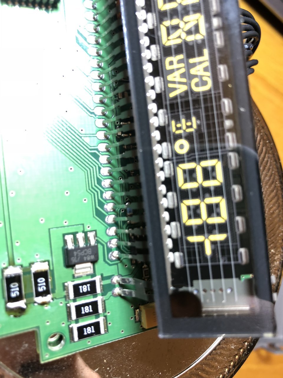

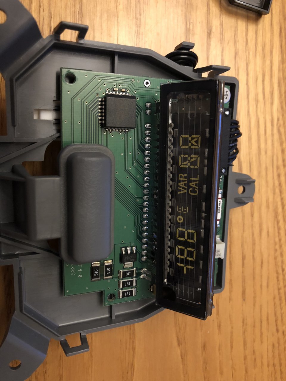

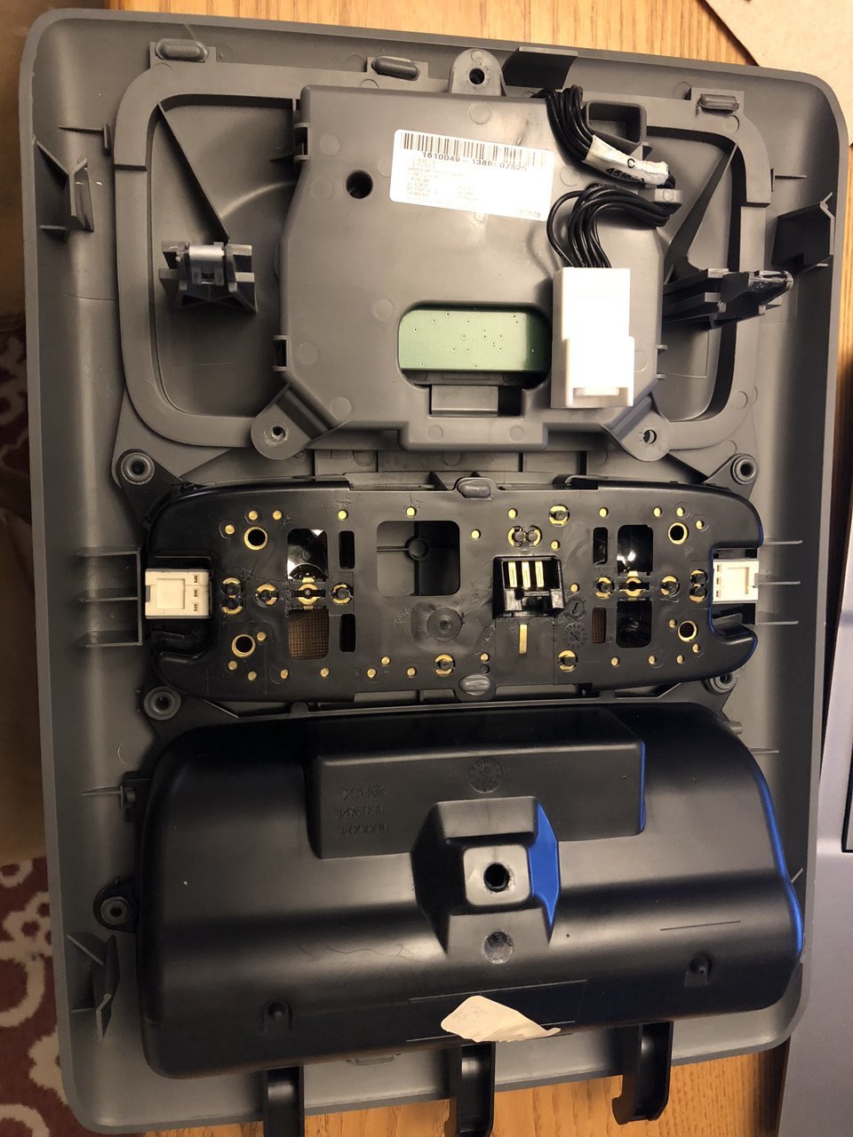

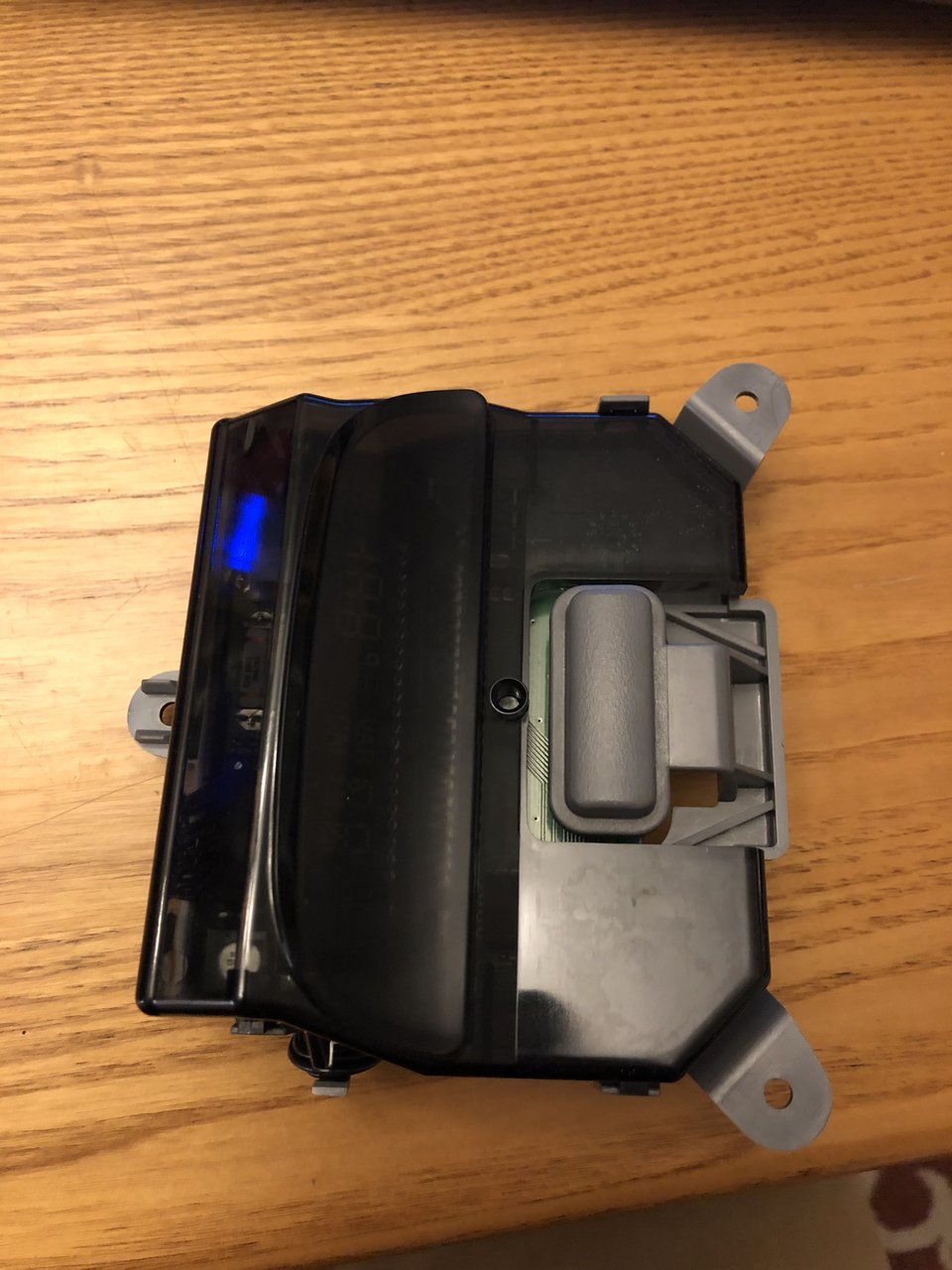

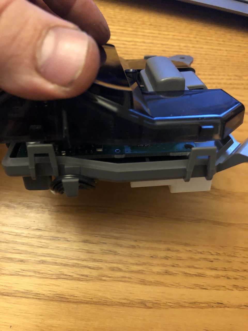

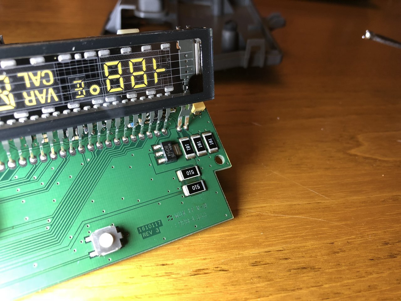

    Hi guys, i have had issues for a while on and off. sometimes if i wack it hard it comes back on and stays on, but eventually it got worse and worse, i dropped it down and brought it in. also got some new photos since the original ones on this thread seem to be not displaying for me.
    It looked like there might be a hairline split on the 510 closest to the display on the side facing the middle of the board. it was super hard to see and only obvious in certain light. i dropped a touch of RadioShack lead free solder i had kicking around on each side of both 510's
    when it went back in it lit right up but now is displaying 60 deg F when it is definitely 40 deg F outside. hoping maybe it will just get its self figured out by morning?
    possible thoughts, did i overheat one of the resisters and cook it?
    did i drop some hair or dust in there that could have shorted something? (it was haircut day today)
    what should i do if this problem doesnt correct its self?
    also in the last photo i tried to get a shot of what looks like a burn brown blob in the right bottom corner of the display, is this what others were seeing?
    photos>>>
