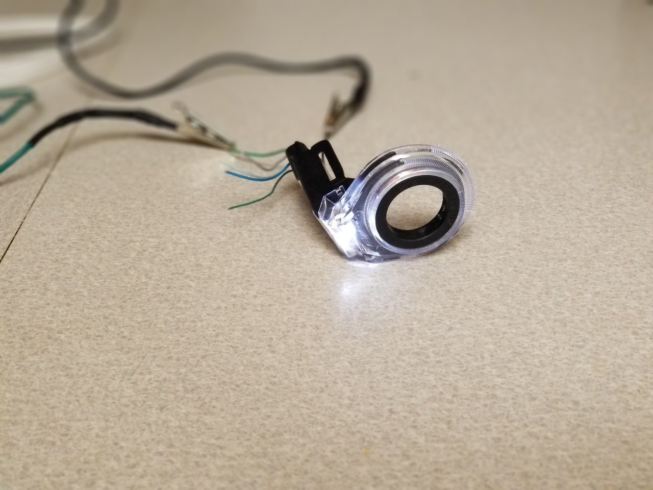

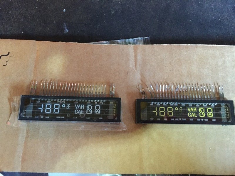

    @Up2NoGood,
    So I went to a junkyard today and came across an overhead display and got it thinking I can sell it to someone on here. Is there anyway to test at least that it'll light up before I try to sell it? I don't really want to take my truck apart because my luck something will go wrong and I'll have to fix it haha. I tried 12v to the light green and then ground to white with black stripe. Then I also tried dark green and white with black stripe. Nada.
    I saw this but couldn't tell what wires they were.
    Oh I also picked this up too for $5 haha

    I was able to hook mine up to a 9v battery and get it to light up.

    I was finally able to get it. I have a 12v power supply for testing but I had to connect the yellow with the green to show temp display. Without the display having something to show it doesn't do anything.
