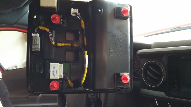

    For the life of me, I cannot find the correct part number to order one, or the clip for that matter, it flew off into the interior somewhere. Anyone know what part number it is?
    Search isn't helping. I found this pic on the forums, using it to show exactly what I'm after. The red clips are the one I am after.

    Call the dealer I believe they are called pressure clips but Toyota uses them for all their interior factory ones for roof panels are usually red but at the dealership they may be grey or black

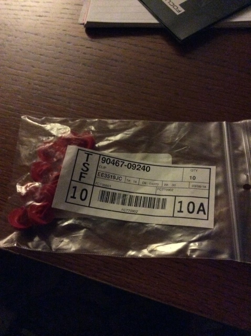

    The Rexka clips mentioned above are no longer available, so I did some shopping around. If anyone else is looking for these clips (OEM Part # 90467-09240), I found them at Suburban Toyota of Farmington Hills in Michigan. You can order online. I'll be removing my overhead console soon and thought I might keep a few on hand in case I break any. Suburban charges only $1.13 per clip and their shipping for four clips is only $4 to NYS. Some of these places charge anywhere from $10- $20 to ship these little clips!
