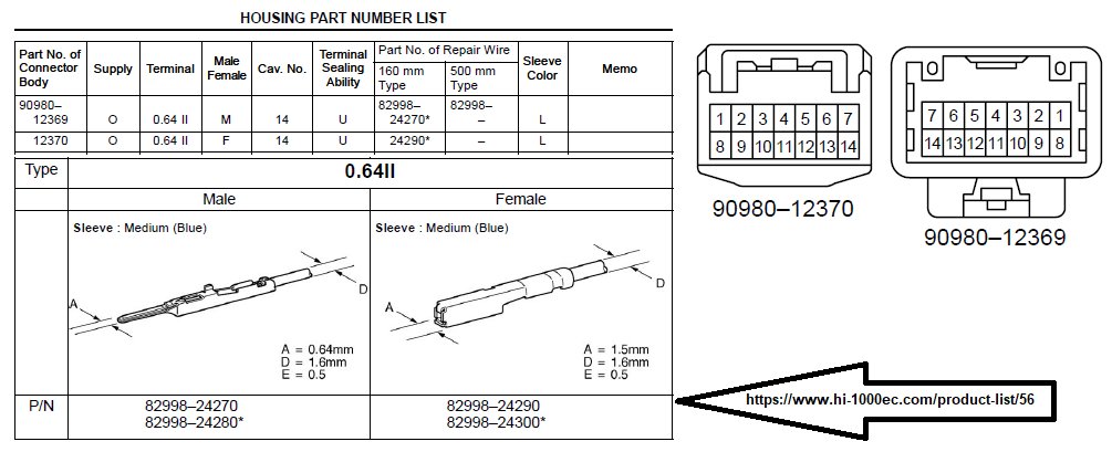

    I want to get power for a dashcam from the overhead console spare 14 pin connector in my 2015 Tacoma Double Cab. This connector is for the overhead compass/temperature/mirror option I believe. I think the connector in the truck is designated as I8 and is part number 90980-12370 (female connector in the truck with 3 wires going to it) and to connect to it I believe I need a 90980-12369 (male connector). I found the 90980-12369 connector but I think it is just the plastic connector, with no pins or wires. Does anyone know how where I could get a 90980-12369 connector with wires/pigtails so I can connect to my dashcam wiring? Thanks in advance for any help.
    PS If I have any of the part numbers or assumptions incorrect, happy to get corrected on that.
    PPS I'd rather not use the 'vampire' clips unless I can't get the connector that will plug into the existing connector.

    No pigtail but the connector at any Dealership.

    If you buy the connector, I believe you can get the terminal repair kits which just plug into the connector. I’ll get a picture in a second. ^^ see above post. Those should be the pin already connected to a bit of wire which then you can connect to what you need.

    For a ready made harness, you can check out https://www.aliexpress.com/item/1005003780291406.html

    Or this one on Amazon
    Dongar Technologies Dash Cam Adapter (for 2nd Generation Toyota Tacoma with 14-PIN Mirror) https://a.co/d/2tKMMWo
