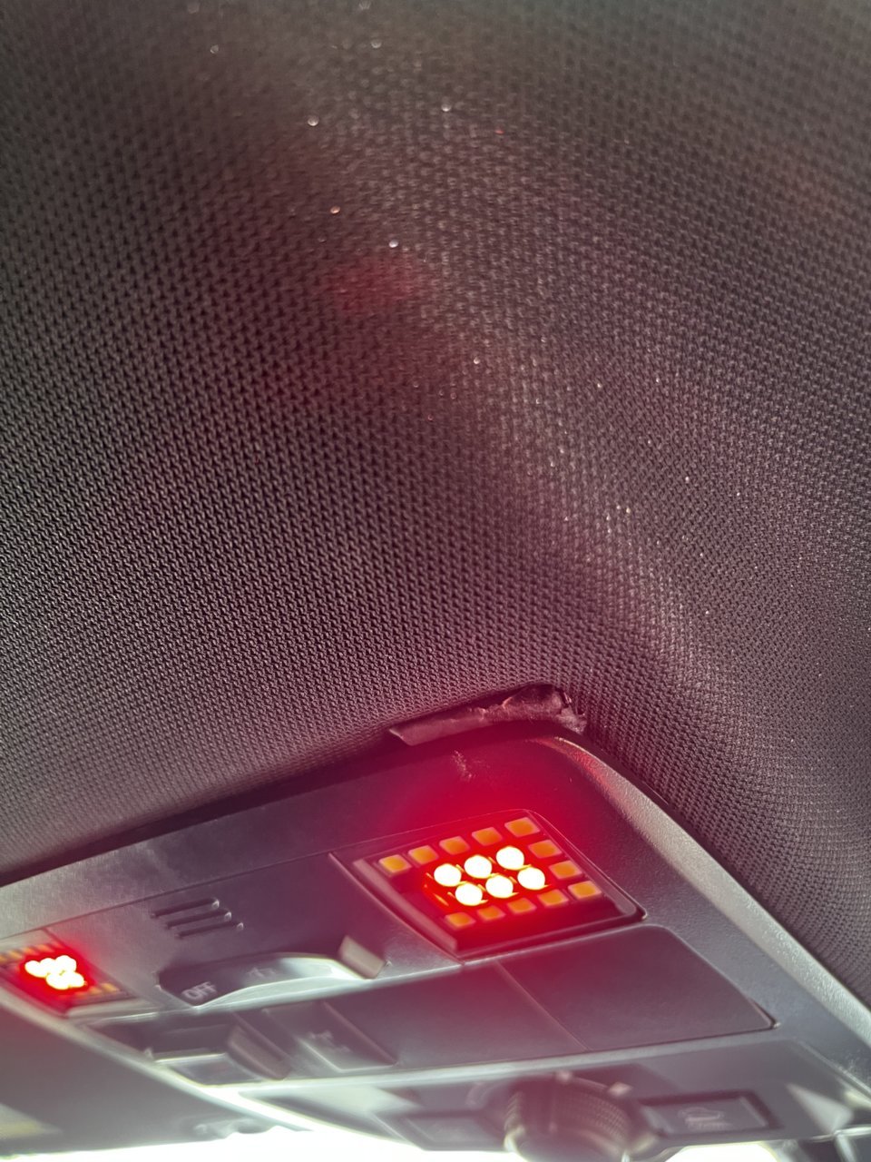

    Kyle_
    Kyle_ A guy and his expensive hobby
    Sep 3, 2021
    #376085
    755
    Kyle
    SoCal (805)
    2021 TRD OFF-ROAD 4X4 DCSB
    @tacoma.kyle on IG
    Should I be concerned about breaking tabs on this. Also, any tips on how to remove it without breaking anything. There’s a rattle at the front of my headliner.0EB16893-BCCE-4BD5-81DD-5388535D21C2.jpg

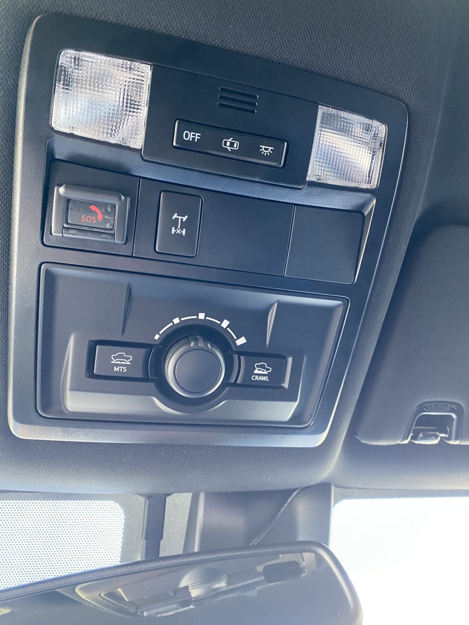

    SendtheFire
    SendtheFire Active Member
    Mar 13, 2021
    #359163
    25
    22 TRD Offroad AC
    I did a 10 hour road trip the other day and noticed this noise coming from the console that houses the overhead lights and crawl control. It has gotten worse over time and I figured out like many that if you push on the console it stops. I took it apart and wiggled things around and ended up taping the places where plugs enter the console because they seemed to make some noise. I also taped under where the wires touch the plastic of the console. I put the headliner back and it was still there though slightly better. Then I noticed that it was the actual headliner. There seems to be a few layers to it and they had come separated during the winter cold temps I'm guessing. When I lightly squeeze them together they stick and then unstick and it generated a sound that sounds just like what I hear when driving. So, I sqeezed them together tightly and worked my way around the entire edge of the hole where the console goes and reinstalled the console. No more sounds. We'll see how long that lasts, but I think I found the culprit and can find a more permanent solution if it returns. Man that noise was annoying!

    Nick
    2023 Lunar Rock Tacoma TRD OR
    OK - Finally got around to looking into the creak - Pulled the console down with a little bit of force - started at the two window side - disconnected the wiring harness. On my 2023 Offroad the creak comes from a black long piece of plastic that is rubbing against the foam liner. I used and old cycling sock (clean or else you replace the creak with doritos like smell - any bit of fabric will do) and wrapped it between the black plastic and the foam - put the console back - no creak. Here is a quick video of the fix after the consule has been pulled. https://youtu.be/MCuuwU40cCU
