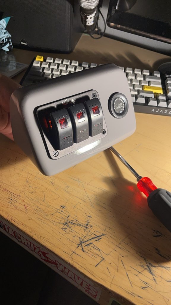

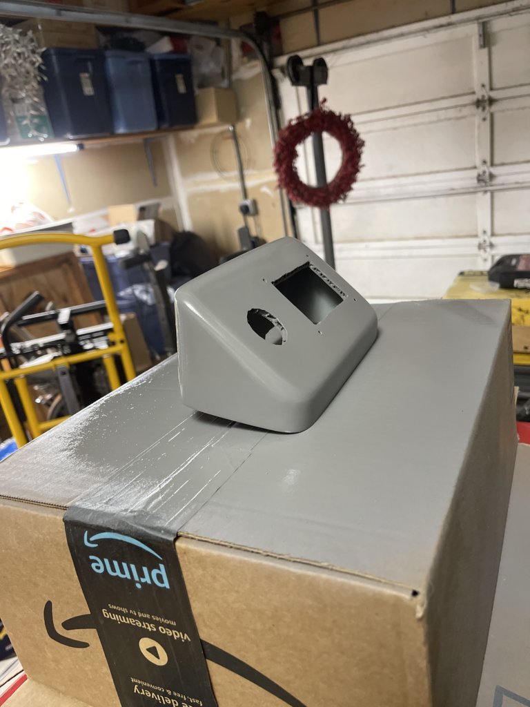

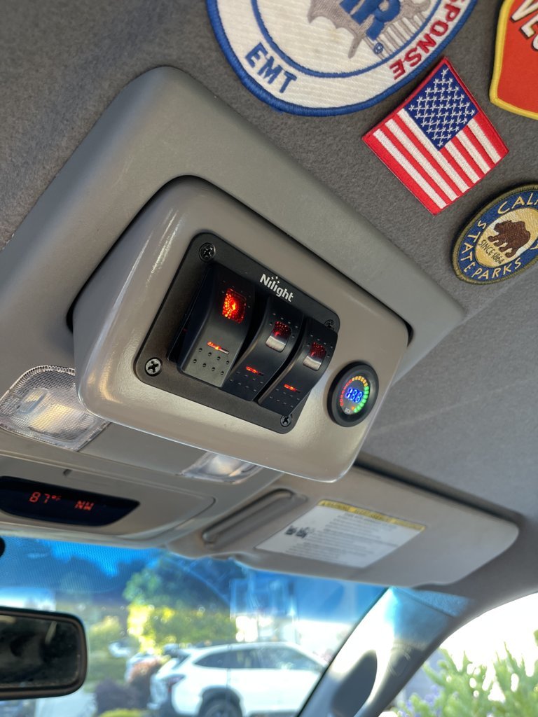

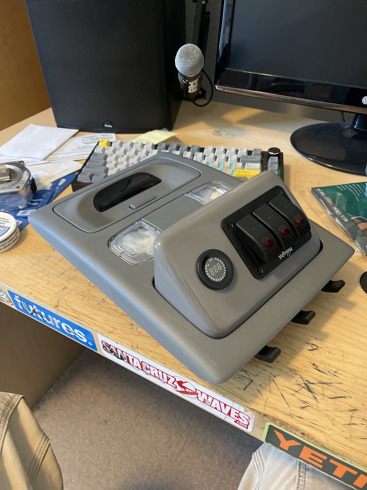

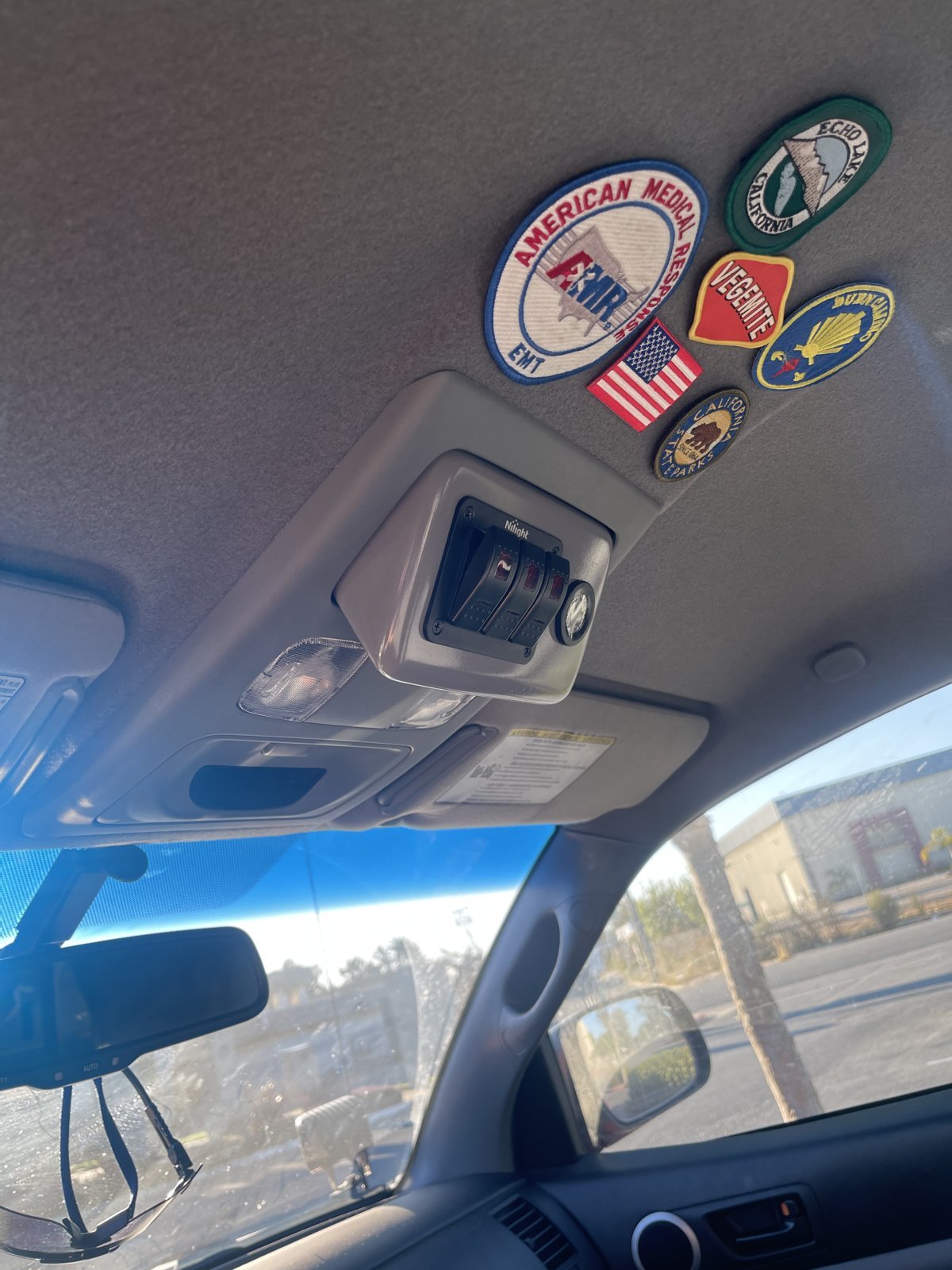

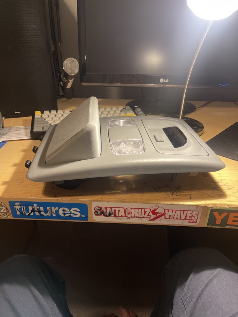

    Hey Tacoma world,
    Here is a custom overhead switch panel I made that replaces the sunglass holder on my second gen. I 3D modeled then printed the part, sanded it, and hit it with some paint and clear coat. I have three rocker style switches installed and a voltmeter but the electronics can be exchanged for anything else that fits.
    Heres a link to where you can buy one:
    https://www.etsy.com/listing/1783804726/tacoma-switch-panel-mod
    Here's a link to where you can buy the .stl file if your like to print your own:
    https://www.etsy.com/listing/1782186364/second-gen-tacoma-overhead-switch-panel
    here’s some photos of the part being made:

    That's a pretty good color match to the OEM plastic, nice job

    Looks amazing!! Would you mind sharing the STL file for the print?

    That might just be the best looking 3d printed part that doesn't look like a 3d printed part.

    That looks like a very clean looking mod and install. Nice job!

    What are the switches controlling?

    Looks good. Why not just model in the openings so you don't have to cut anything? Also, you could use heat set inserts for anything that needs to be bolted in.
    Pixeltim likes this.

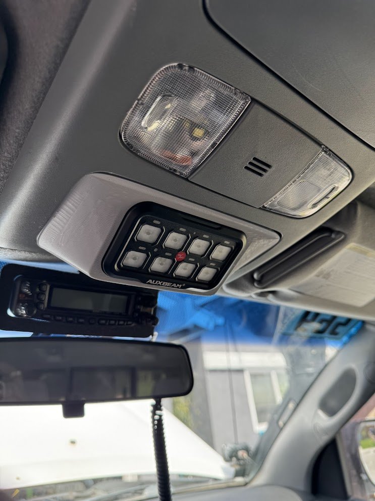

    here is my v1 setup to test and see how it holds up. clicks in place with no screws.

    What radio is that above the mirror and what are you using to power and mount that there?

    mount i made, its for a yaesu radio. its just a remote face, powered by what looks like a netowrk cord. main radio is behind the back seat.
