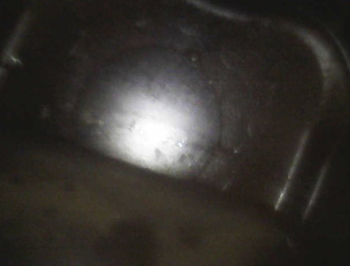

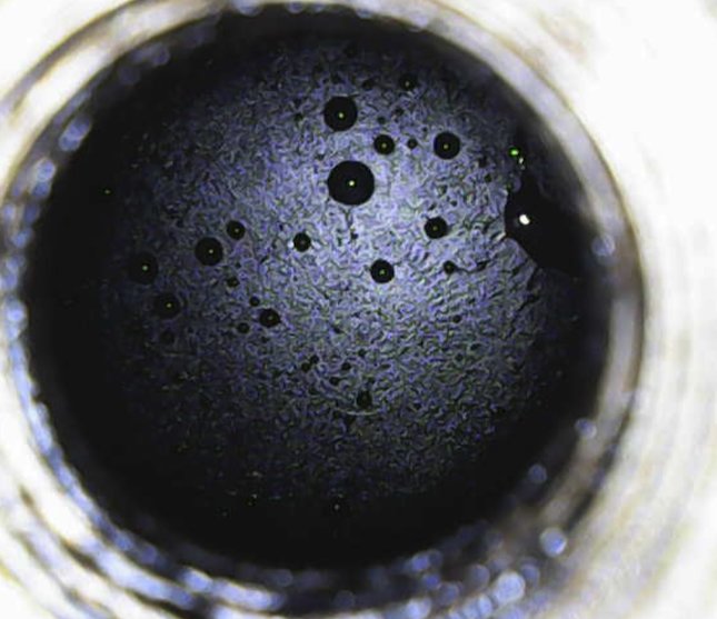

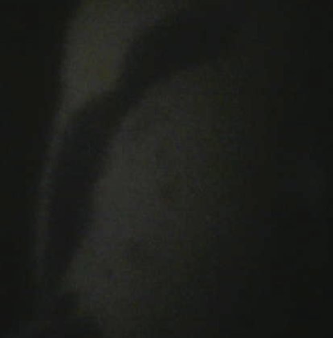

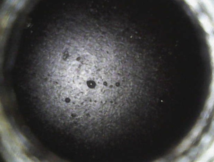

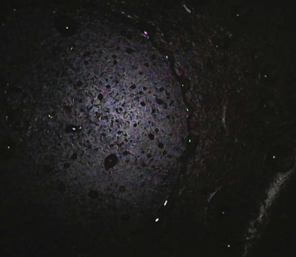

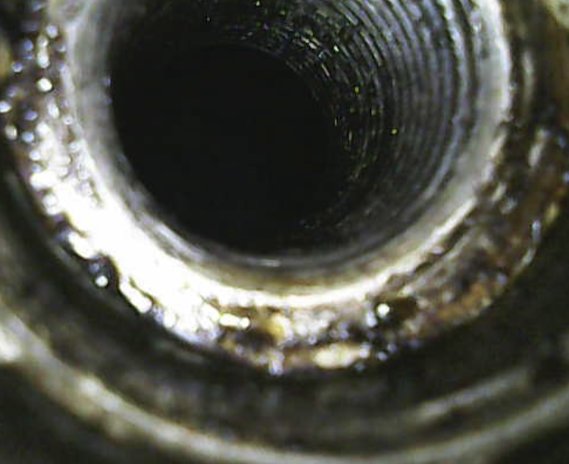

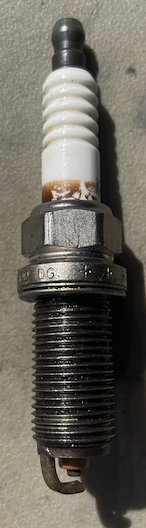

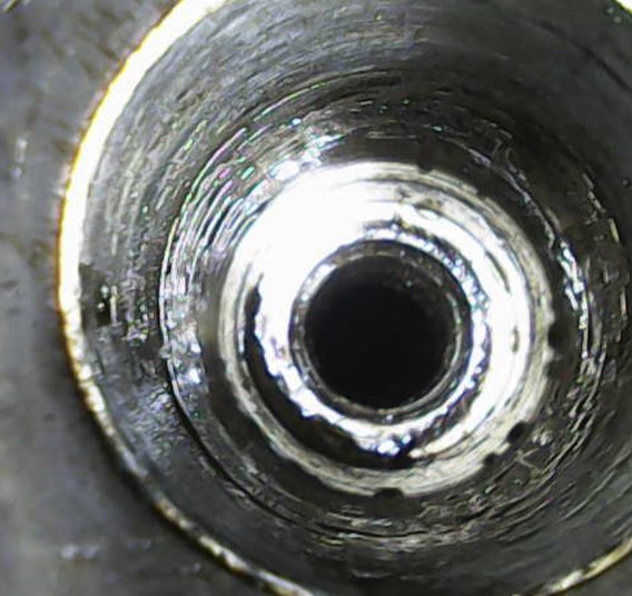

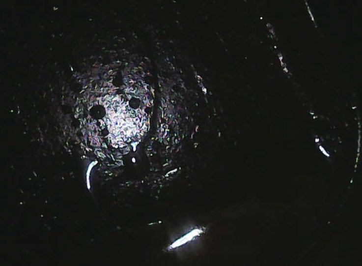

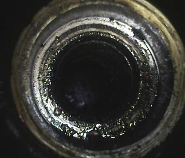

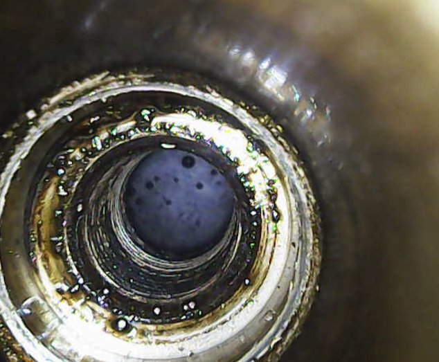

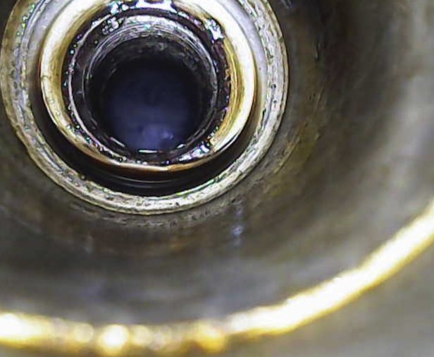

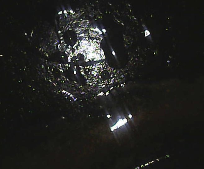

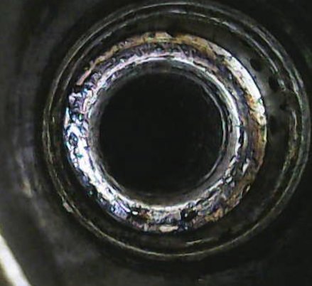

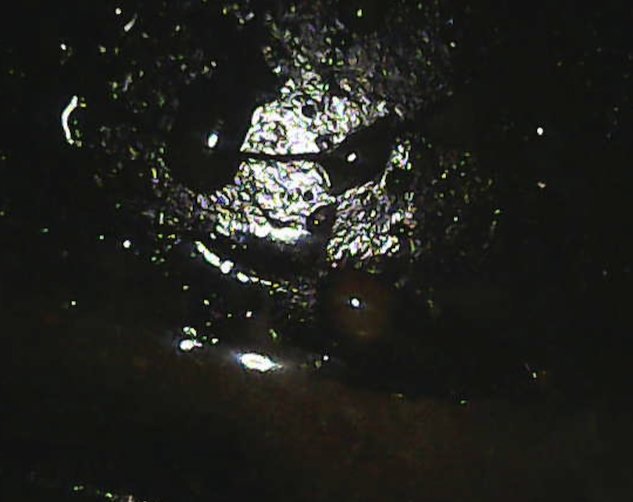

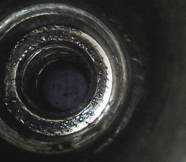

    Curious if anyone can make heads or tails out of these pics from the cylinders. Plenty of oil in the valves also confirmed by oil on the plugs -- bad piston rings and/or valve seals? who knows what else?
    Do I just get on with removing the heads at this point? I am on the lookout for another motor but am also very curious to find the root cause along the way.
    All the plugs look similar with the burnt ring above the thread.
    cylinder #1
    cylinder #3:
    cylinder #5
    cylinder #2
    cylinder #4
    it looks like there is a hole with light coming in ... not sure if that is a reflection from my cheap camera?
    cylinder #6
