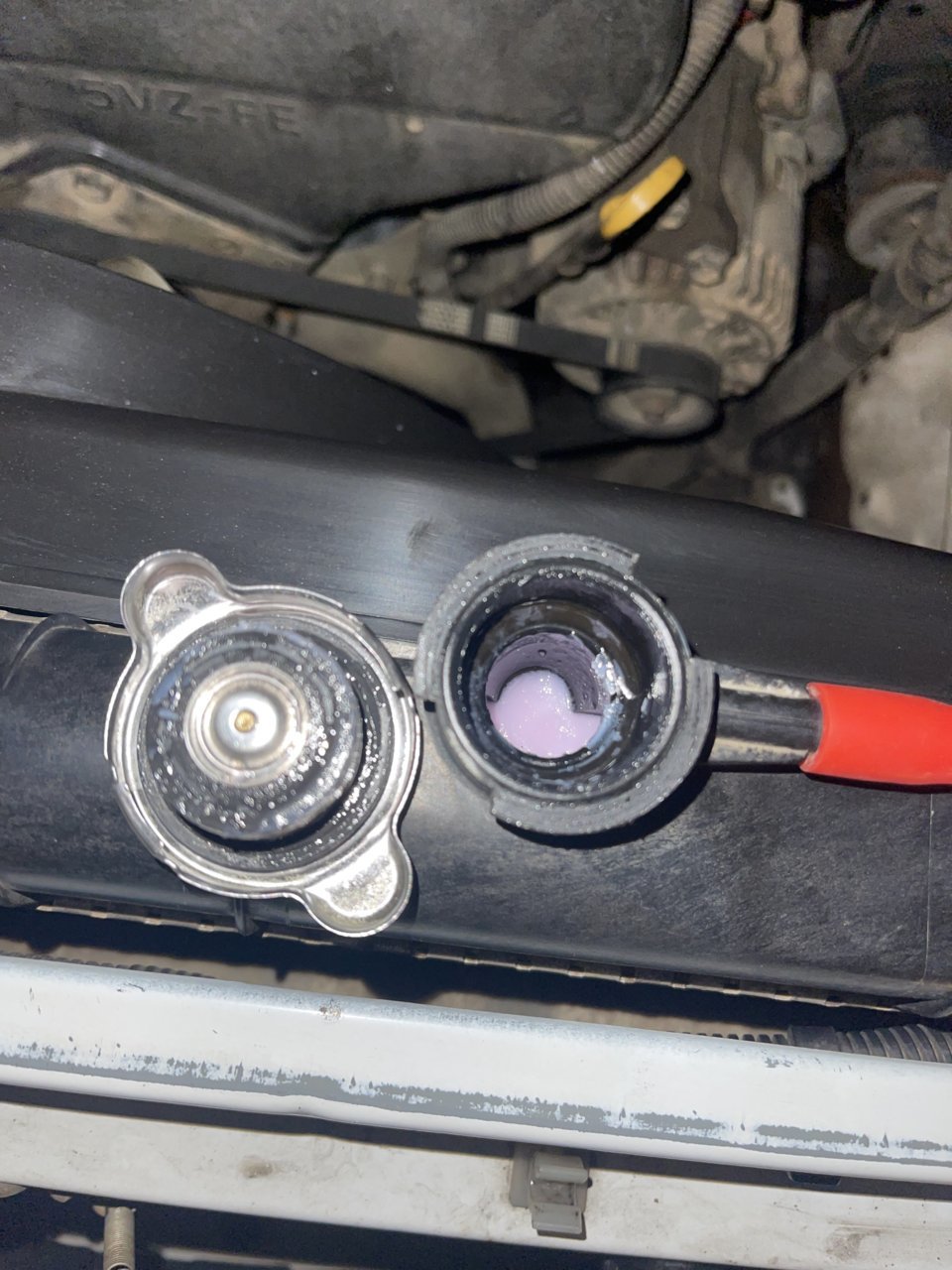

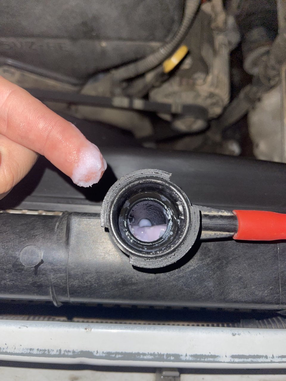

    Just got back home. Opened the radiator.. doesn’t look good.

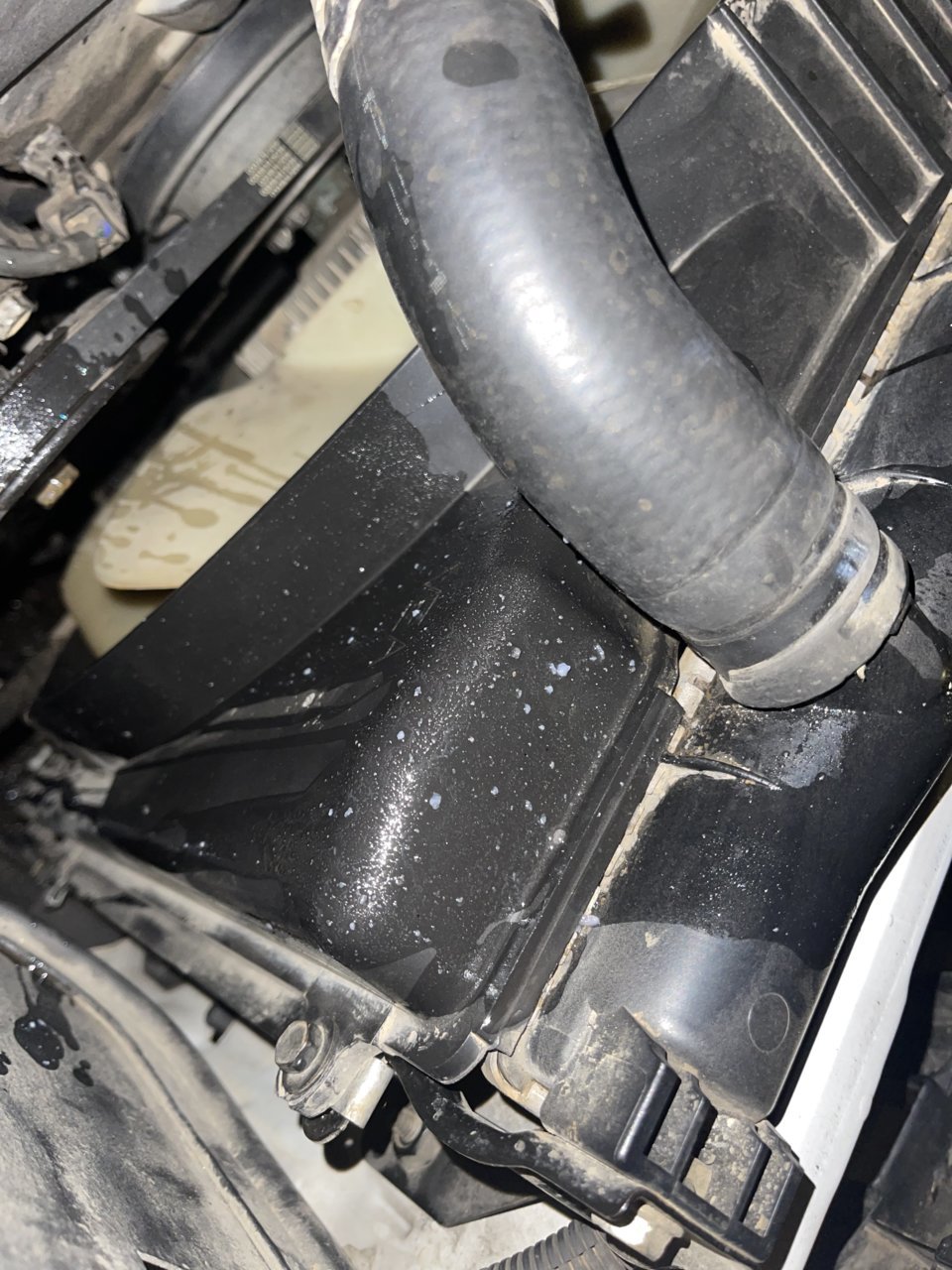

    Popped the top hose off for a second to see if it solidified that far. Mostly liquid with small chunks as you can see. But as for the radiator.. toothpaste. Oh well.
