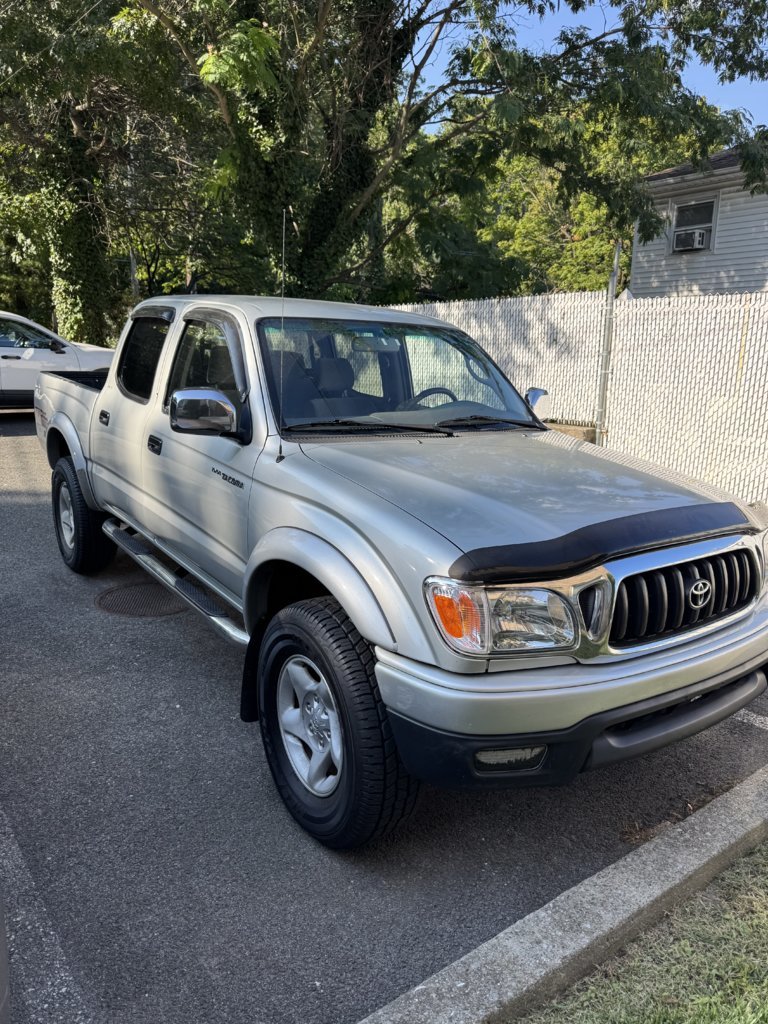

    Hi everyone, I had finally scored a clean 02 Tacoma double cab 3.4 V6 4WD with 183k miles. All fluids are topped and looking fresh.
    as I drove home from purchased noticed the engine coolant gauge went up to the high end and even to the red. I turned on the blower to get hot air out and noticed the gauge would come down when coasting like that. Would rise again in traffic until I got it home.
    Checked the rad fluid at cold and it was topped with green. And the tank next to it was also filled.
    Hooked up a OBD to read live data engine coolant temp while taking it for a drive and it read 230 Fahrenheit when the coolant gauge got up to the red mark.
    Seems like gauge is working along side rising temp so I ruled that out.
    What can I do next ?
    Thanks!!!

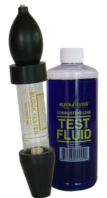

    a) Conduct a cooling system "block test". You can DIY with a $25 test kit from any auto parts store. This test is intended to determine if you have combustion gasses in your coolant. Which is indicative of a head gasket leak or engine block crack.
    b) Pressure test your cooling system to 20-25 psi. Get a kit from Harbor Freight and you can use your bike tire pump. Seriously.
