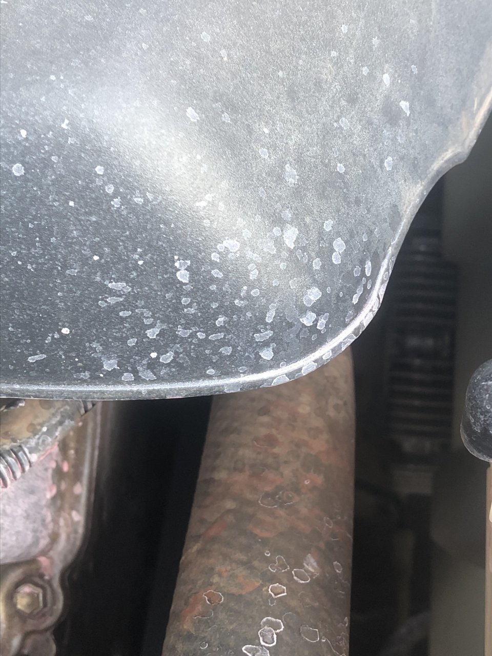

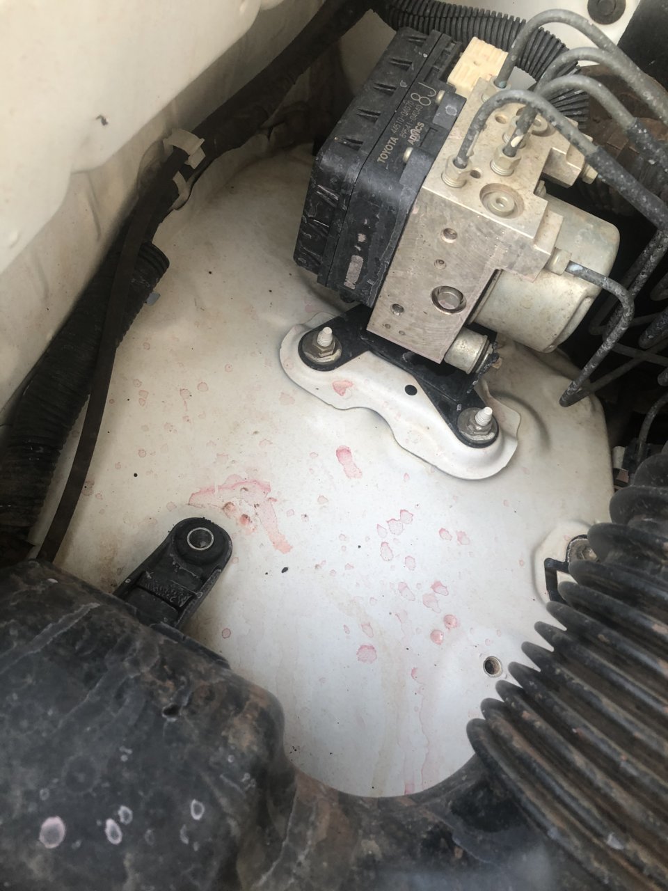

    so after a 3 hour drive through the desert 100+ degrees outside. Temp gauge in the normal whole time. I get to a cooler place 65 degrees and within 10 minuof traffic the needle starts rising. Open the hood and there’s dried pink coolant everywhere. I cannot find where it’s coming from though
    8/14 update - replaced the water pump, thermostat, and fan clutch all oem parts. Put in new Toyota coolant from the dealership. Still overheating
    8/15 update - did a cylinder compression test cylinders 1-5 stayed In the 150-170 range
    Cylinder 6 was 190

    Let it run and get to operating temperature with the hood open, see if you can spot a leak. Watch the bottom of the truck and see if anything is dripping and look around all the hoses

    Its possible that if you drove through the desert at high rate of speed the radiator started overheating but didnt fully overheat due to the air moving through the radiator at high speed but once you slowed down in traffic the fan alone wasn't enough to cool it down. The fluid you see could be from the radiator cap. There's a pressure release valve on your radiator cap that goes off if it gets too hot and pressure builds up which will shoot out fluid

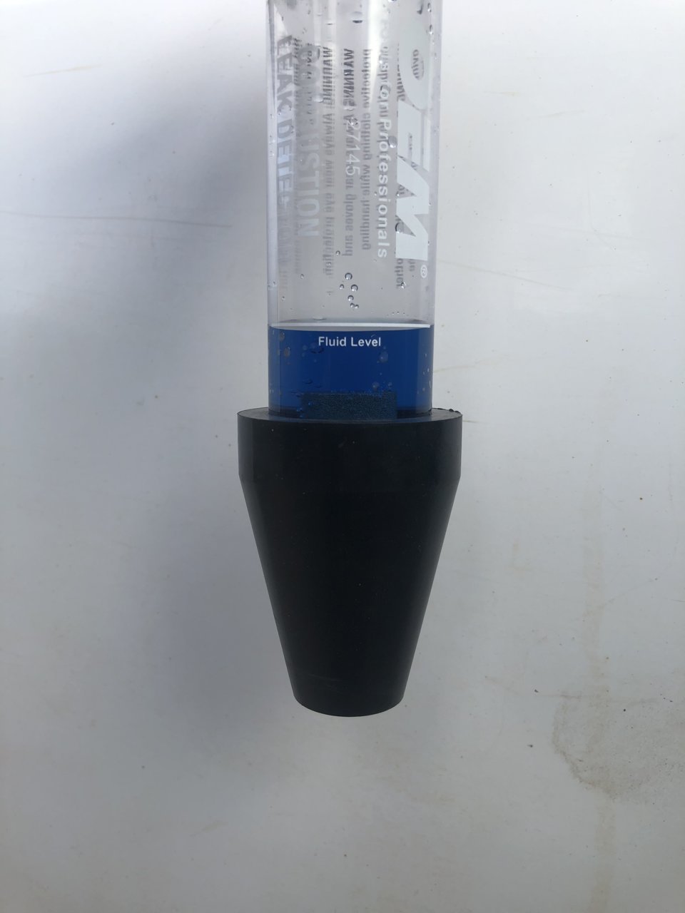

    Well, thought about replacing things like the fan clutch, water pump, and all that nonsense. Instead got one of those combustion leak test kits. Changed the test liquid color from blue to a yellow/green. Not looking so hot

    Well that sucks... 32" Hg worth! Sorry dude.

    Check the rad cap and the weep hole of your water pump for leaks.
    If you had a boil over, albeit a slow boil over, rad cap could be done.
    My water pump decided to give up the ghost on me while I was driving to Barstow from Havasu in the middle of summer. 113F outside. Truck overheated and got to 241F. Pulled over right away and shut it down. Use a case of bottled water to top off before limping into Barstow for more water.
    Mechanic said water pump failed, and the boil over caused the rad cap to go bad too. Fan flung coolant everywhere.

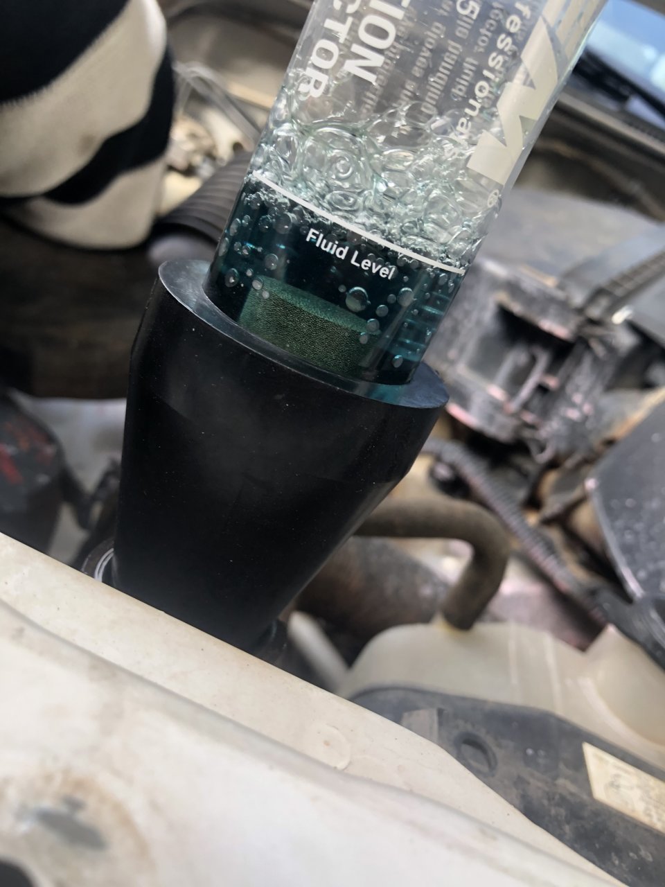

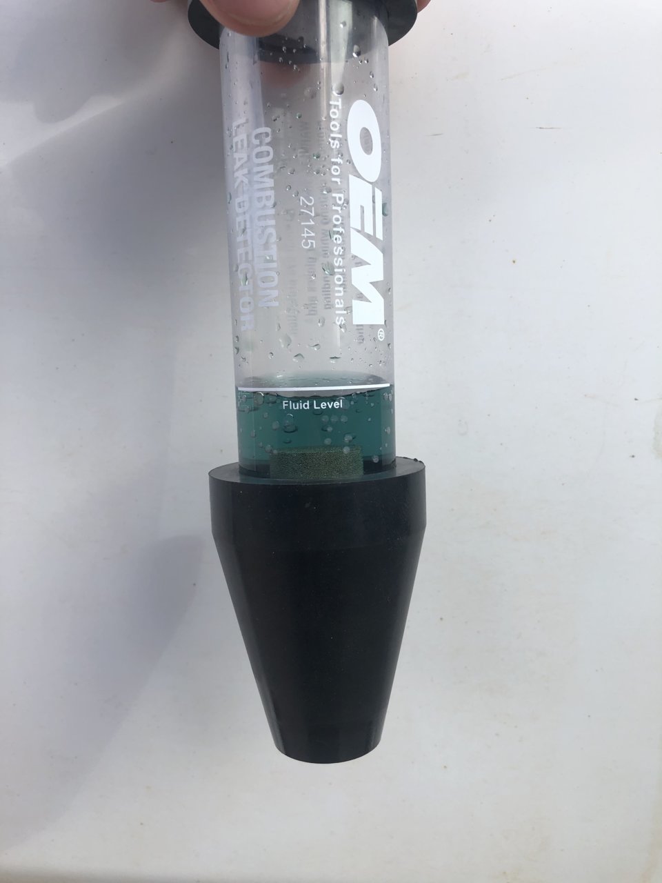

    I’ll do the combustion leak test again too, this time in sunlight and not just with a flashlight then post pictures to see what y’all think

    time to test
