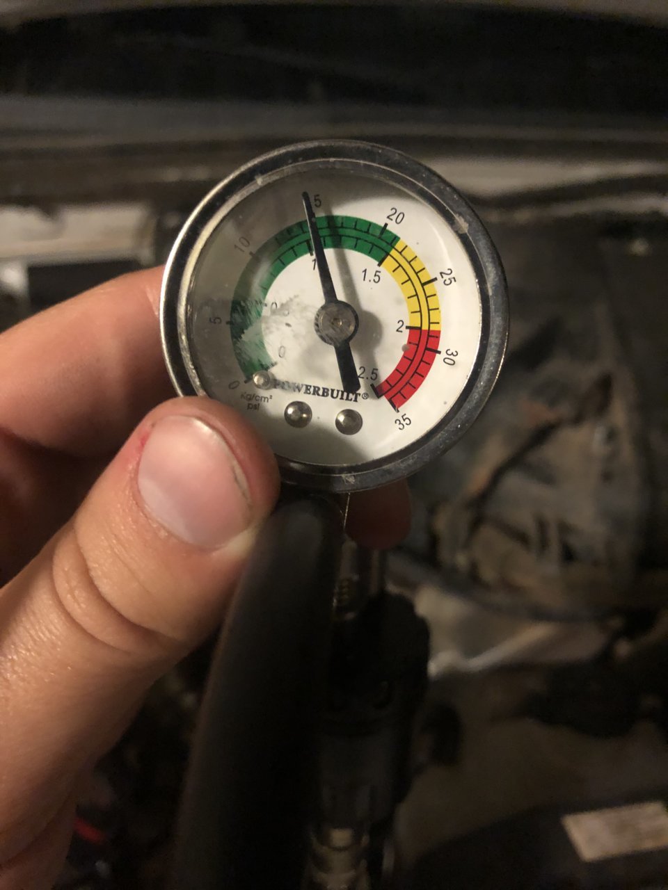

    Hasn’t moved from this level at all even after letting it sit a while
