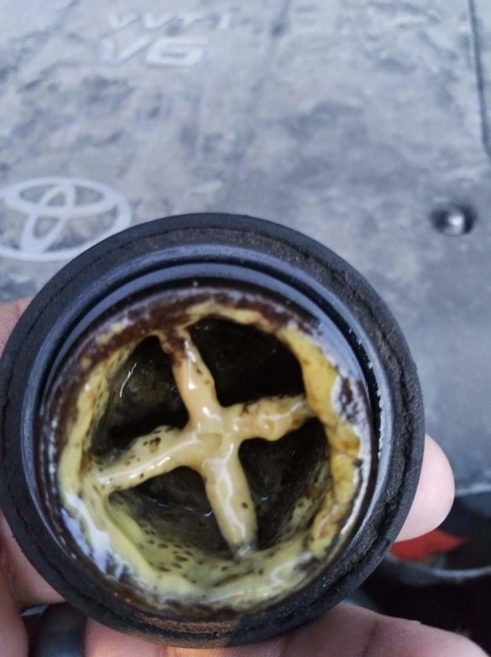

    My 2005 has 255,000 miles and Friday it started overheating. Mechanic came to look at it and said gaskets need to changed or water got into engine. Saturday I showed another guy that it was overheating, and it didn't over heat. So, Later on it didn't want to crank. I removed the oil cap and it has yellow foam on it. I want to know what to look for next and honestly is it worth fixing? Thanks

    is the foam on the dipstick? RIP

    Being a 2005 ya hate to say it but probably head gasket. Trying to find a low-er mileage replacement engine might be a cheaper way to go than doing a HG repair, depending on your skill level/the shop you choose.
    Get a proper mechanic to check it out, look for exhaust gasses in the coolant (bubbling), coolant in the exhaust (white sweet smoke), low coolant levels, contaminated oil, or if you want to get more involved do a compression and leak down test. Probably going to be the #6 cylinder if I remember right? (someone will correct me here hah)
    Foam-y oil doesnt mean much to me, given the time of year, and especially if you aren't taking long trips and getting the engine up to full temp regularly. I get that occasionally just doing trips around town. Moisture condenses and foams up in the cap.

    There are some simple things you can do meanwhile so we can help you sooner. Like answer Jimmy’s question above?
    When you turned the key what happened?
    nothing?
    Clicking?
    Cranks (starter turns engine) but no fire?
    Fires up but won’t stay running?
    with a cold motor pull off your radiator cap and look in there? Is it full as in touching the bottom of the cap? or is the fluid level low?
    your oil filler cap is not indicative of anything, pull the dipstick and have a look or better yet, take a pic of that and post here.

    The stuff inside your gas cap is normal. Its from short trips and all, very common with these trucks. Tons of posts on facebook pages i follow.
    As for the other stuff. Look into the small stuff like thermostat maybe, water pump as well. Think those could help if I'm not mistaken that i have read over time
