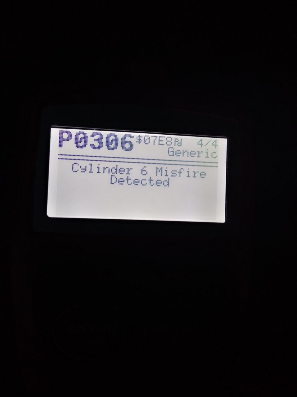

    I removed the spark plugs and didn't see anything but still won't crank but now this comes out

    That only means it detected a misfire on cylinder 6 while it was running, a misfire itself will not cause overheating or engine seizure.
