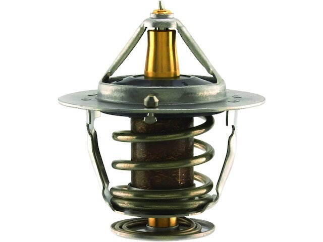

    Everybody started out at the beginning, asking questions & reading is how we all learn.
    The important thing with the temperature gauge is that the hand goes to and stays at the same place on the gauge every time you drive, it should be quite steady & predictable.
    The engine thermostat (example below) regulates the coolant flow to the radiator and is constantly adjusting to maintain the design set point operating temperature of around 195 degrees.
    In operation the engine temperature does wander around a bit however the factory gauge is calibrated with a fairly wide "dead band": the amount of input change required before the gauge actually moves.
    The reason for the wide dead band is that a more responsive gauge would have operators (customers) constantly asking "why is my temperature gauge moving all the time".
