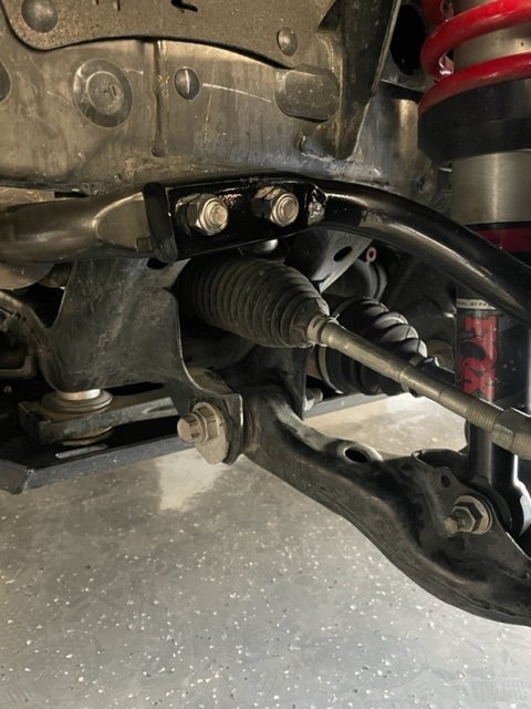

    Here is my setup. I made a two piece sway bar from two separate bars. I ground the mating sides to fit flush and to get the same width as the stock bar. It takes me less than 3 minutes to remove the end piece. I got the idea from a post in an FJ forum. I don't understand why no manufacture has produced one for sale.

    I love this idea, how did this work out for you, still going? I had no problem with my sway bar totally removed but I'm towing now and will be needing it so looking for another solution. I thought about installing the overland links once on location and removing them when leaving, that would be way easier than pulling the whole bar every time.

    great idea I’m going to do this. Do you just pull the bolts and run it, or do the split pieces bind when disconnected?
