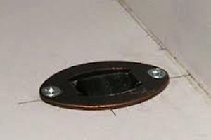

    I found some pics of the caster/rollers that the truck vault uses.
    Back:
    Front:
    I haven't found any online yet but I did find something similar from this company http://alwayse.co.uk spec sheet attached.

    Yeah , I've sourced some side mounted casters for the back as well as the ball transfer bearings
    I may actually go with UHMW runners and rear casters

    Mounted on the case , the drawer would slide on them , 2 side mounted casters at the back of the drawer on each side about 12" apart that ride on the top of the case
