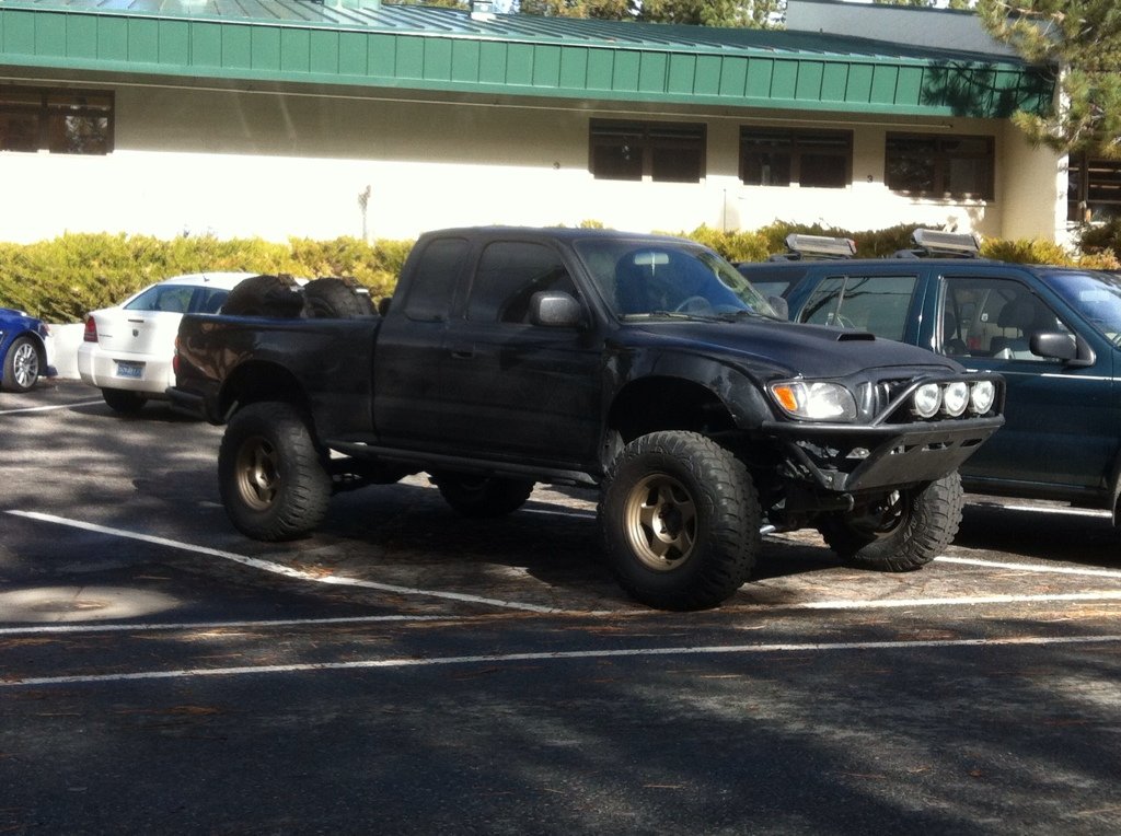

    Just don't use deaver f55's or f67's. Don't know what kind of load you carry, but I changed out my rear springs for the same reason. The f67's just don't hold up to the extra weight.
    That said, you have a couple options. You can call up Deaver and get a custom pack made based on the weight you carry. They will essentially be the same length as f67's, but the leafs will either be thicker or extra leafs added in.
    I ditched my Deavers and went with the All-Pro/Engage 50T spring pack. Just to give you an idea of ride height, this is 2 full size spares, 10 lb CO2, tank, 2 Ton aluminum jack, 10 gallons of spare fuel in NATO cans, and two pelican cases filled with spare parts, misc tools, and random shit. I've got 8.5" of uptravel and 8" of downtravel with this load:
