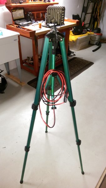

    Didn't know where to post this but, wanted to post an easy project to light up camp. I've seen plenty of pictures camping with light sticks and had every intention of putting one together. Although it's not original by any means, I had most the parts around the compound.

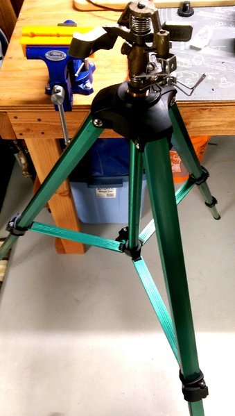

    The original intent was to use a telescoping paint pole(and eventually will) and put a light on it but, when feeding animals I found a telescoping aluminum tripod sprinkler that folds up and gave it a try.

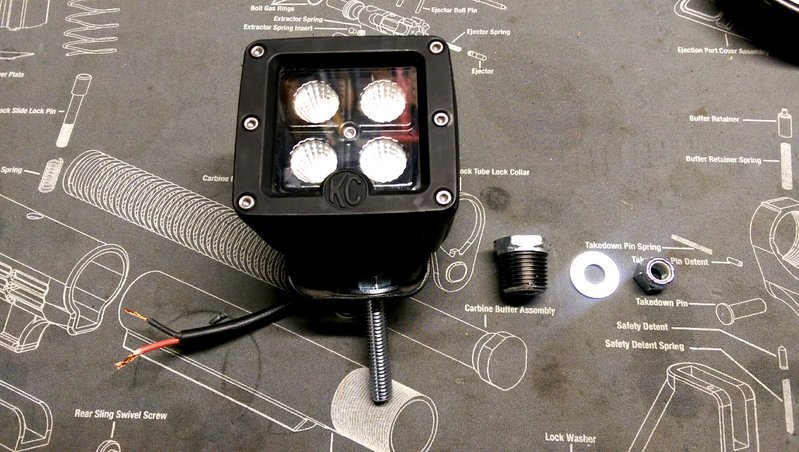

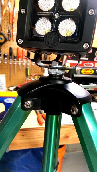

    So, I unscrewed the sprinkler and figured that I could mount the light on a threaded pipe. While out and about I found a 1/2 x 1/2 galvanized piece(see pic) that would fit perfect. I have had a couple of 3" LZR KC lights that someone here(an old friend) sent me that I never got around to using. I mounted the light on the pipe with a bolt and nut that would fit into the threaded hole as I screwed it in.
    Screwed in perfect

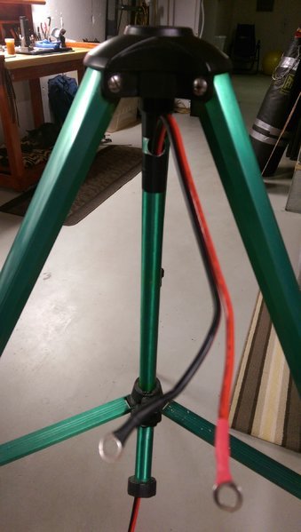

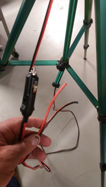

    For the wiring I bought a 10ft 12V Cigarette Adapter cord on Amazon for 10.99. I drilled a hole in the center tube were a hose would normally attach and fed the wire through it.

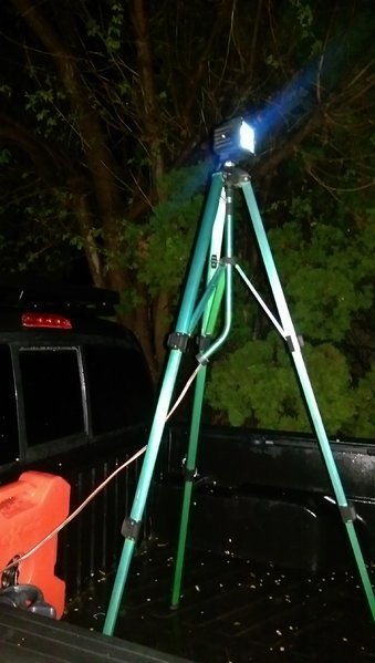

    Anyway, long story still long, worked out great for having most of the material and not spending a ton. I suspect if you don't have a light any ol' Blitz Pro or cheaper Chinese led would be a solid choice for a cheap project.

    Seems to be a good idea, Mrs Ho and I have actually talked about solar lights but, I have had such shitty luck with low level solar lights in our landscaping, always seems cheap and the lights fade. Although, the YouTube videos seem to be pretty solid on innoGear.
    I think I ran across that in my original search, interesting idea for sure and lightweight. Easily could make your own - rod, led, power cord and use a ice fishing rod holder
    Like I said in my original post, that was my original plan as I saw a light pole write up on Expo, Mudd or ? I planned to just quick fist them to the rear bumper or a table leg in camp as well.
    In fact, I just ordered another cigarette adapter from Amazon and will be off to find a telescoping pole this weekend.
    I am fairly pleased with the tripod as it is a bit more mobile.
