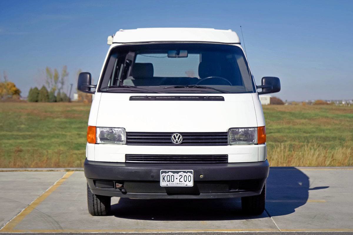

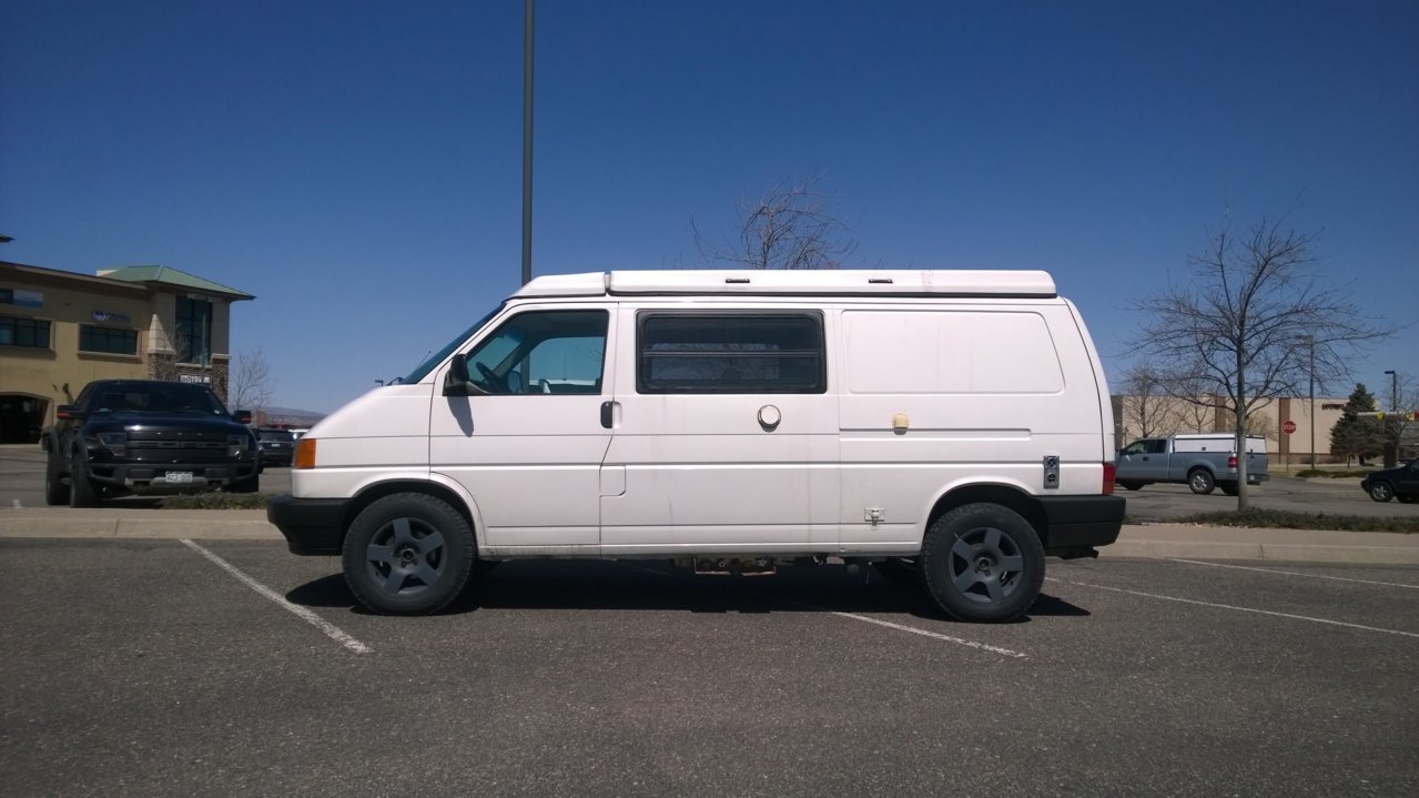

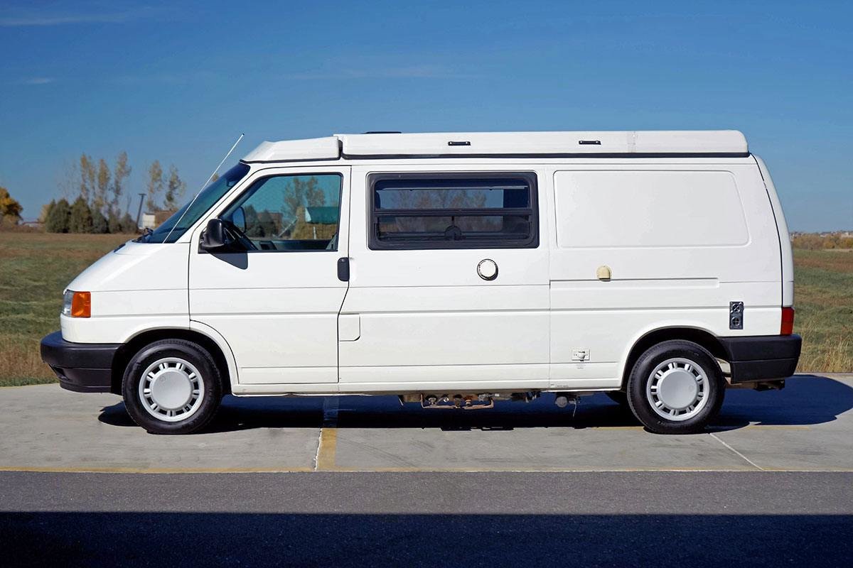

    Before/After lift, 1995 Eurovan Winnebago camper. Crappy pics, but you get the idea - spacer for the rear coil springs and adjust the front torsion bars up. Got 2" in the rear, only 1" up front, center hub to fender. The big deal was to get the LP tank more ground clearance, got 2.5" more with 16" rims.
    Went from 205/65/15's to 225/70/16's, used Audi 16x7 rims and Hankook Dynapro RF10's. I talked to a local expert and 225/70/16's are the best one can do without extensive suspension mods.
    It's a nice camping/glamping/overlanding unit. FWD only, but I figure it will do fine moderate offroading. I like it better than a Vanagon, Vanagon has that loooong front porch. Eurovan has a short front porch for better approach angles.
    EDIT: I can get more front lift by cranking the torsion bar nuts up some more, but CV angles . . . .

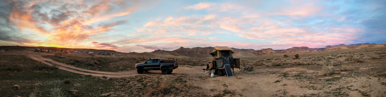

    Spent some time around Fruita, CO testing out the trailer I built.

    Small world, you can all but see my truck in that photo! I was the white tacoma that slow rolled past your campsite every day this past weekend at 18 Road. I meant to come talk to you about that trailer, but the guy in the dodge/camper I shared camp with was from BC and just did 5 weeks in Baja so he kept me distracted. We were like 100 yards from each other.

    Yah small world! I was shocked how packed it was out there. Must have been 50 vehicles in that little valley below the mail campground where we camped.
