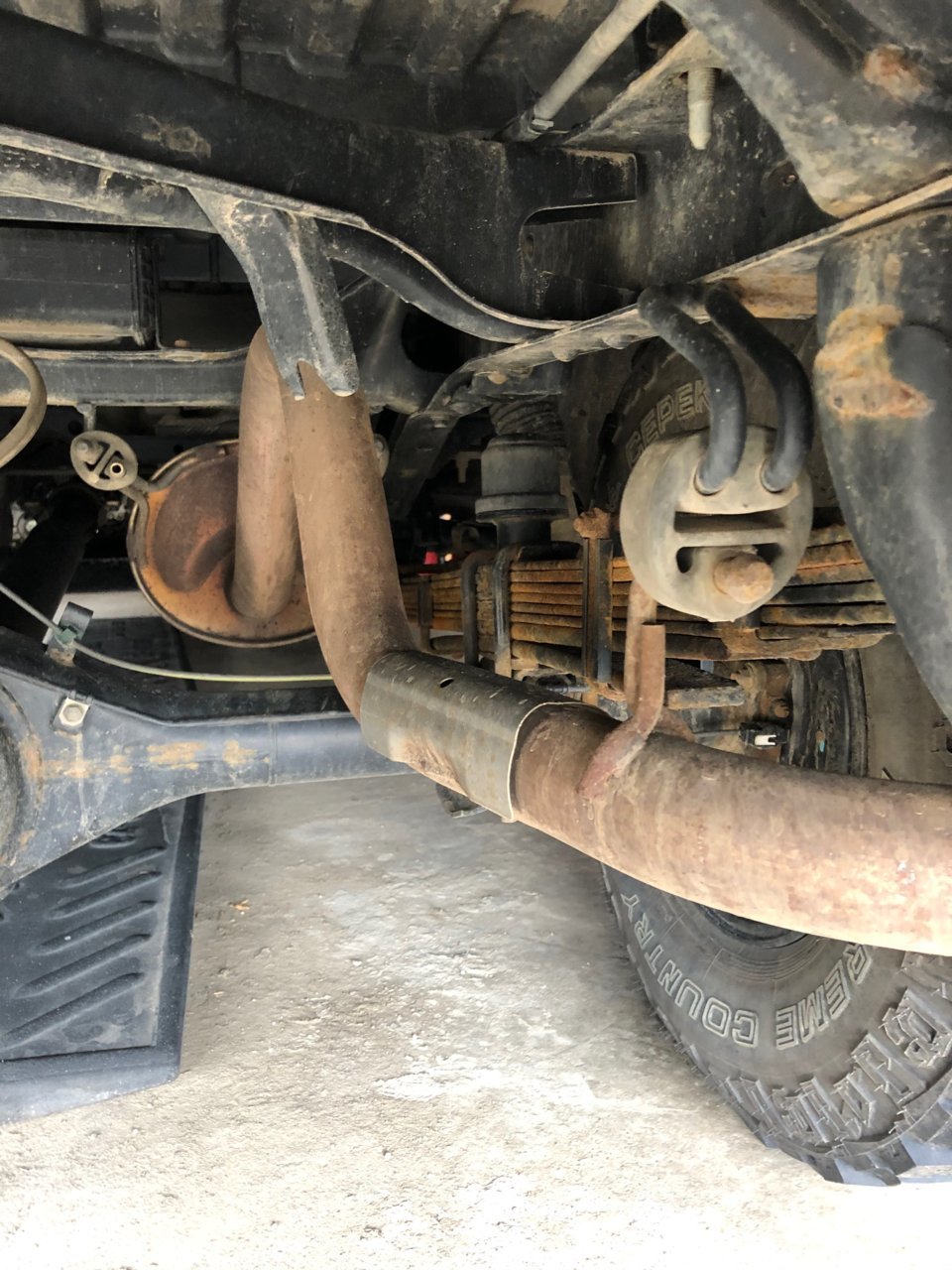

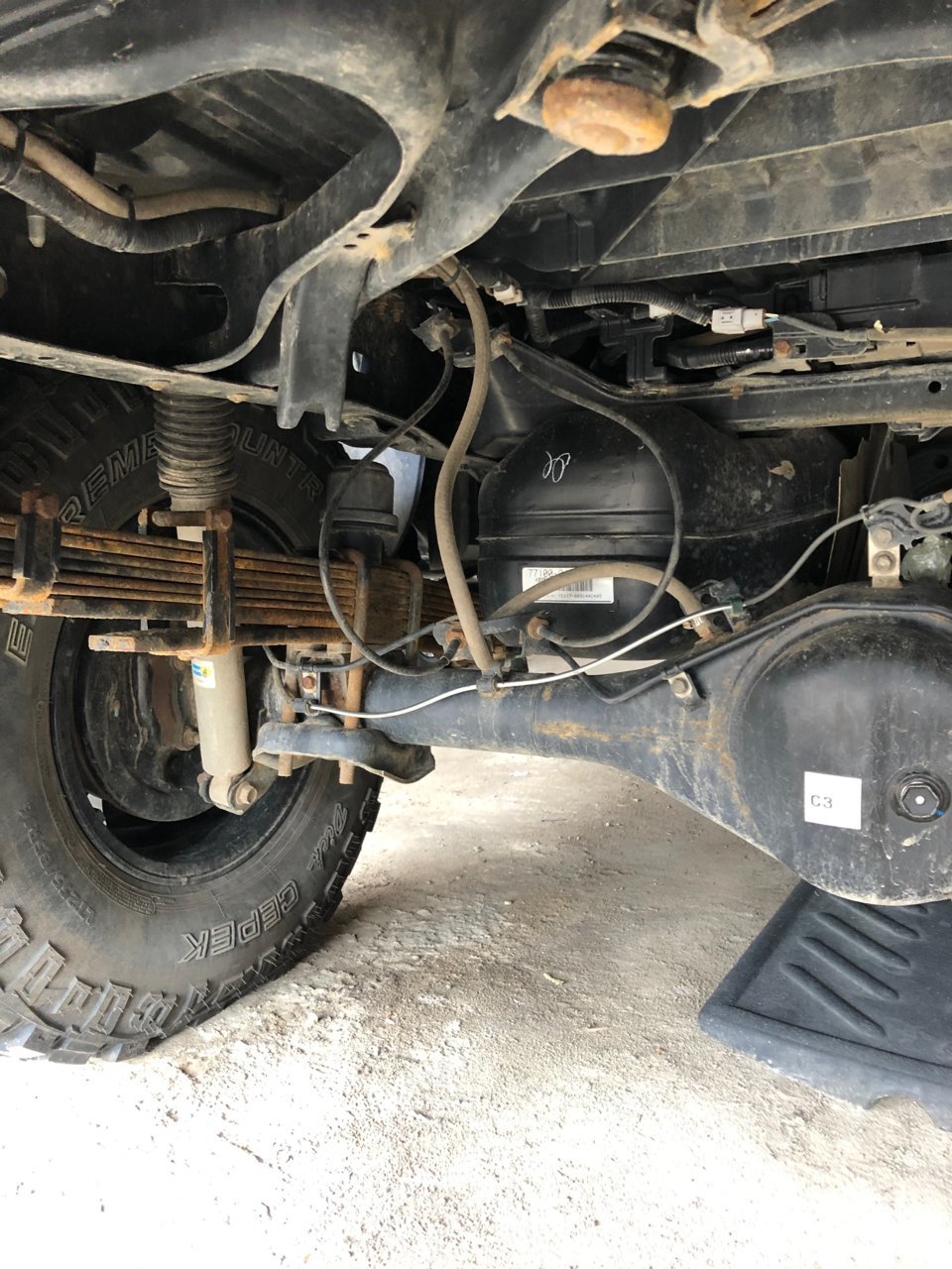

    Quoting myself to add some updated hypothetical pictures and hypothetical weights. Hypothetically most of the camping crap plus a bit more stuff is in the truck so I could take some pictures and weigh the piggy. My guess is that the truck is at 95% of the hypothetical camping loadout. As you can see the Dakars + aal are more negative now. Also looking for advice on which Deaver Expo pack would be best. I'm still thinking the stage 3. Front- 1320kg, rear- 1590kg, total 2910Kg.

    My weights are: front 2910lbs, rear 3505lbs.
    You think Deaver U402 stage 3 will be enough? I've contacted Deaver and am waiting for a reply but I'm not sure I'll get a response since I've read that they're customer service is lacking in that respect. Not sure you'd have better luck since I'm trying to figure out if the stage 3 will be enough or if I'll need to have a custom pack made and shipped up.

    Yo sorry, I read your other post a few days ago, but was super busy and forgot to respond!
    Sounds like your truck weighs similar to mine when I'm fully loaded for a trip. You're basically at the max weight for a stage 2, and minimum weight for a stage 3, so it's an awkward spot. If you prefer a firmer, taller ride, then stage 3, or if you want a slightly more cushy ride with a bit less height, the stage 2. You could always get the stage 3, and if it's too stiff, pull a leaf out.

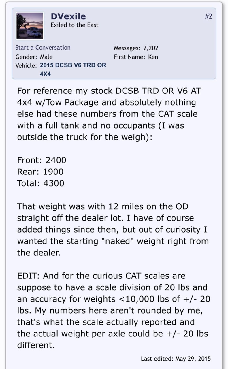

    No worries about the reply. I’m not sure how much the truck weighs stock so I’m not sure how much I’m over that. I’m also likely a little on the light side as I didn’t have everything loaded in the truck when I weighed it. If I’m still within the stage 3 limits I’ll be going that way. Basically I’m just trying to confirm that I’m not over the stage 3 weight (700-1000lbs). And I’m hoping they won’t look like my Dakars do (in above picture) when fully loaded. I also won’t be fully loaded all the time but likely at least half of the fully loaded weight.
    Someone posted the below numbers so that’s what I’m using as a general reference.

    Yeah, that looks accurate. The DCLB (what I have) is a bit heavier than that stock, by around 150-200lbs.
    I would say the stage 3 should be good. If you're too heavy for the stage 3, then you might want to start looking at a full size :p

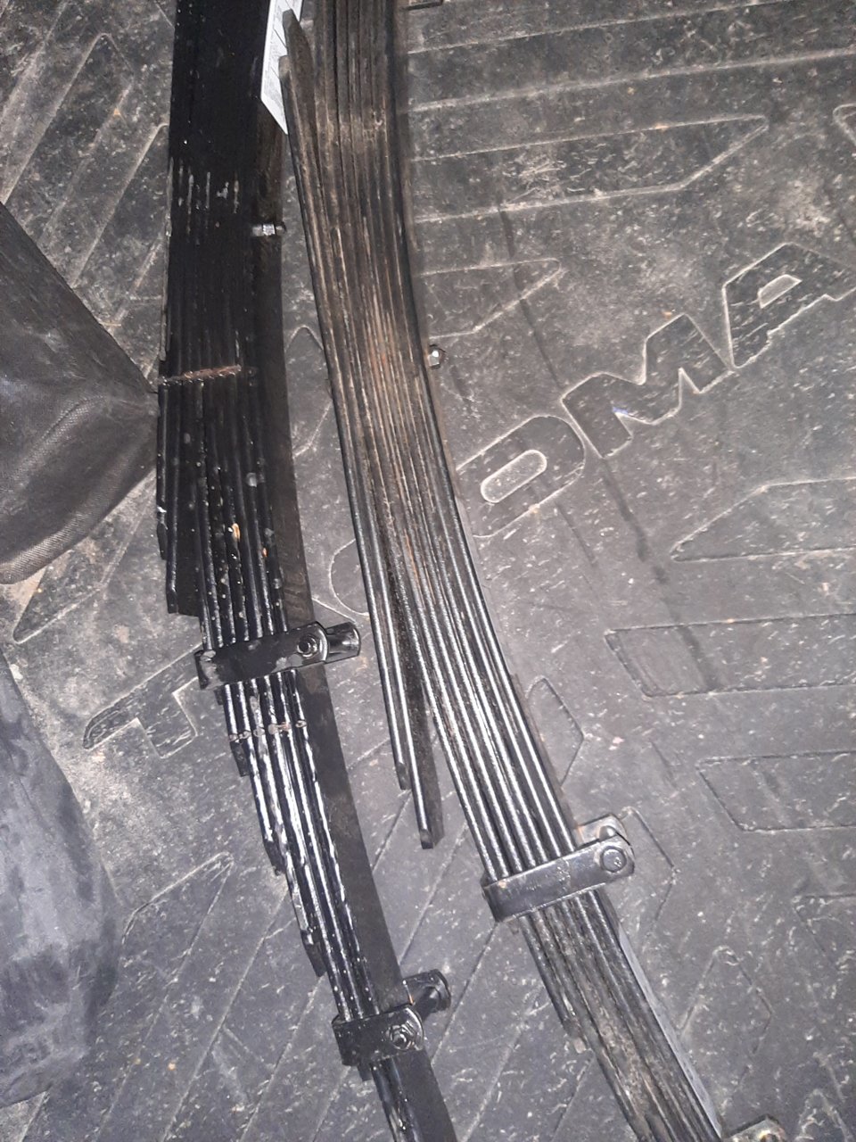

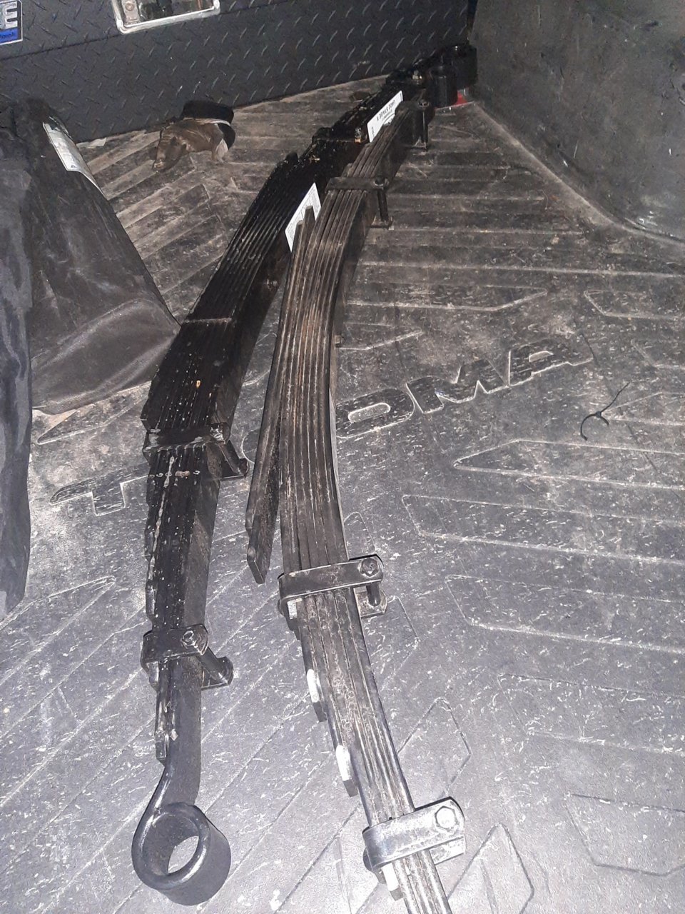

    @Sna
    Here's what the stage 2s look like I just picked up from overland

    Those look great. I did get your email but I’ve been busy with work and haven’t had a chance to reply yet. I’m still not sure what I’m going to about my rear leaf packs. I’m worried that the stage 3 will not be enough and have contacted Deaver 3 times to get their input on it but have heard nothing back. Plus I’m still waiting on my drawer system and will not know my actual weights until then. I’ll likely pass at this time but if I change my mind I’ll contact you. And I’ll keep contacting Deaver to see if the stage 3 will be enough or if I’ll need a custom pack.
