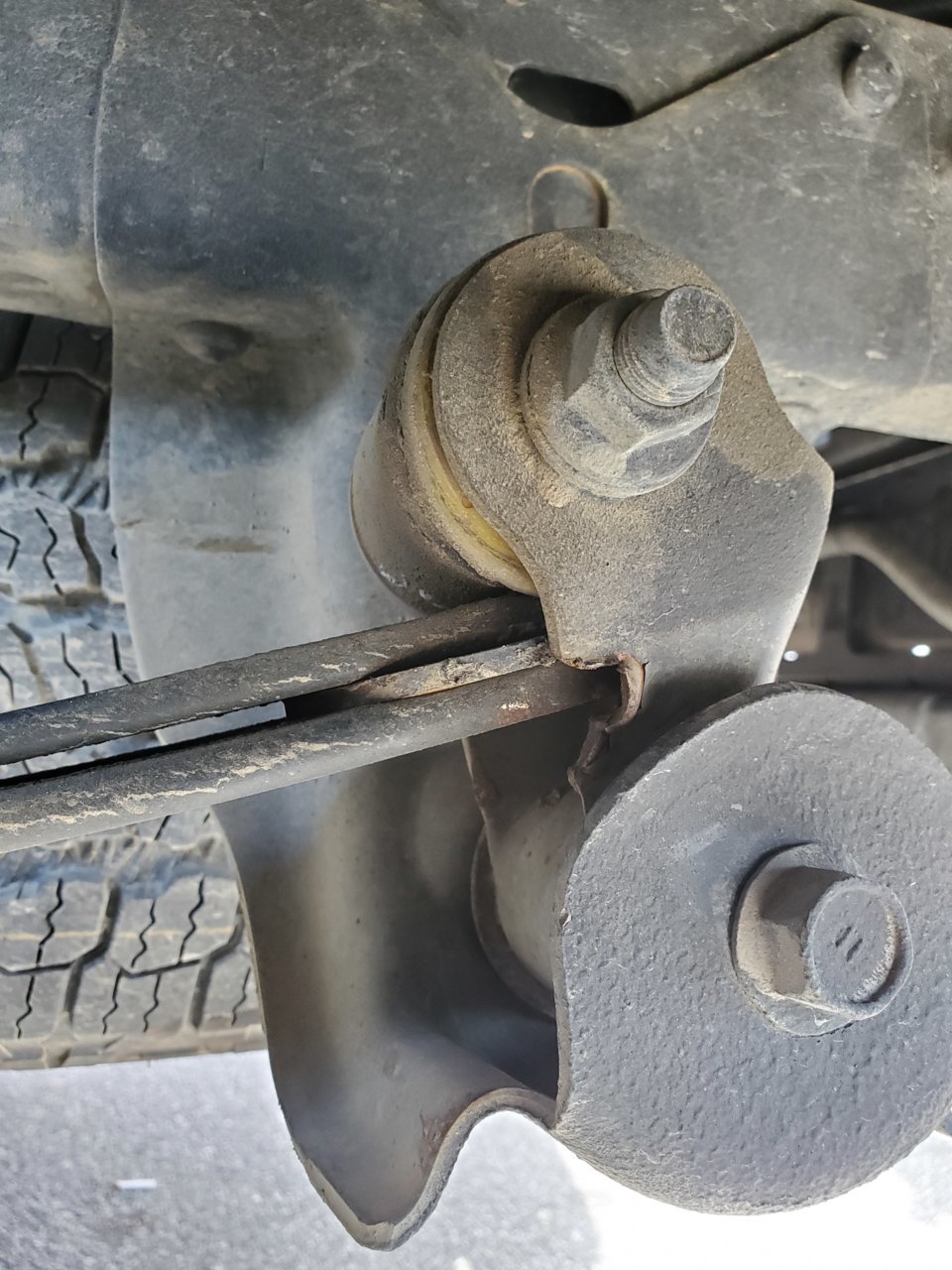

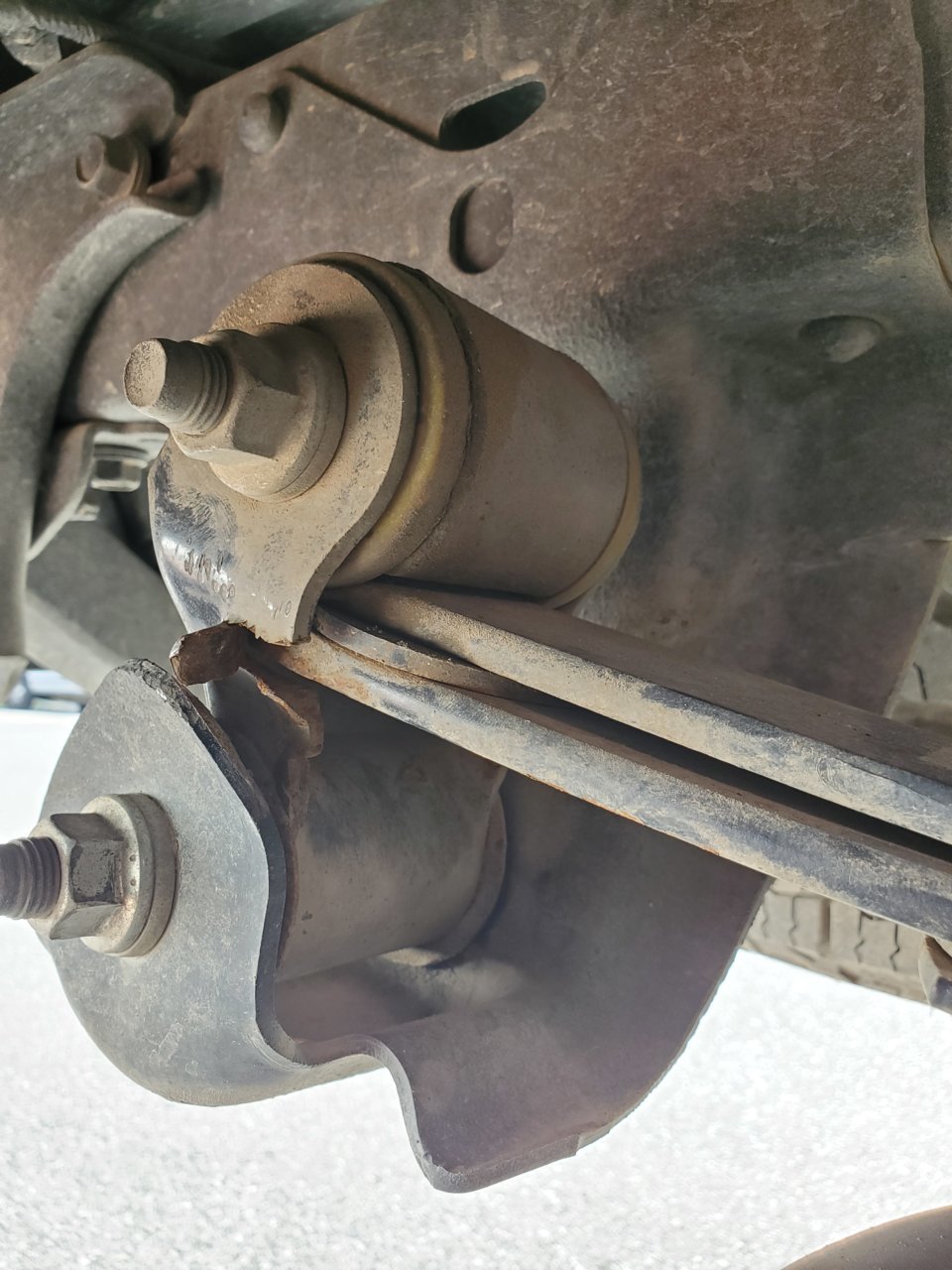

    Here's one of several reasons why we don't recommend Dakars... They rub the shackle, and in extreme cases:
    Going to put @ARCHIVE hammer hangers and 3.6" shackles, along with either icon or Deaver leaf springs on this truck
