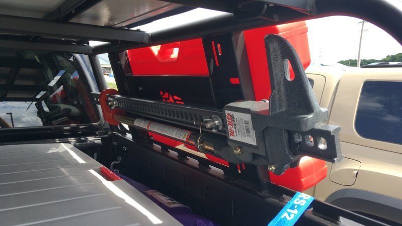

    I bought this JK hi-lift mounting kit.
    https://www.amazon.com/gp/product/B00FMOJZHS/ref=oh_aui_detailpage_o01_s00?ie=UTF8&psc=1
    ... and I should be able to make it work. I just wasn't expecting this hi-lift to be so gdman heavy, and I'm wondering if this mounting kit can take it. The kit was meant to be mounted vertically, on the hood... but I'll be using it horizontally. Sideways.
    I'll probably have to drill into the rack to get this to work - but I'm okay with that for a hi-lift.
    I'll report back.

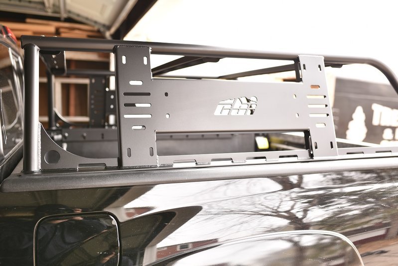

    @CBI Offroad Fab - I see lots of Rotopax on this bed rack but how would you mount Maxtrax on the side? The mounting pin holes don't line up with any holes on the side of the rack...

    With a drill they do.

    I'm currently not planning on mounting TRED's or Maxtrax there anymore... but I did hold up my friends Pro's to the mounting slots, and it looked like they lined up fine. The Pro's are longer than the 1100's. They also have 6 mounting holes as opposed to 4.

    Thanks for that. So the five "slots" on each vertical side support should be the same width as the TRED Pro dual mounting pin holes which should allow for the TRED mounting brackets to be used?

    I go my CBI rack back in August 2015 and I has the same issue of the mounting bolt holes being to small. I had to drill mine out. Told the guys @CBI Offroad Fab and they said they'd look into it. Apparently they did not. I love the rack. Had a CVT on it for a while but now it has a yakima basket on it as I sold my CVT.

    Well, he doesn't use the mounting plates, so I can't speak to those. But eyeing the holes on the TRED Pros, I saw open slots directly behind them, so you'd be able to bolt them to the rack pretty easily.
    Actually, my friend does have the Pro mounting plates, and a couple months back he said he hated them because the TRED's flopped around a lot (while mounted on the side of his bed rack). Apparently, according to TRED, the mounting plates are only supposed to be used horizontally. :rolleyes:

    Just got my rack about a week ago. I see what you mean about the holes being small (top ones for the cross bars). I didn't have to drill, though. Ratcheting the bolts got them through.
    The issue I did run into was that the bolts for the bed rails were too short. Or so I thought. They wouldn't reach the nutsert bracket or would push it towards the back and wouldn't grab. To solve this, I just bought a 3" bolt and threaded it in one side, pulled on it to thread the other side. Once that was on, it was a simple matter to remove it and thread the other bolt on.
    All in all, a pretty nice rack. You can barely see the crossbars in the rear view mirror and I don't notice any wind noise at all, even with the windows down.

    Added the hilift before the weekend trip. Had to drill out the 'slots' on the rack a bit and then used 1/2" bolts, wing nuts, and washers. Like with the other side of the rack I cut pieces of wood that fit into the vertical beams. Basically they act like giant washers. I like to think it relieves a bit of stress on the rack. They're painted black so probably hard to see in the picture.
    I also added some rubber edging so the hilift isn't pinned up against metal.
    The hilift itself rattles quite a bit, but the mounting is super solid. Very happy with it. Especially for about $20 in hardware.

    No, that's one of the main reasons I went with this rack. It's as low as a rack can get for rotopax + RTT. It's close, but no clearance issues.
