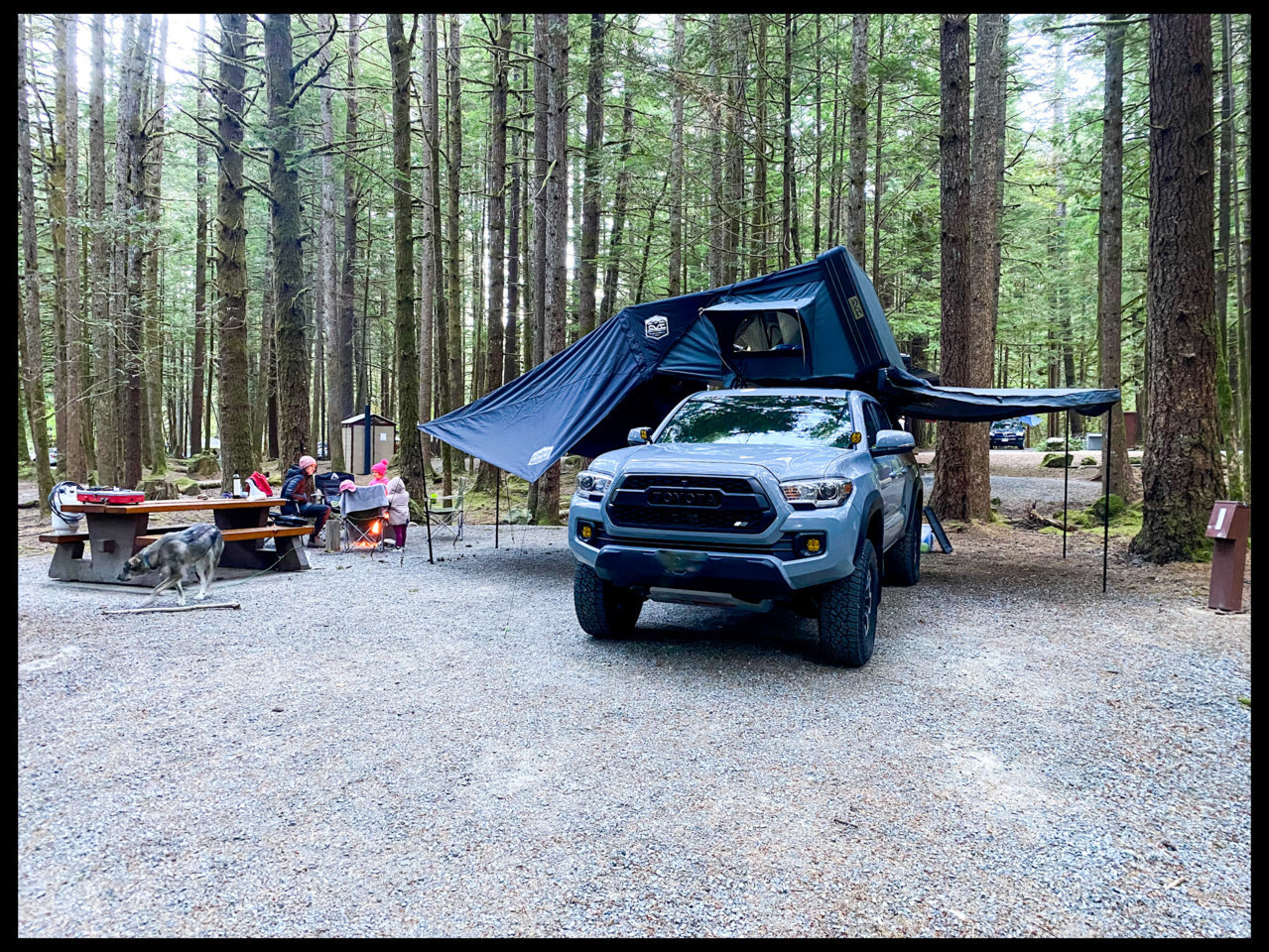

    I have a 21 DCSB I run:
    Rsi Smartcap EVO - 220lbs with cargo bars
    CVT Mt Washington RTT - 210lbs
    270 Batwing Awning - 80lbs with mounts
    610lbs of gear FT (including fridge slide)
    others
    Dometic Fridge 55 - 60lbs (100lbs when full of beer)
    Fridge slide - 100lbs
    Battery Pack - 50lbs
    Trd Skidplate - 80lbs
    Suspension changes
    Elka 2.5 with DirtKing UCA’s
    Your Armour will be a bit heavy… whatever. You live once.
    I would agree with others though… get as minimal as you are comfortable going,
    Less money up front; far less to unload and pack.
    Especially if you are “overlanding”. The RTT was designed to be opened, slept in and the moved. We use ours for multi day static trips cuz of little kids.
    I would think a tent, fridge and battery pack,
    Some lights and a Mesh Tent, bathroom setup, fire extinguisher and the typical camp gear (stove etc, would do you well).
    enjoy your truck! That’s really the most important part.
    As my picture implies… I’m not even afraid of hitting a busy campground.

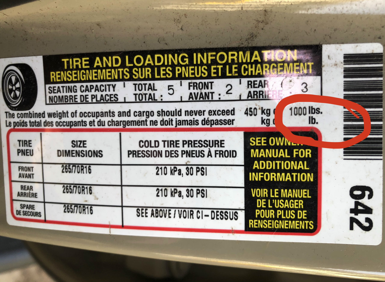

    The sticker on your driver's door jamb will give you you're specific payload and I can almost guarantee yours doesn't say 1155lbs. If It's a SB Off-Road, it's probably 1000lbs minus the little yellow sticker subtractions.

    No 2 trucks are the same. The GVWR is the same. They actually weigh the trucks as they roll off the assembly line and subtract actual weight from GVWR to determine payload. It depends on the options on your truck. The heavier the truck, the less payload you have. My 2007 DC 4X4 TRD has a little over 1200.
    There has never been a truck made that someone didn't overload. I'm OK with that if kept close, driven carefully and for shorter distances. As long as everything goes as planned being a little overweight is usually not a big deal. But sooner or later something unplanned comes up and you have one of those "oh shit" moments. When that happens, you will wish you had a bigger truck, or a smaller load. Remember people are part of that payload. A skinny driver and one skinny passenger will be 300 lbs. If you have 4 grown men in the truck that could easily be 800-1000 lbs.
