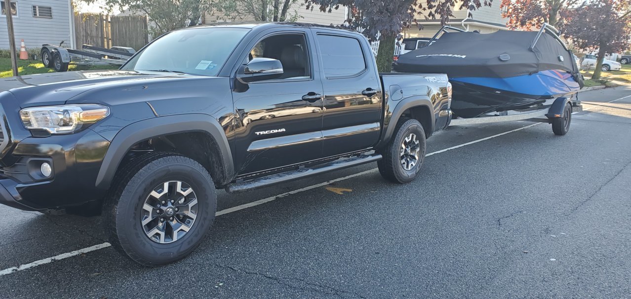

    I went to bring my boat to storage today and the truck sags a little with boat and full tank of gas. The pictures below are with an empty tank and ball mount with a small drop. After I filled the tank with gas, the chains were dragging a little. Definitely is going to be worse when I fill up with gear and put the tent. Looks like im going to need an AAL or air bags. And a ball mount with less drop

    Do an HD leaf replacement. I have OME HD. I have about 300lbs including 120lbs rtt and I’m not sagging.

    If you do Air bags, look into the Daystar Cradles so you can maintain suspension travel. Another option might be Sumo Springs. However, my bed was sagging with fiberglass shell and tools, but a $200 Headstrong 3-leaf AAL has it sitting well. Your truck is still new enough that an AAL is a good option. If it were older, I'd second the vote for a full pack replacement.

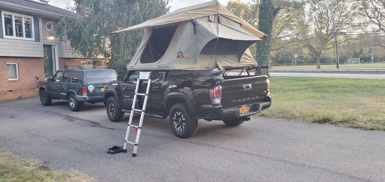

    I picked up a complete used set up from another tacoma owner. thule kukenam 3 , steel bed rack, and 2 thule bike carriers mounted on the sides. We unbolted his entire set up and walked it over to my truck. Im happy with the purchase. Now to buy the remaining essentials and go camping next year. Im excited for the road trip out west!

    I second this option. With the OME HD, I am running 400 lbs and am totally level (3") front.

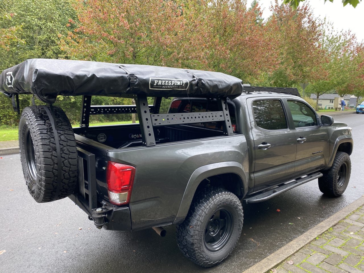

    Here’s a pic for reference on the weight and I’m not sagging at all on my OME HD leaf pack. That’s a dual swing out steel bumper with a 83lb tire hanging off it, tent, and aluminum bed rack.

    I bought a used rooftop tent. For $1100 I got the bed rack, tepui kukenam 3, and 2 thule swingarm trays. I cant wait for next season to do some bike trips.
