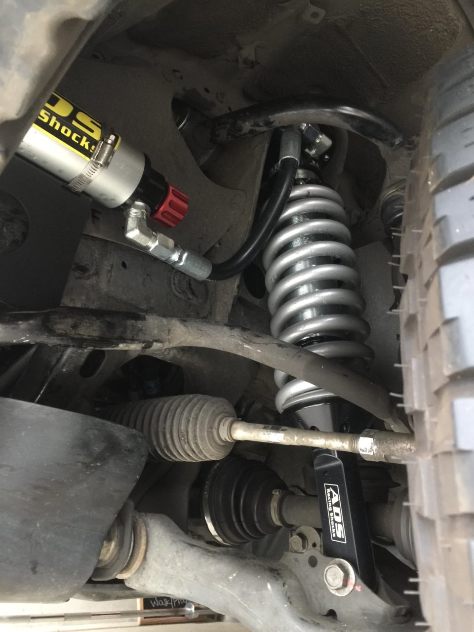

    I see. I have the nitrochargers in the rear until I buy the ADS in December. What do you mean 5-6” of shock?

    I mean actual shock travel. It’s hard to explain it for OE replacement shocks such as any Taco front setup but when you say 12” or 14” shock, that’s the actual cycling number for that shock. There is 12” or 14” of shaft at full extension.
    The OE replacements are only cycling 4.5-5.5” on our trucks in the front.

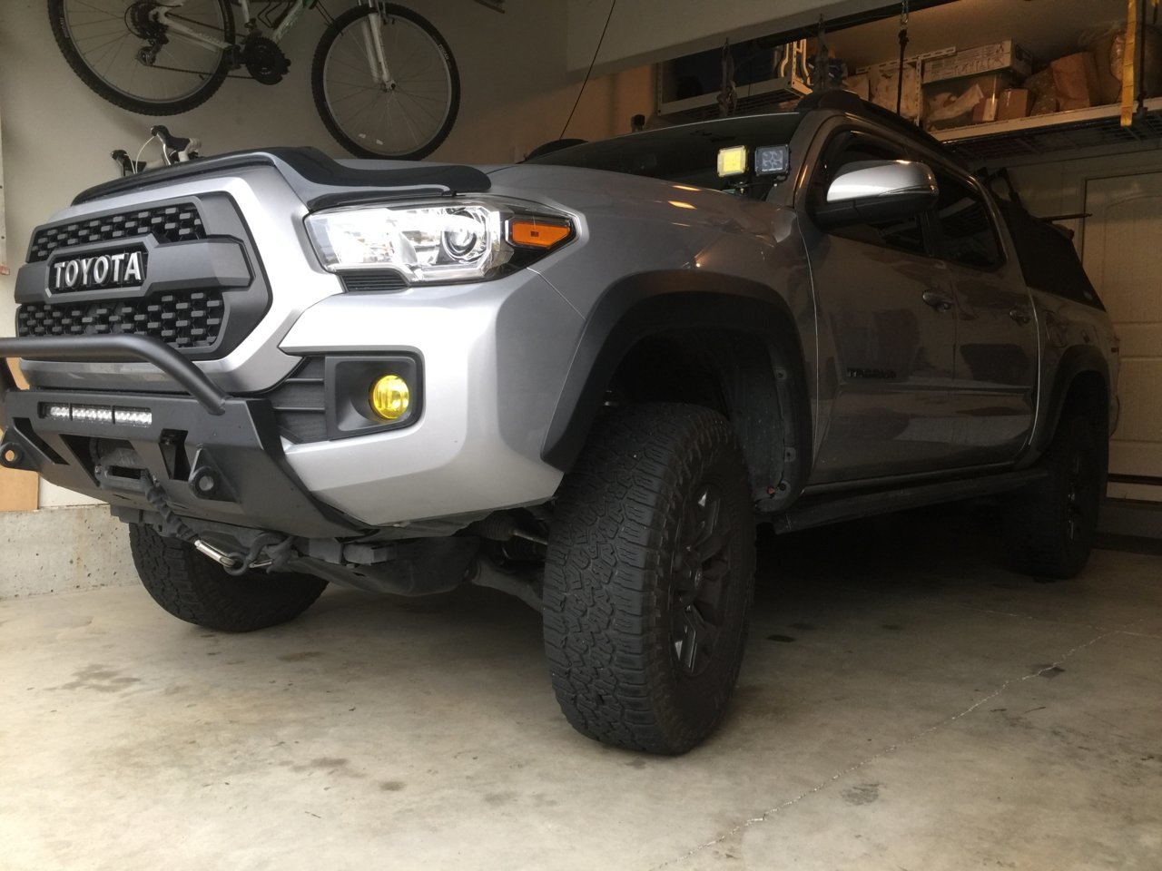

    What kind of SxS and how big a trailer you towing?
    I have some Icon Coilovers up front set at about 1.5" and plan to rebuild them with 700lb springs when I get a bumper, and in the back I have Deaver U402 Expedition stage 3 (2.5-3" lift at 700lbs constant load) and Bilstein 5160s. I've loved having this setup. The springs/shocks in the rear have made it ride better fully loaded with the trailer than with JUST the trailer and a COMPLETELY EMPTY truck bed and stock suspension..
    The Habitat I have on my truck is a constant 350lbs, plus i've got another 250lbs with a fridge and dual battery setup in the bed. In the pic below the bed was packed with camping stuff and riding gear.
    Here is a pic without the camping gear or trailer (still at 600lbs bed weight with habitat and fridge/etc). You can definitely tell the rear end is higher, but the ride with the Deavers is still really nice. My friend tells me the high number of thinner leaves is what helps it ride well without a heavy load, but who knows. I think there are 9 leaves and 2 overloads for a total of 11.
    Deaver has 3 stages of expedition springs, they are 3-400 constant bed weight, 5-700, and 700+ (which I got). I'm REALLY glad i got the 700+. I figured the 5-700 would be enough, but decided what the heck... especially since I tow as much as I do.
