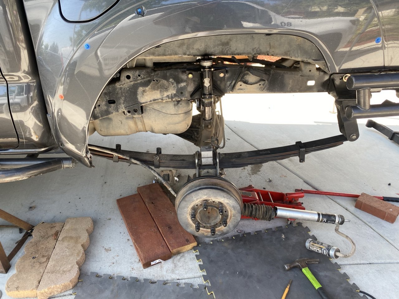

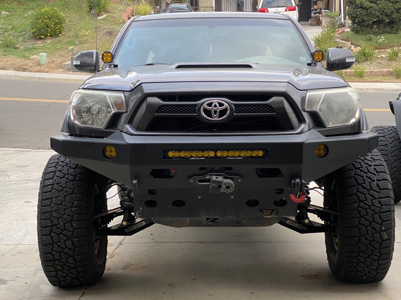

    Well, it sure has been a while! But i figured I’d keep the post going. I’ve gone down a rabbit hole with this truck. Especially since wheeling with guys on 37’s and 40’s.
    So here is the latest.
    my lower control arms were shot, so i recently upgraded to camburg lower control arms and I couldn’t be happier.
    I’m having some steering issues so I’m working on upgrading to heim steering. We will also be installing hydro bumps on the front as well.
    I just finished the rear end and trying to figure out what I’m going to do for shocks.
    Here is the rear.
    Icon RXT, 4XInnovations shackle flip and extended shackles, Icon Hydro Bumps
    for those of you who have needed an extended shock, what are y’all running? And I really don’t want to run a wheel spacer to prevent rubbing on the shock. Help!

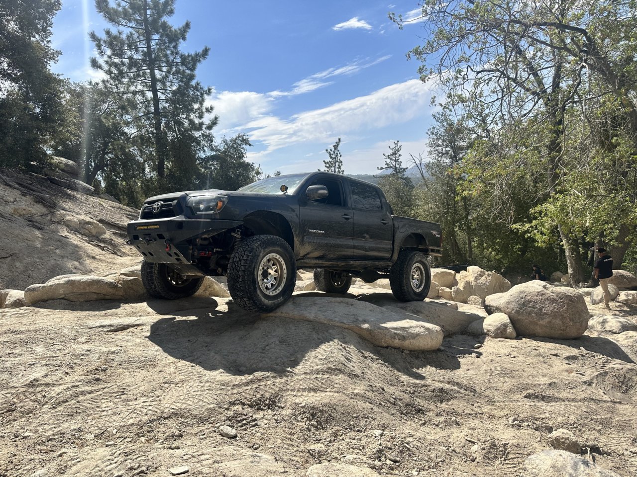

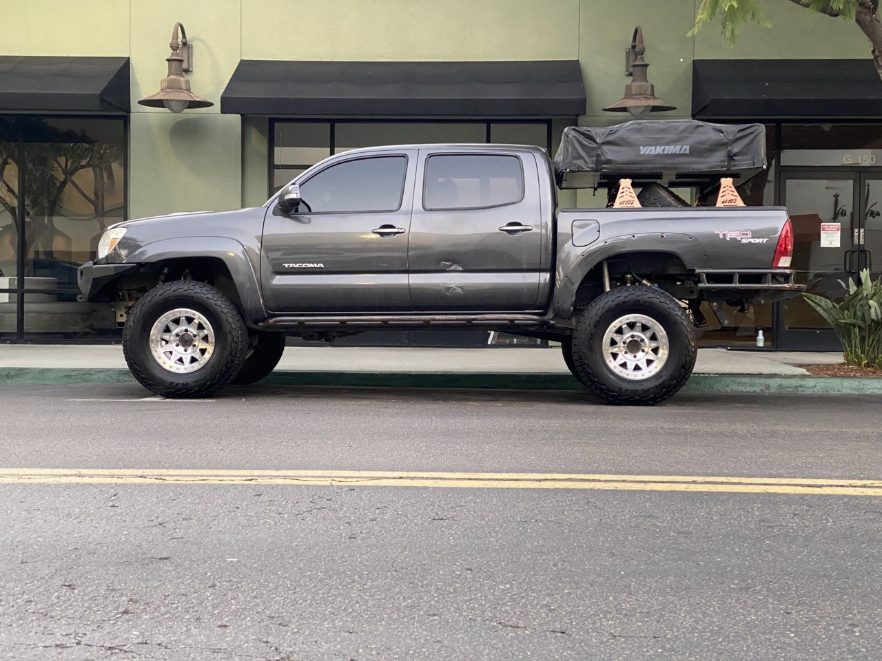

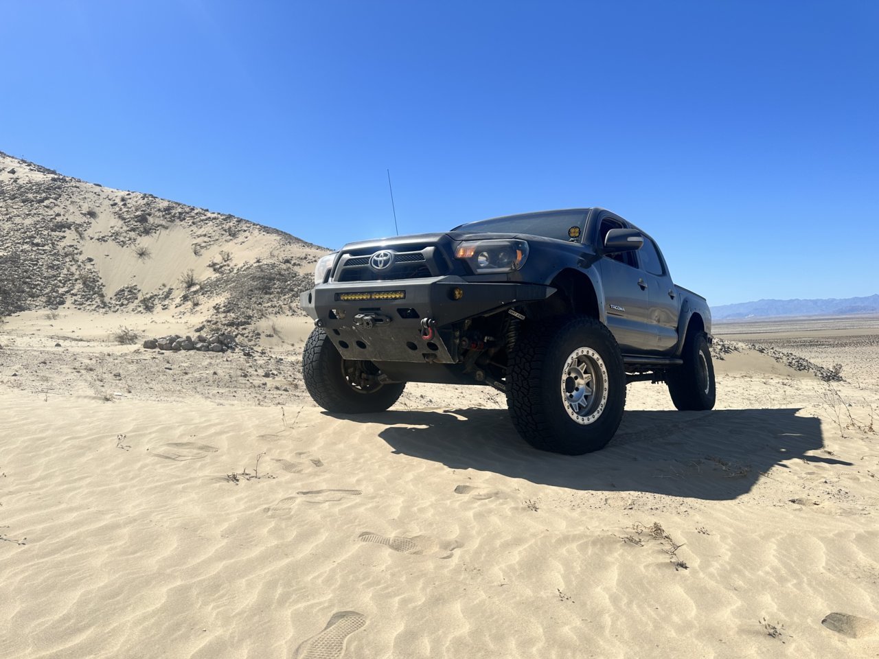

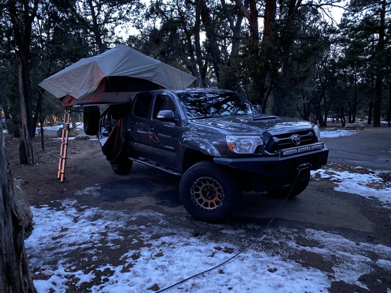

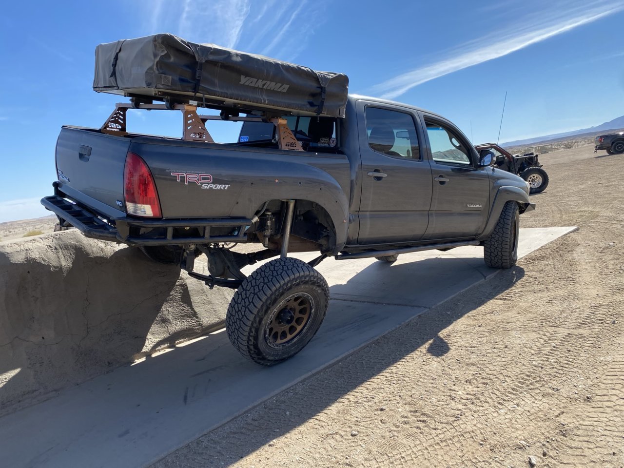

    That’s pretty much it for now! Here’s a few updated images from the last wheeling trip!

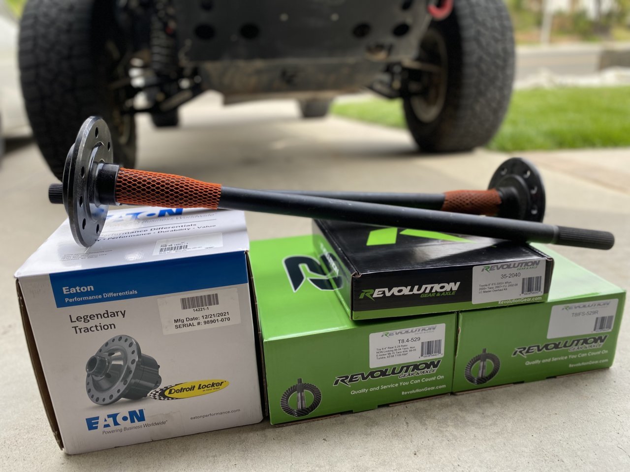

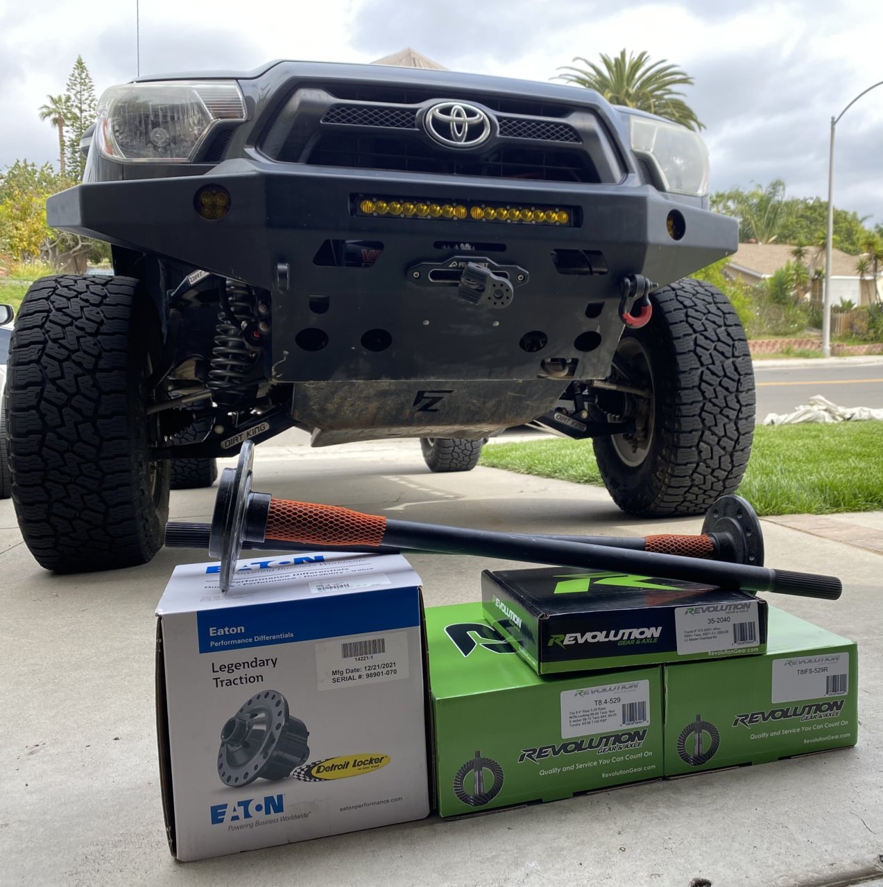

    Well, We have a Moab trip booked for early may, and with jumping to 35’s I decided it’s finally time to gear.
    So I will be pulling the differentials today so I can drop them of to be geared.
    I will be running Revolution 5:29 Gears with an Eaton E-Locker In The Front, Detroit Locker in the rear with Nitro Gear Chromoly Axle Shafts.

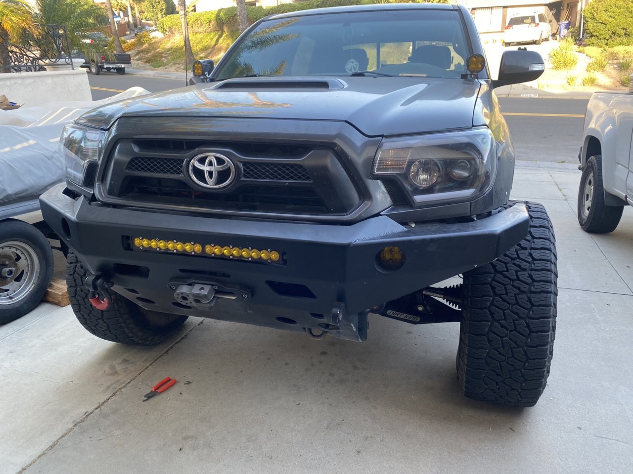

    It’s the little things.
    Got some new headlights installed with a projector retrofit. Pretty happy with the look. I need to adjust them a bit but what a huge difference in look and output
