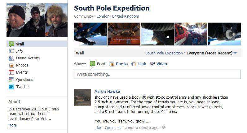

  16. Dec 14, 2011 at 11:03 PM
    #96
    theduck911
    theduck911 Max's Canadian Twin
    Oct 28, 2010
    #45374
    3,925
    Max
    Northwestern Ontario, Canada
    Locked and Geared!
    Nice and friendly constructive criticism, nice:thumbsup::cool:
