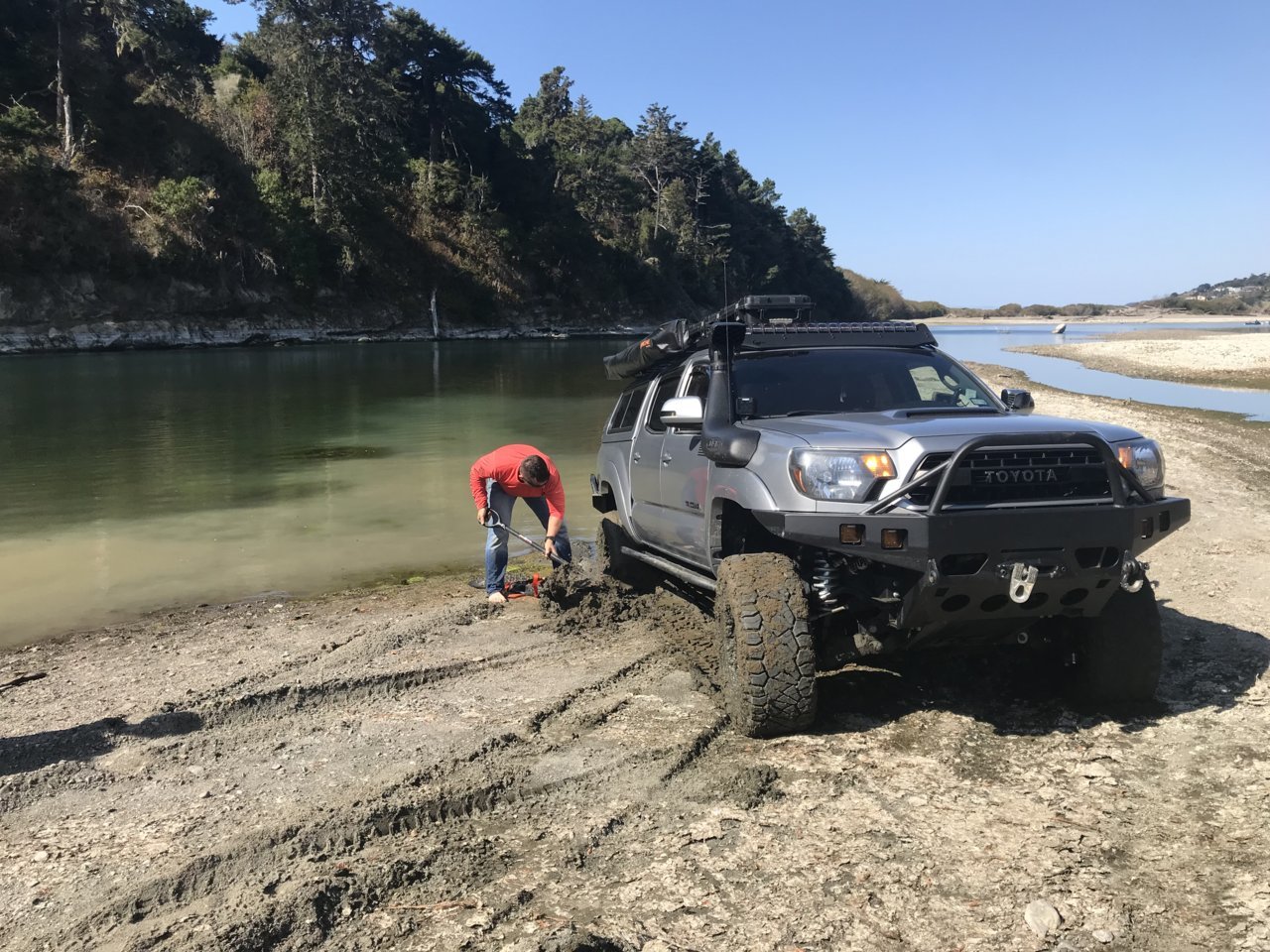

    Headed out that morning down the 1. Few hours of highway road got me a little dirt road sick and I wanted to take a short detour which ended up taking a few too many hours...stuck.
    luckily there was someone there to help pull us out!

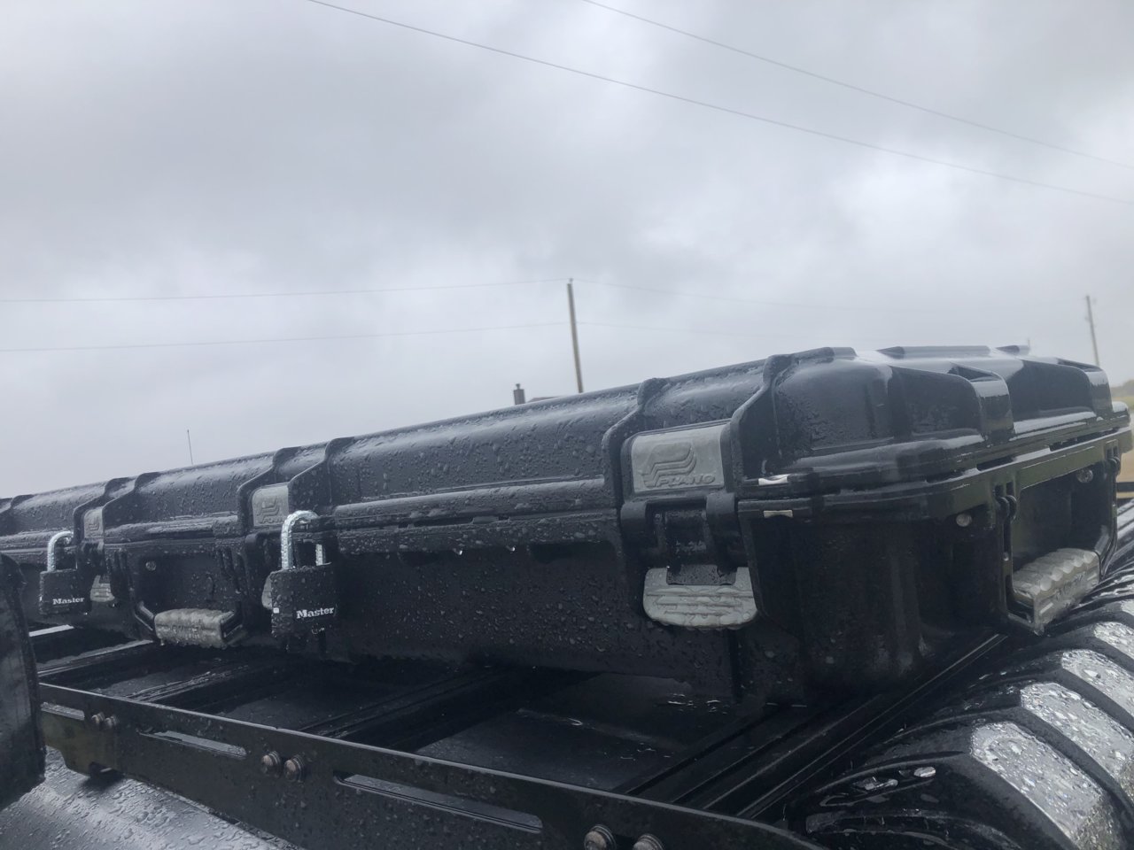

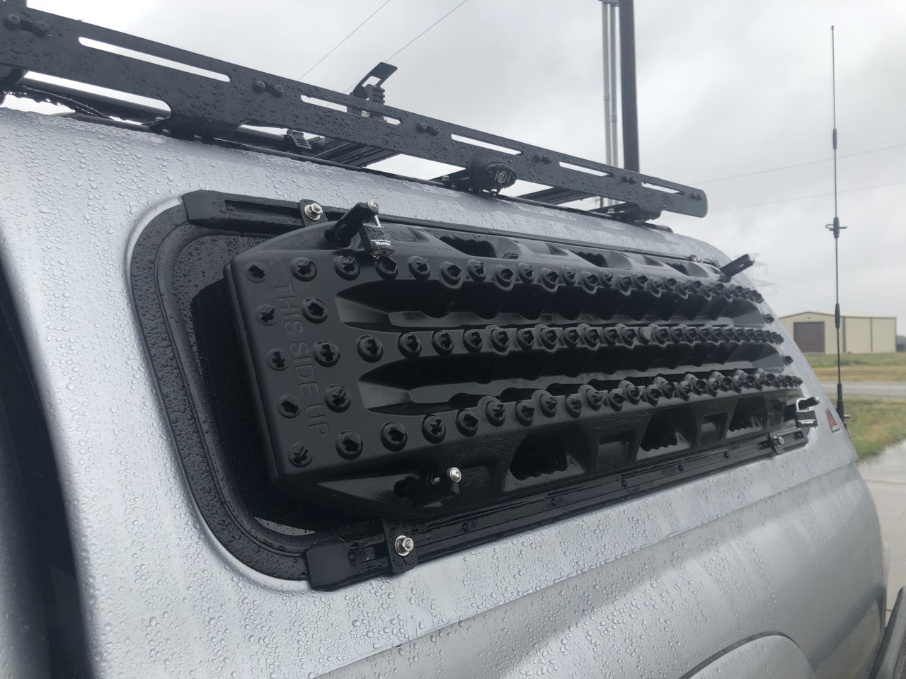

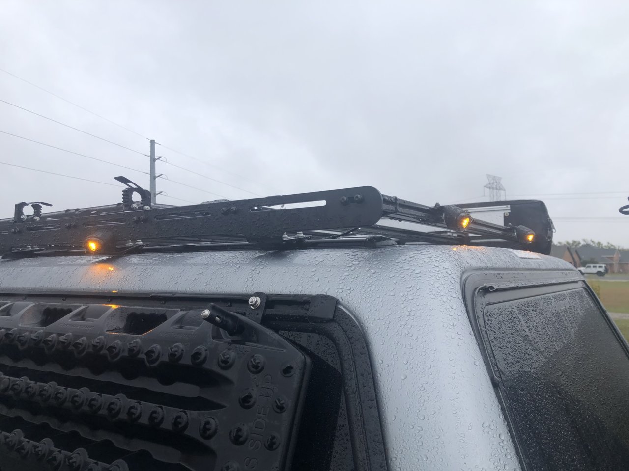

    few things I did prior to the road trip I didn’t post.
    Mounted the max traxx to the Thule tacks I installed a while back

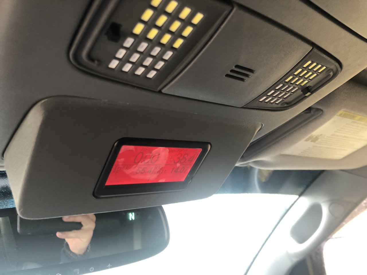

    Ultra gauge in a mesocustoms overhead mount to tack fuel mileage and various other stats while on the road. Not sure how I achieved 30+mpg average :notsure:
    Mapped out the route on the Garmin overlander and mounted for easy access
    Paired with the wireless rear view cam since I’ve blocked my OEM can now.

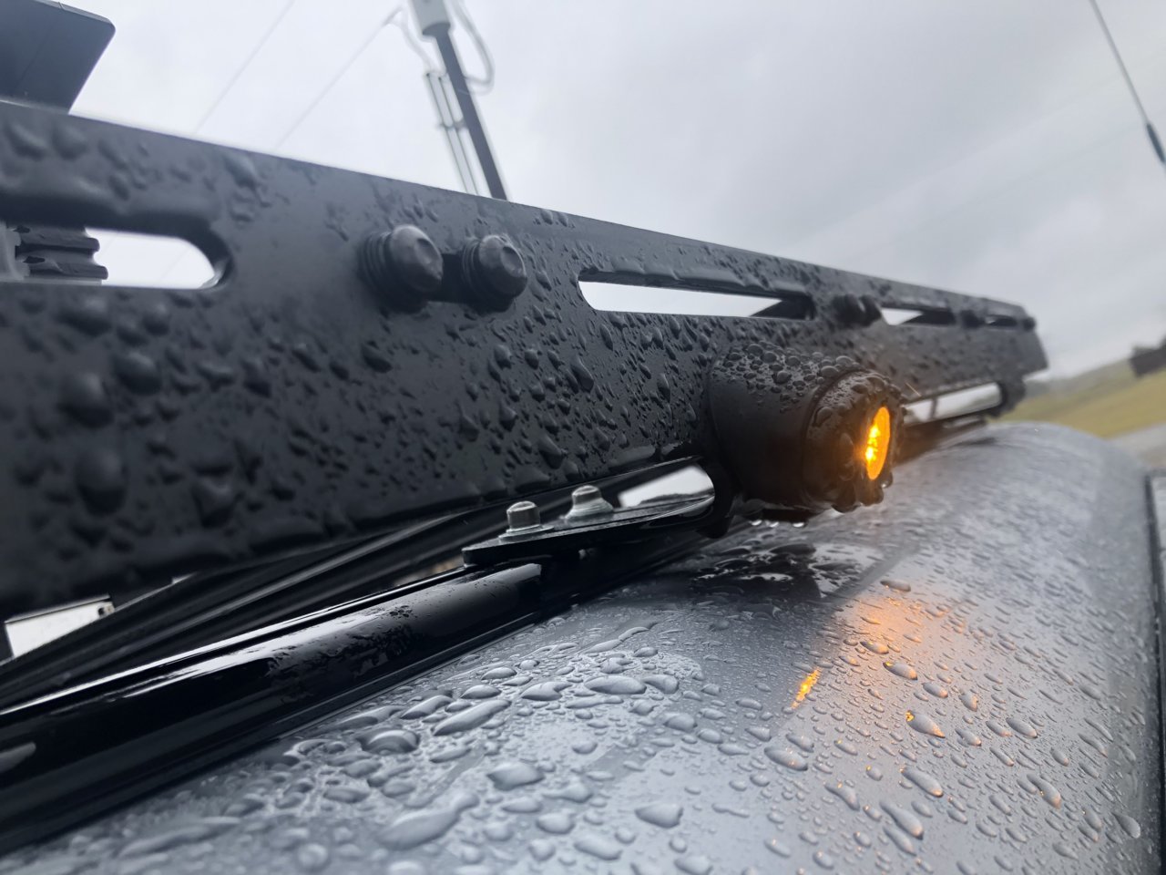

    Camp lights installed I used some rigid amber rock lights. Rigid came in clutch with these thick angle mounts worked perfect for what I wanted!
    Added some rago rock light mounts in combo with the rigid angle base for the rear
    Exhaust chopped
    Plano recovery gear case installed

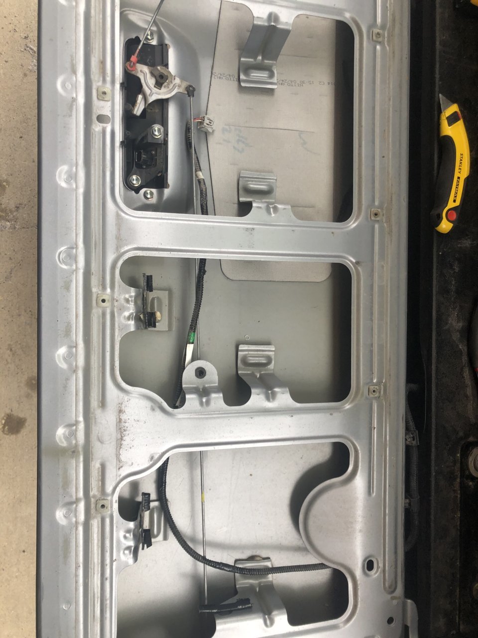

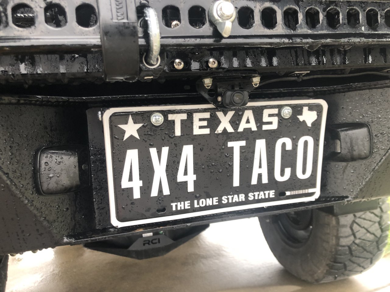

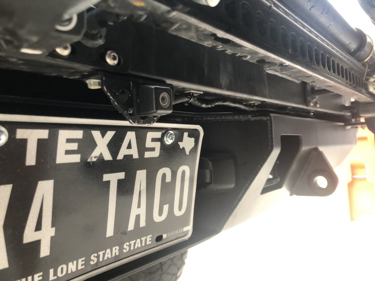

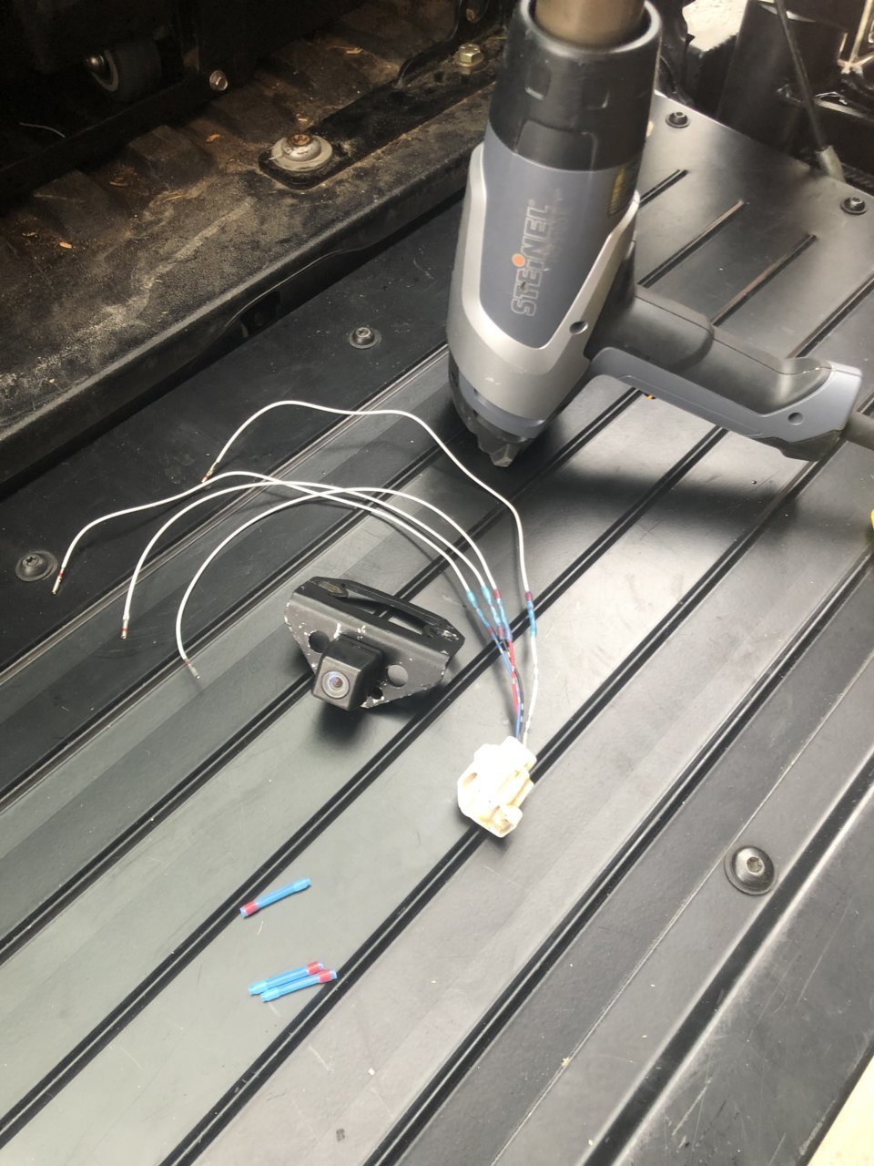

    I missed my anytime rear cam button dearly so I swapped the wireless Garmin cam for the OEM one.
    Super easy mod.
    pull off tailgate skid
    unroute wire harness
    Remove and remount camera, I also had to extend the harness a tad to reach the mount point I wanted on the swing out
    Fin
    now I’ll use the wireless one for a front mount cam to see upcoming obstacles on the trail

    How exactly did you extend your factory rear camera? Was that angled bracket the one that came out of the stock tailgate latch area? Looking at getting a rear bumper and don't want to not have my rear camera be blocked so I'll have to relocate it as well. Did you just add more wire length to the existing wires to extend it?
  8. Oct 30, 2019 at 8:40 PM
    #248
    OverlAnderson
    OverlAnderson [OP] A dude playing a dude disguised as another dude
    Sep 23, 2017
    #230862
    2,126
    Anderson
    San Antonio, Tx
    14 TRDS DCSB 4X4
    stuff and things
    So I left the bracket in the Tailgate and up drilled the center hole with a step bit in a Rago rock light mount I had laying around. For the harness extension I just took some regular r7 20AWG wire and spliced it in close to the large connector under the truck.

    Awesome thanks!

    It was pretty easy the only reason I had to add length was because I was adding it on the swing out and it had to be mounted where it closes over the top of the license plate

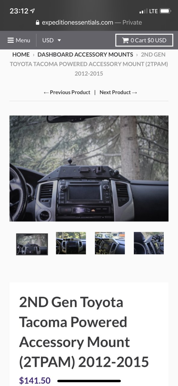

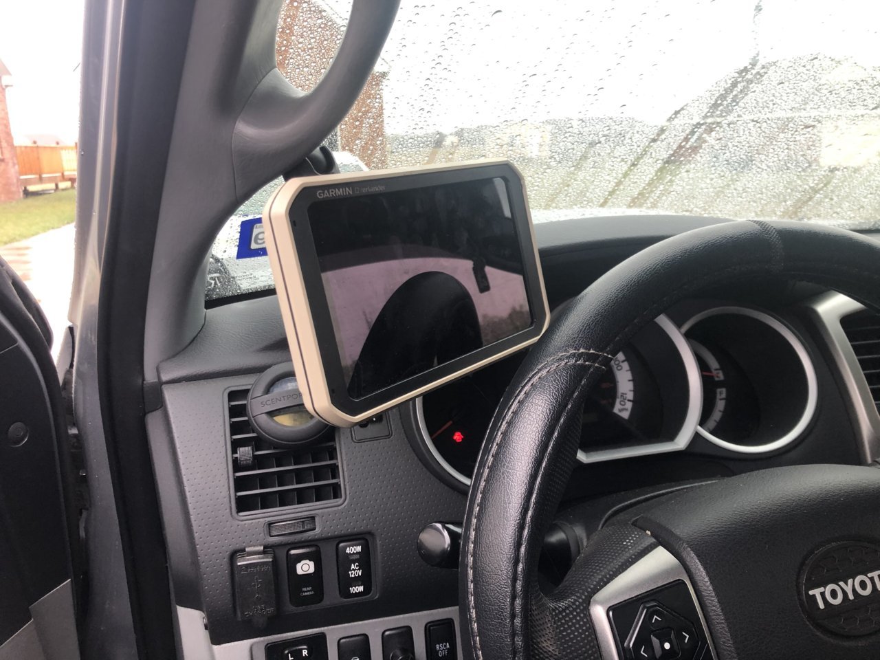

    To TPAM or not to TPAM?
    BassAckwards likes this.
  14. Oct 30, 2019 at 9:16 PM
    #254
    2012TacomaGuy
    2012TacomaGuy Well-Known Member
    Jun 28, 2016
    #190747
    741
    Hayden
    Goodyear AZ
    2012 Pyrite Mica DCSB TRD Sport
    Empty wallet
    I've been thinking out getting one of those... Right now I have a cup holder mount for my tablet that I use to track off roading trails, but it gets in the way. I figured this i can mount my cb radio, phone, and tablet in one plate where my knee doesn't hit it
    Edit: added photo

    Tech Deck works for me!

    It does me too..... but more mounting solutions!!!!
    :goingcrazy:
  17. Oct 30, 2019 at 9:22 PM
    #257

    And additional power ports.

    I want one really badly, but they don’t make them for 05-11 sadly. I say go for it, they look good and serve a good purpose

    No issues with the video quality after the splice job?
    I am not a huge fan of where the OEM backup camera wound up on my rear swingout. Just not all that good for much.
