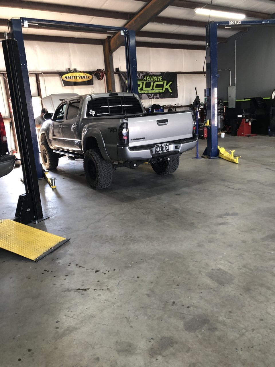

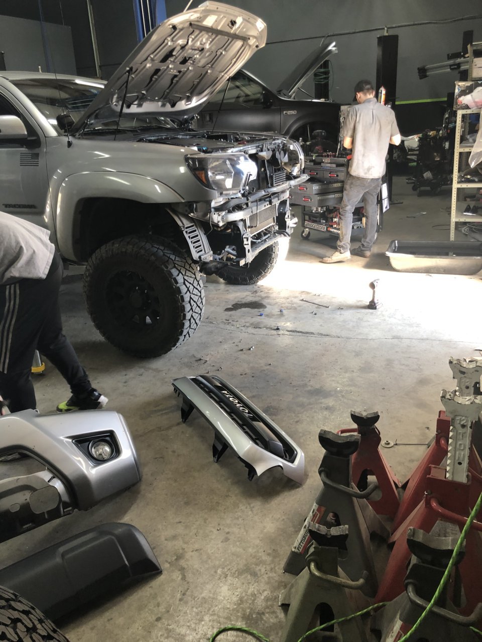

    Trucks in the shop today....
    Getting that nose job

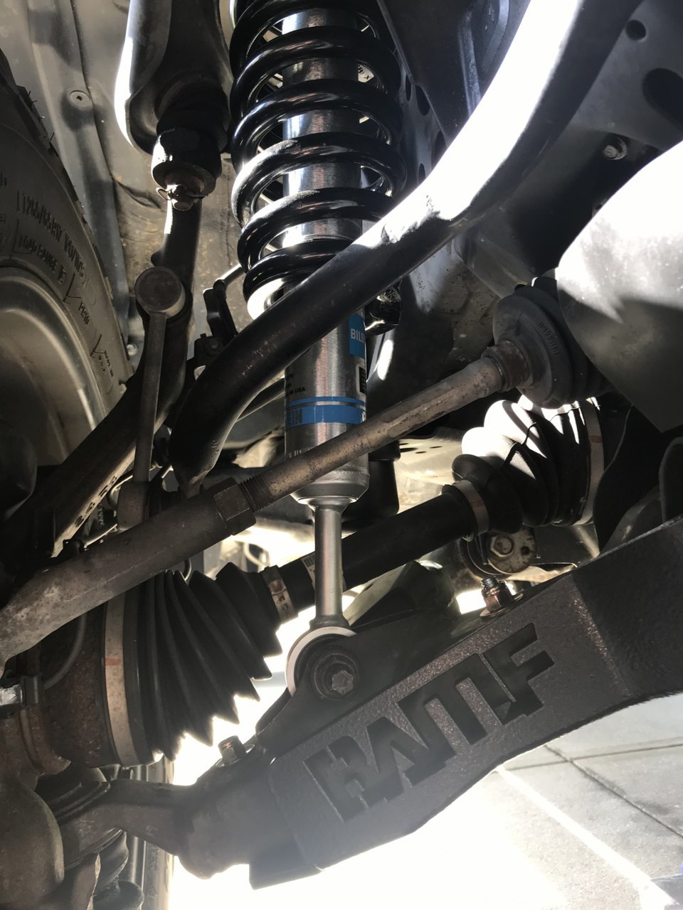

    I installed the BAMF LCA armor and it looks great. Was pressed for time so no background painting of the LCA. I'm not cool.

    Hey Glen you got pics of your LCA install results?

    With the truck on jacks stands and still has the sway bars installed (soon to be gone as they interfere with the coils and I want full articulation off road). I got the armor with the powder coating done already. Looks pretty good and should withstand Florida salt for longer.

    How close does it look like coming in contact with the frame?

    Not even close. The sway bar is definitely in the way though and will be removed ASAP!

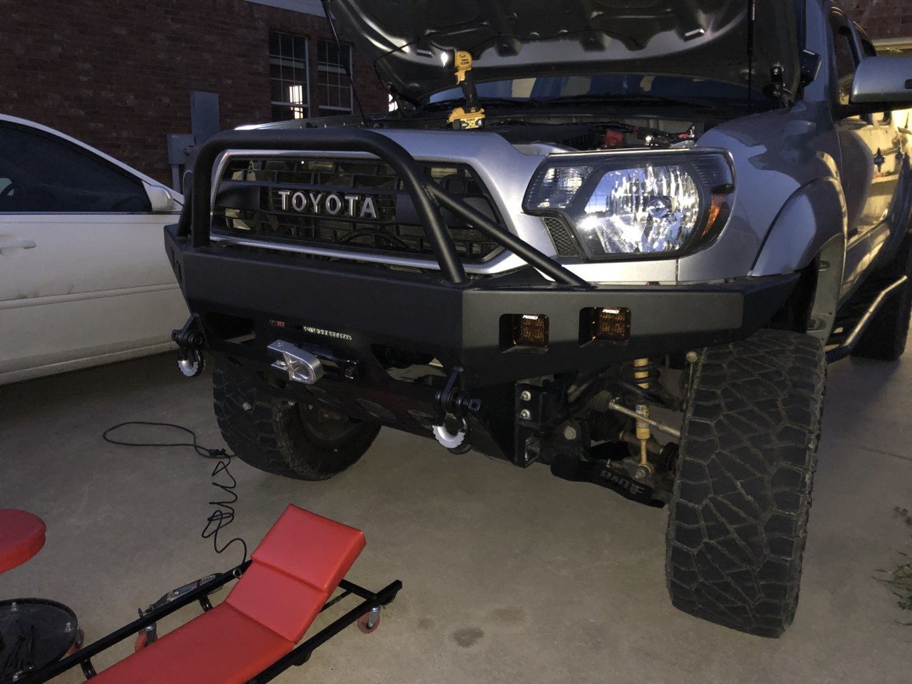

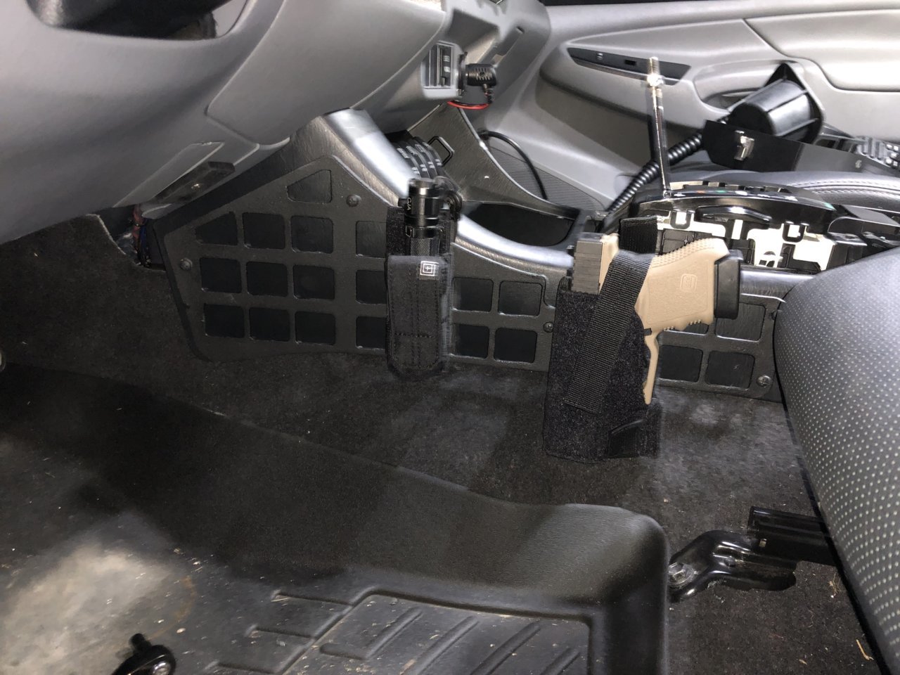

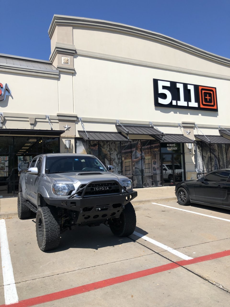

    ‘‘Twas a busy day
    5.11 stop to grab some MOLLE pouches after bumper install
    Threw in the SAE fogs and the flat link E for the winch
    And topped it off with the OG fab MOLLE panel for some pistola stowage and the tacticool flashlight

    What do you have going on under the driver's seat?
  14. Mar 26, 2019 at 9:12 AM
    #114
    OverlAnderson
    OverlAnderson [OP] A dude playing a dude disguised as another dude
    Sep 23, 2017
    #230862
    2,126
    Anderson
    San Antonio, Tx
    14 TRDS DCSB 4X4
    stuff and things
    That’s my amp for my sub behind the back seat

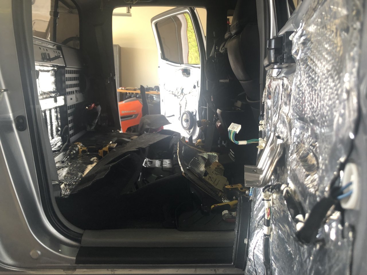

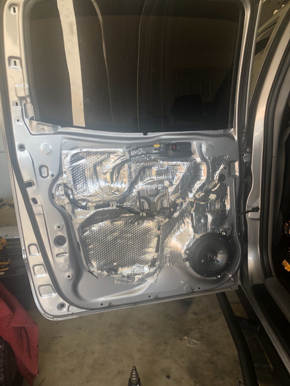

    Sound deaden/speaker upgrade
    80mil Noico+1/4”vibro on the back wall and Noico +3m insulation makes the cab bass sound goooood! Zero rattles!!
    Gonna leave the 40% out for the goose gear platform inbound
