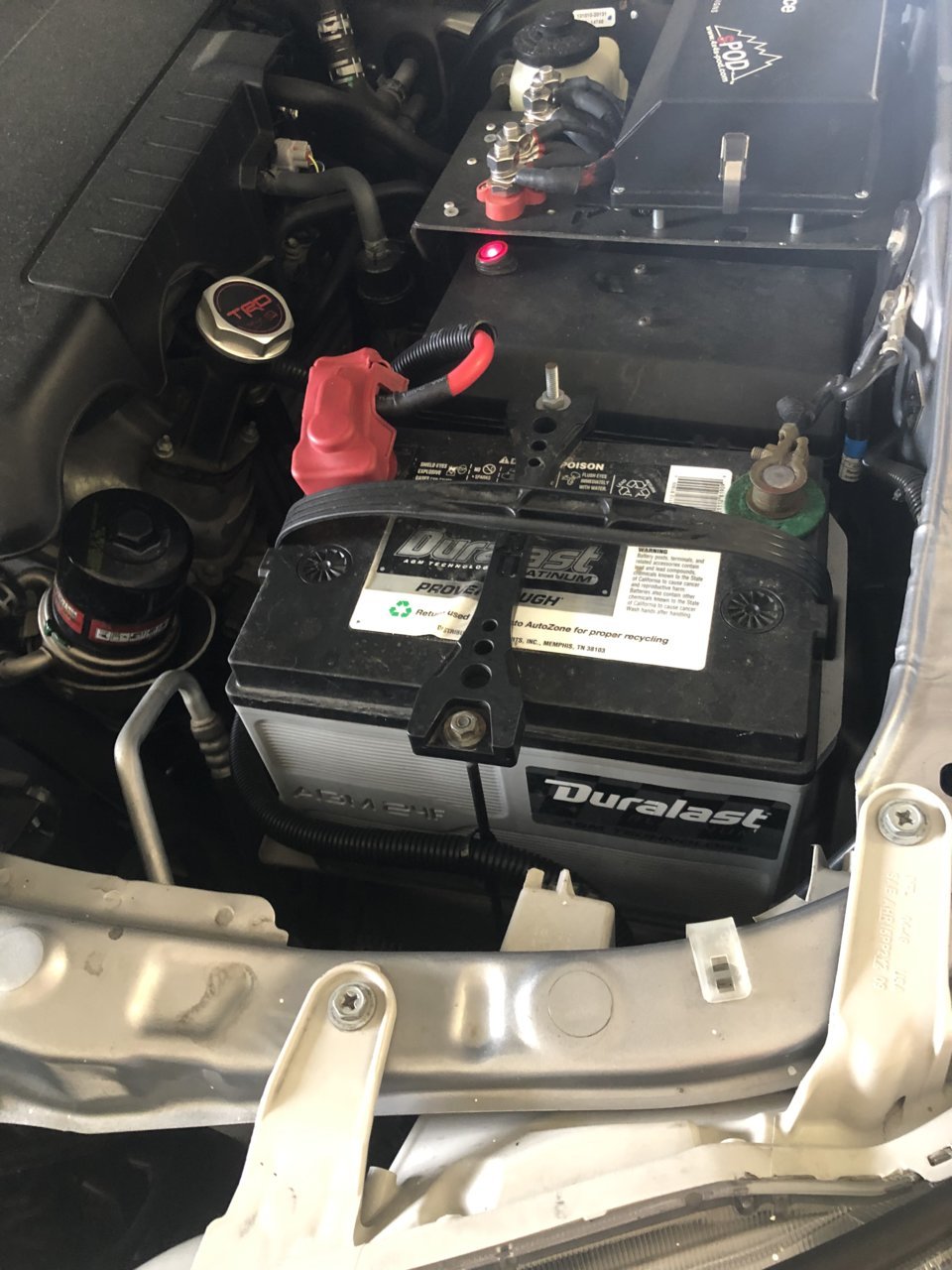

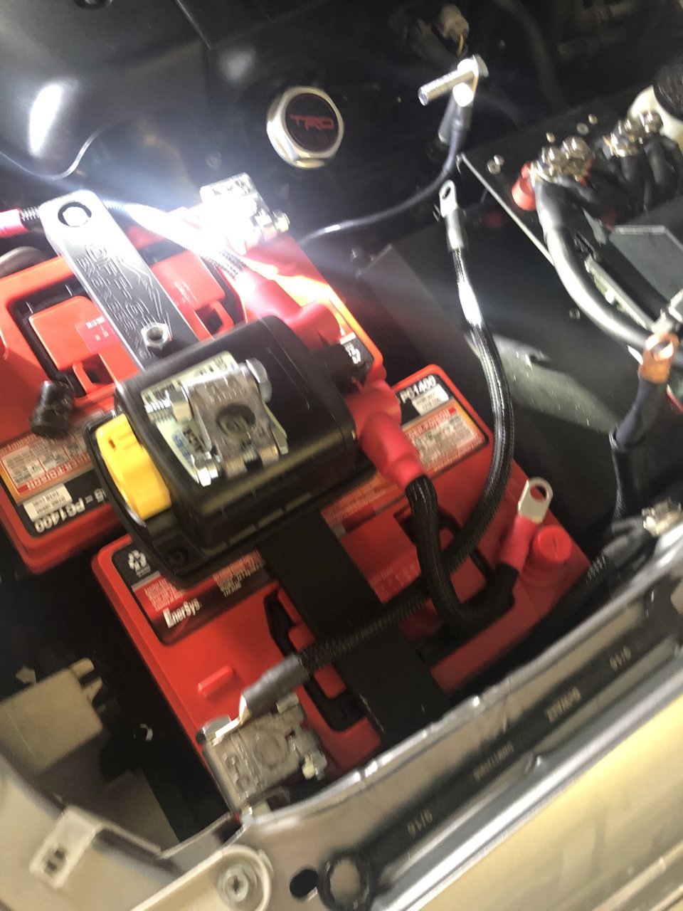

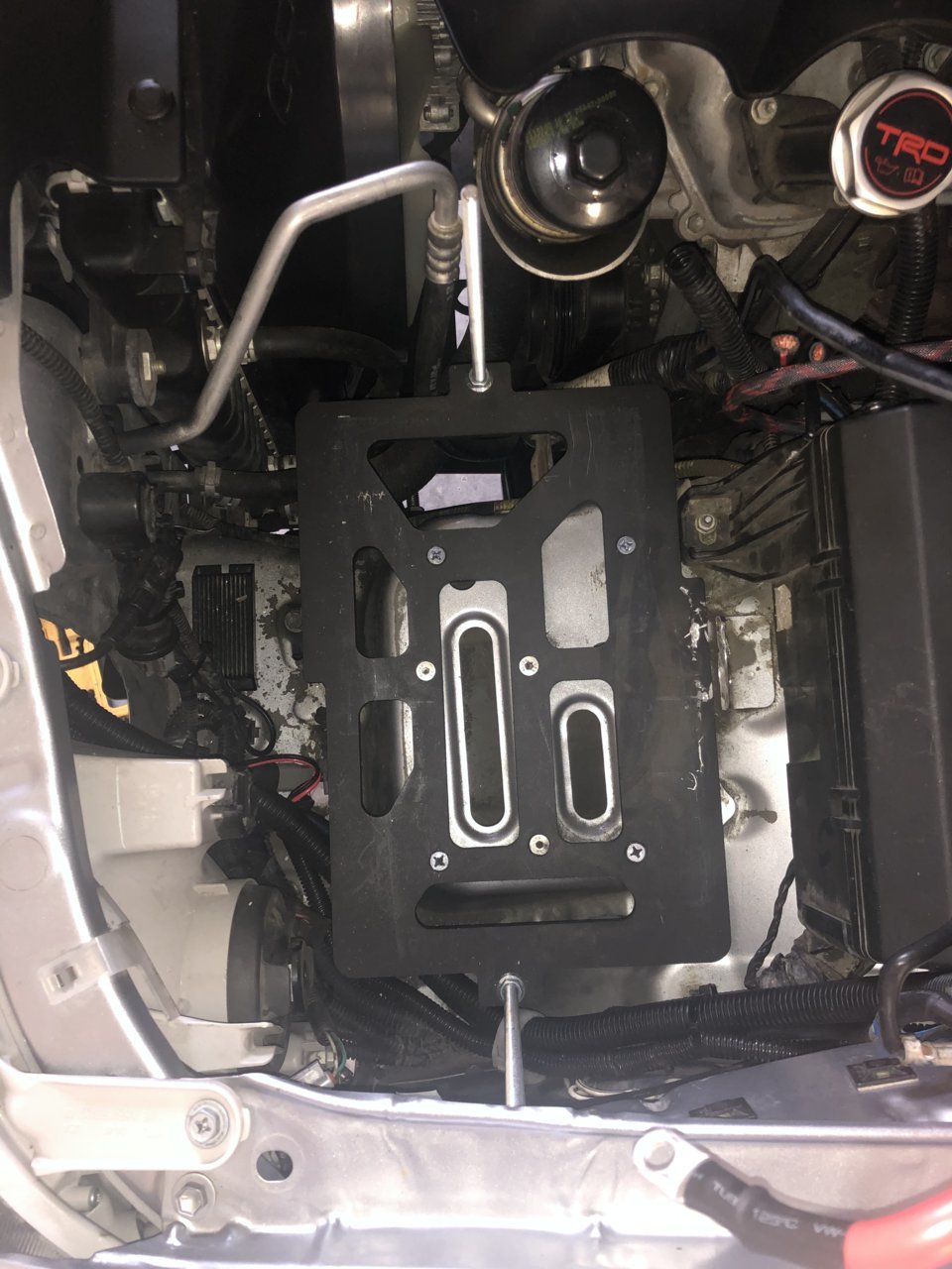

    OGE

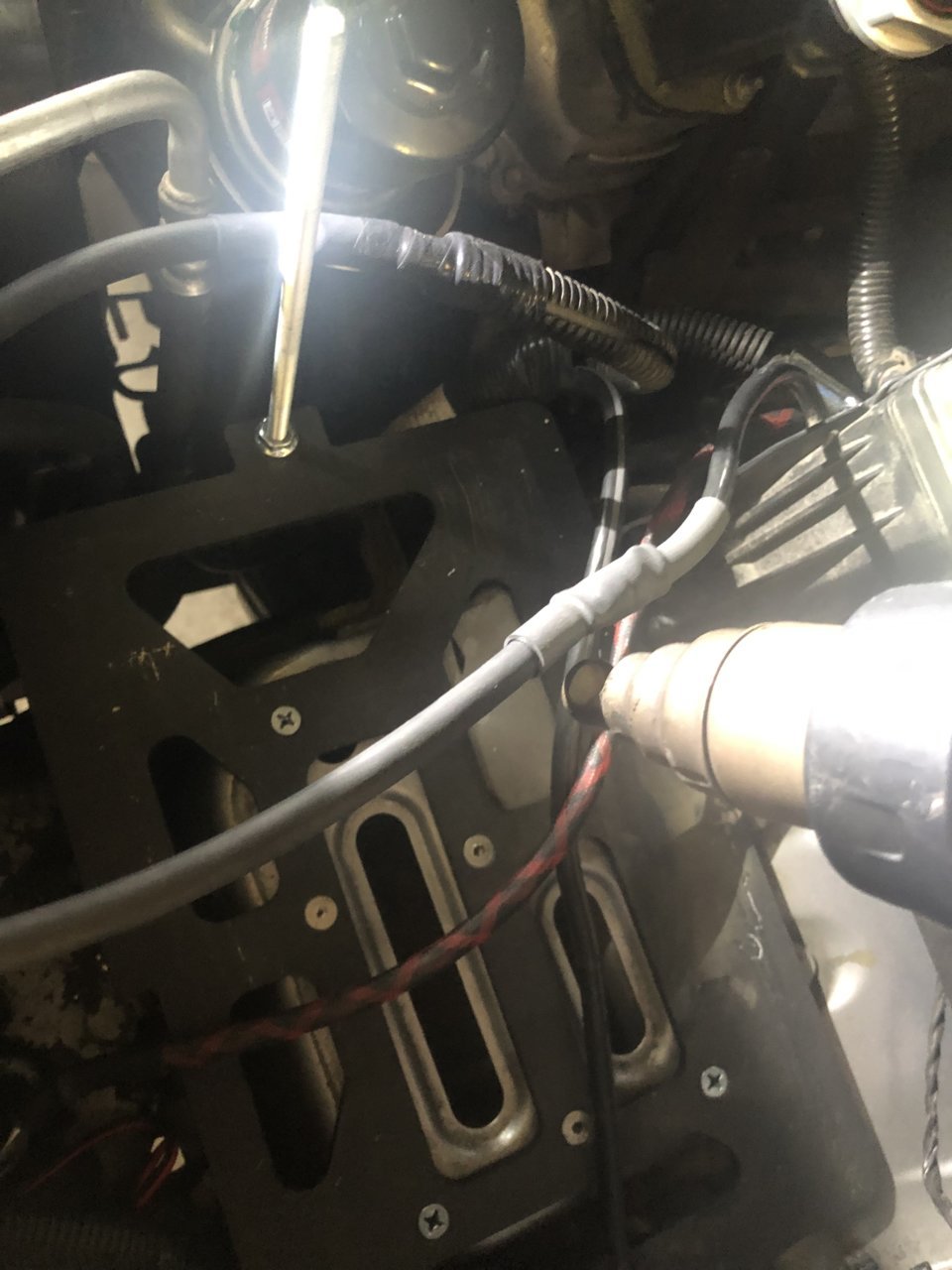

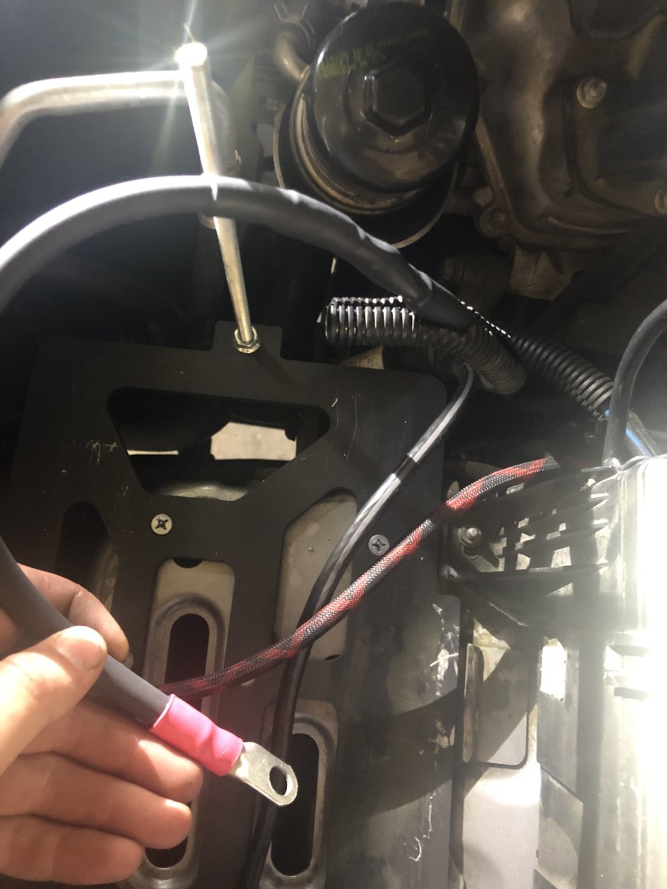

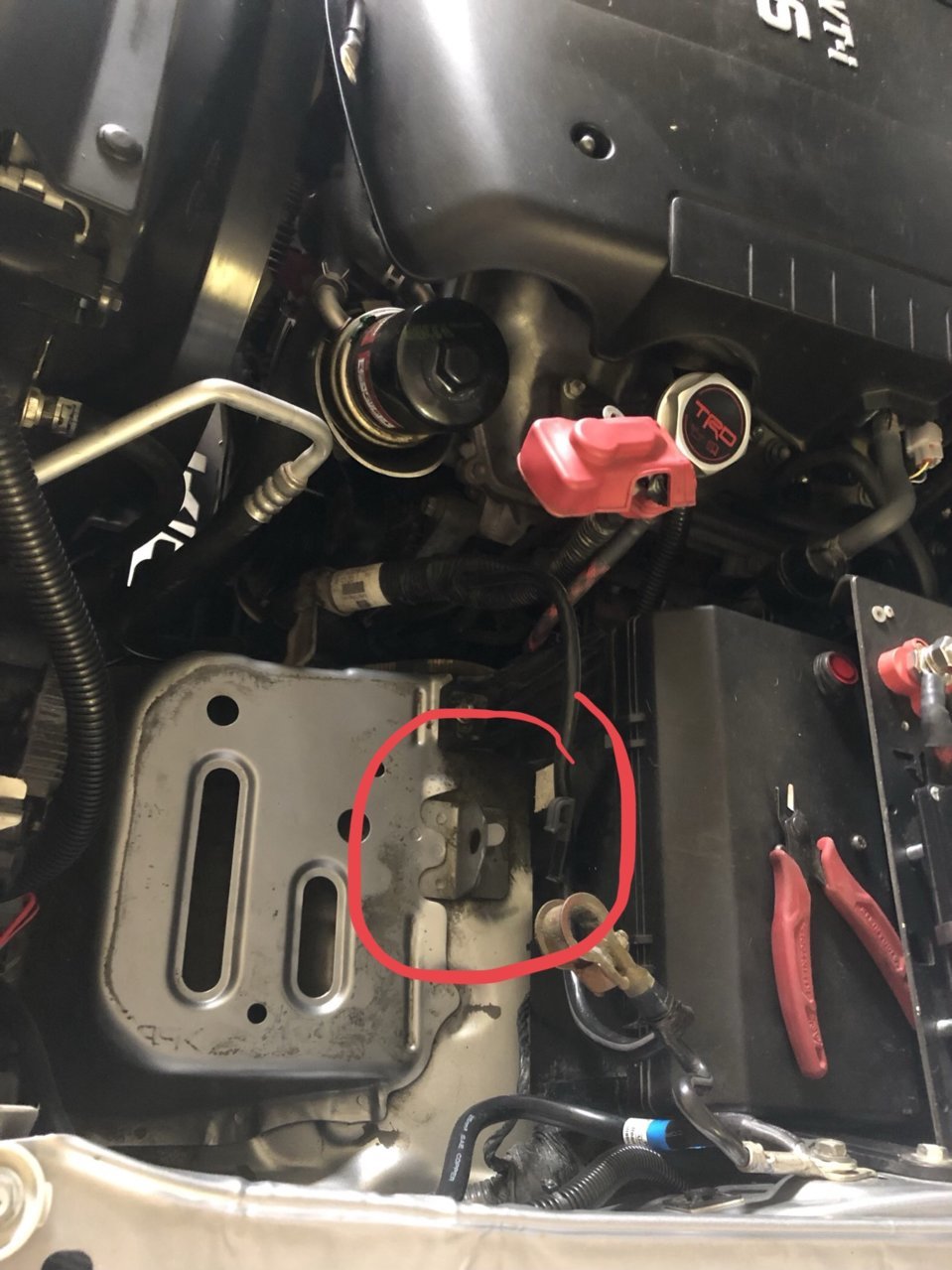

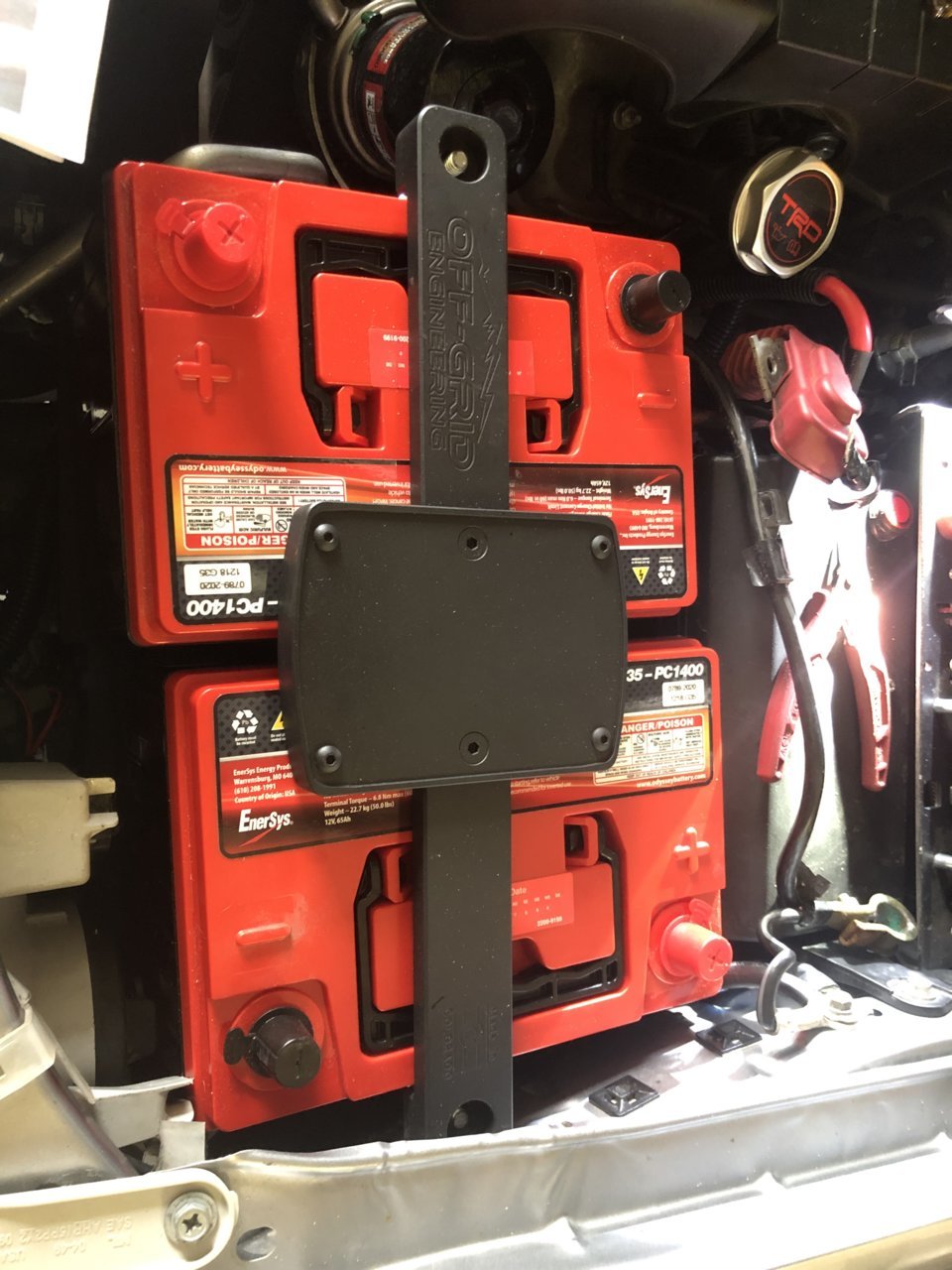

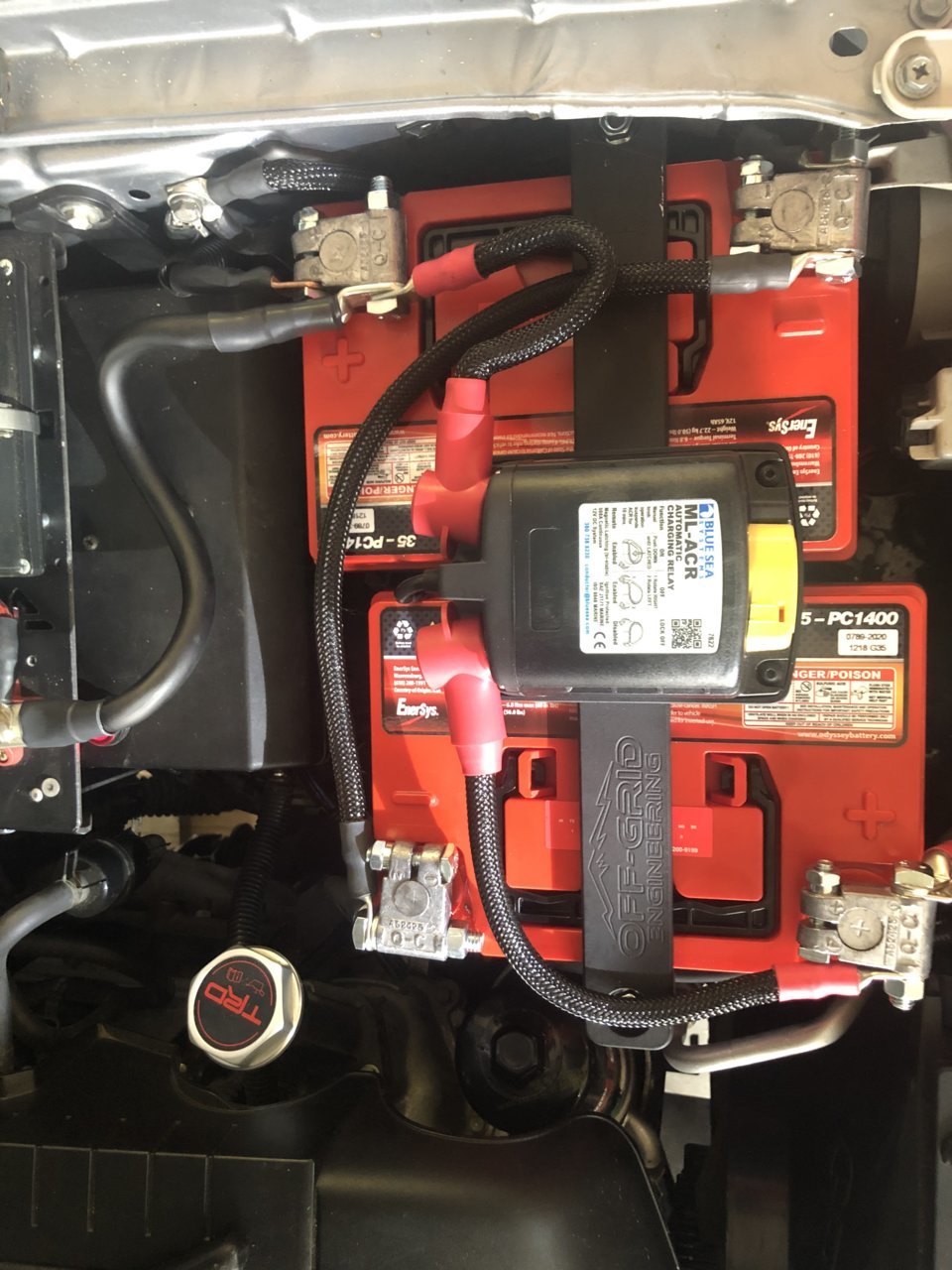

    Side by side Dual battery install:
    Remove old battery and plastic battery tray.
    I then ground off the old mounting bracket. Although it is not needed for the install I did it for a better fit of the batteries since I have VLED headlight bulbs that sick out of the housing a bit.
    Install the bottom platform using the provided hardware. Start with the OEM hole that lines up and you’ll have to drill out the remaining 2 for the Allen screws. Secure with the remaining countersunk screws and add the all thread tie down mounts.
    Place the batteries in to get an idea of how long you’ll need the power extensions. Run the starter power to the front side of the inner(main) battery. Cut your lengths and remove batteries. Set aside.03C507D2-2B8F-4726-84FF-68D4CA23FC21.jpg
    I used an extra layer of heat shrink over the splice
    Once you have your wires terminated and ran out of the way you can reinstall the batteries and get ready for hookup to the mil-spec terminals. I first attached the relay and hooked up the positive wires to the relay. Then I placed my battery tie-down over the all thread posts and secured the batteries. Leaving the post caps on I installed the terminals. I started with the ground/negative posts.
    All completed everything works great!

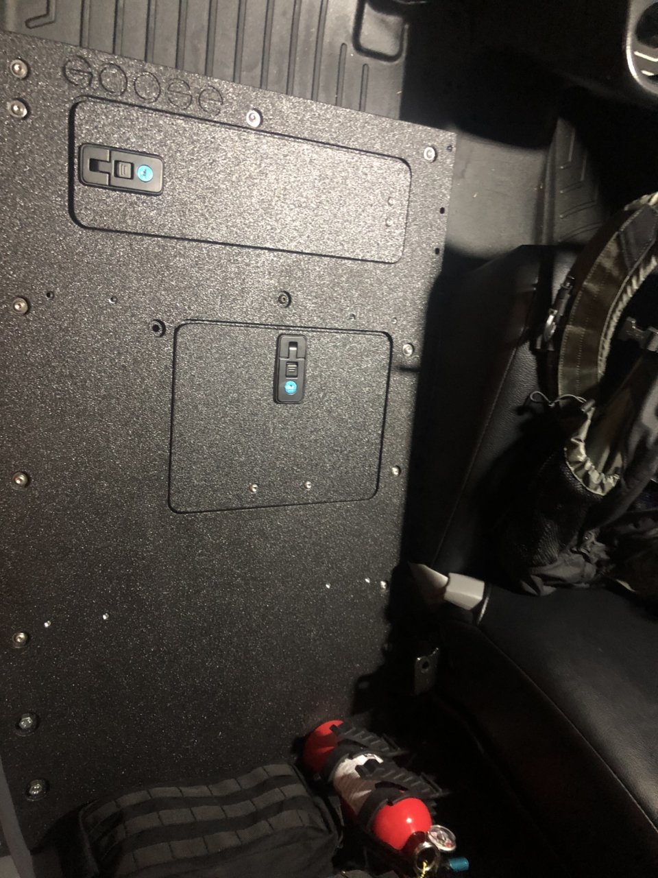

    Goosegear platform installed
  19. May 21, 2019 at 7:04 AM
    #159
    MattCowsmasher
    MattCowsmasher ( -_・)ᡕᠵ᠊ᡃ່࡚ࠢ࠘⸝່ࠡࠣ᠊߯᠆ࠣ࠘ᡁࠣ࠘᠊᠊ࠢ࠘
    Apr 7, 2017
    #215629
    48,694
    Temple, Tx
    O3 Rubicon wrangler
    That’s pretty slick I like it a lot.

    stuff and things
    The quality is top notch! It’s a super easy install I highly recommend it! Thinking about getting a fridge to mount to it now
