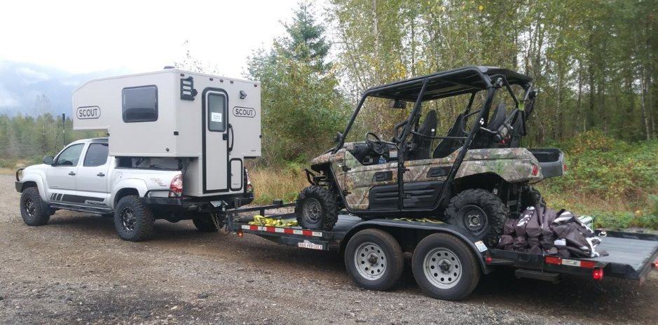

    I'm only running 32s, but 33s would fit fine with a CMC if I went that route. I'm running far heavier than she's talking about and am only running the below. The Deavers/5160s/tires are estimates on what they'd cost to buy today (as I paid less a few years ago for them). The Bilstein 6112s are about a year old, and can still be found for similar pricing.
    Deaver U402 Stage 3 - $1150
    Bilstein 5160s - $600
    Bilstein 6112s - $1,114
    5x E-Load Duratracs - $1,700
    This all adds up to $4,564. That's nowhere near $10k. Install would be extra, as the suspension was installed in my friends garage,but tires include estimate for install.
    I'm not a proponent of going as stupid heavy as I am, but I have had no issue running like this for 10s of thousands of miles, and a large portion of those is towing 4500 pounds behind my Taco. I don't do any extreme wheeling with the camper loaded, or at least what I'd consider extreme. I still flex the truck out. No upper control arms have been needed, but could be to get proper alignment and fit for 33s. With all this weight I also paid to have my truck re-geared, but if not towing, the truck would do fine. Re-gear was about $3500, and that still doesn't get to your $10K estimate. And I'm not trying to argue with you, just saying that all the items you listed aren't absolutely necessary to haul around 1 or 2 thousand pounds reliably. They're all great ideas and great upgrades. And note I said reliably back there, I'll never say SAFE, as running past payload is never a great idea. Wife and I hope to have an F450 next year to takeover camper and towing duties, and the Taco can go back to being an offroad toy again. But over 100 nights in the camper in the past 3 years, and many miles on it. AT Habitat before it, that really wasn't THAT much lighter, lol.
    The below is without the 800 pound ATV in front of the SxS that I've towed from Seattle to Vegas and back with a stop in Utah in between.
