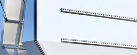

    :rofl:
    Extra holes drilled because #fuckup

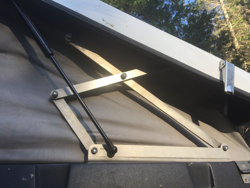

    Out of curiosity, any reason in particular that you chose a hinge on the front of the pop up vs going with something more like the VW camper style? It'd give you a lot more foot room without needing the roof to stick up five feet. Ok, that's an exaggeration, doesn't look quite that high, but it does look high enough that I'd be worried about setting up in a strong wind.

    We went with the hinge style because of simplicity. @Iggy actually made a beefy westfalia style hinge, but it was wide and would have made the bed area narrower. Or we would have had to widen the top about 4 to 6" to keep the same bed height. The room in the foot area is fine. It was a concern of mine (size 13 feet), but my feet are fine since I'm a side sleeper. As far as stability in the wind, I'm not really concerned. After having a Flippac and 4wc, this design seems more stable. Probably less flapping than the Flippac and about the same as the 4wc. We also plan to add a support bar for added peace of mind, but right now I have to almost hang from the lid to get it back down.

    The extruded hinge works great. Advantage of the Westfalia top is that you can make it really low profile. The compromise is width and lower profile for bedding. I can keep a 4" mattress and all the bedding up top since the overhang and roof have a thicker profile. Really no issues with foot room. At all. This is a 72" Thermarest. I can scoot back if my feet are cramped with the thicker mattress, but I'm a side sleeper and it's not an issue. At the end of the extension, the height is 48". 36" height at the end of the carpet.
    I checked out an Ursa Minor JK setup a few weeks ago. Roof was roughly the same width, but the bed was really narrow.
    The kids will sleep down below, but sometimes will end up with us up top. It's tight, but it would be impossible if the bed was 4 - 6" narrower. Widening the top, to accommodate Westfalia hinges, wasn't good either since we wheel in the tight trees. It was a challenge with the 4wc that is not an issue with this setup.
    Lastly, there is some lateral movement with the Westfalia hinges. Almost none with the 52" extruded hinge.
    Edit: As far as roof storage, the struts are more than enough to support the weight. There is aircraft track on the roof for a future rack. I will not have to remove anything from the roof to popup the camper. Running 150 lbs. struts now, but may switch to 250 lbs units (sitting in my garage courtesy of @Iggy ) to haul a canoe or cargo. It takes about 3 minutes to switch the struts.

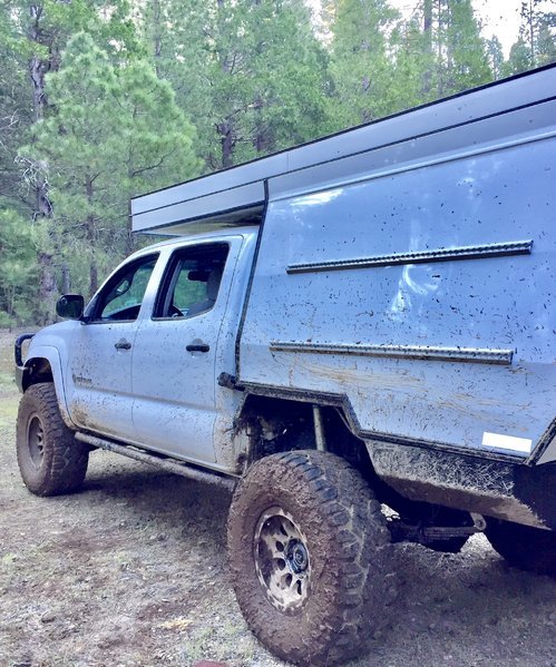

    I can't quite tell from the pics, do you know how they attached your L-track? Like with rivnuts drilled from the outside or bolts going all the way through the frame tubing?
    They said the track isn't something they stocked in-house normally and since I'm not local to bring it to them we agreed on just putting some additional tubing running length-wise within the roof and I'll bolt the track on myself later. Rivnuts seem like the way to go, but I haven't worked with them before, so not sure if they can be relied on for a critical task like holding a roof rack on.

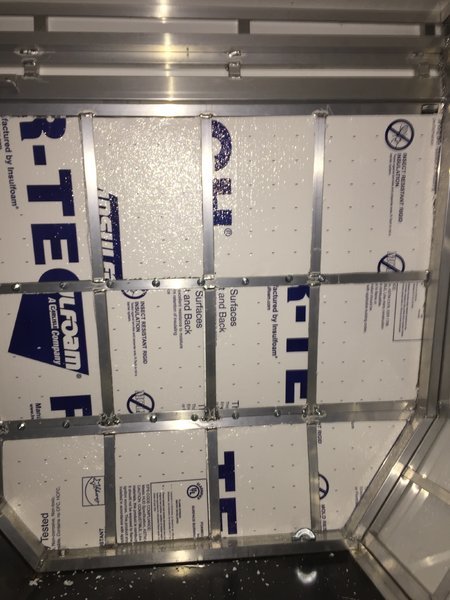

    They are drilled through. Here's a pic:
    Cabinets will cover up the bolt heads, but T-nuts might be a better solution. Rivnuts will work too, but aren't as strong. Probably good enough for traction boards. I am debating putting Rotopax containers on the side though and want the strength. It will make putting panels in a challenge.
    So, you have an order placed? Did you order with the fabric? Just wondering because the fabric solution is not fully figured out yet. @Iggy and I met with them last week and it's very close. Basically, @Iggy got it figured out with a little input from me. My fabric will be in within the next week or so and they will hopefully have a clear path forward.

    Thanks for the info. Bolts all the way through seem like the best bet, I don't want to be worrying about whether the rivnuts will fail and drop my kayak on the highway.
    I placed an order last week, no fabric. I wanted to customize the dimensions a bit, so I figured it wouldn't fit if they are planning to mass produce or outsource a standard size for the fabric. But, if they are developing the in-house capability to make the fabric, maybe they could add it to my build before it ships. I'm not counting on that though, I've talked to a couple shops here in Seattle that handle boat covers, awnings, and sails etc and it sounds like I can get them to sew the fabric for me. Also have an idea for making the fabric in 2 parts joined with either a zipper or awning track so it's easy to put on/take off and not quite such a large and hard to work with single piece of material.
    Thanks for all the ground work you guys did with the basic design.
